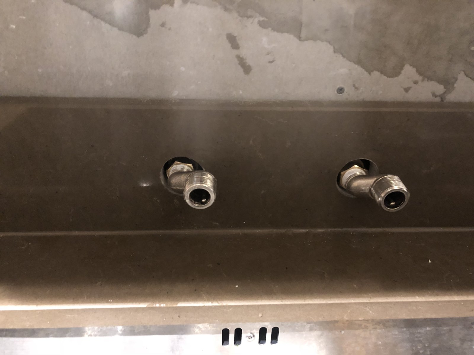

I am trying to install the dog legs so that the tap will be right in the middle of the sink but when I tighten them they always finish to the right as the image above. Do you know how I can get them to finish in a different position once tightened?
Don't use them. If the holes are centered to the sink then you want to use different fittings. 15mm (1/2") x 3/4" male nipple/adapter.
TBH .... I would have set that up a different way so there were 2 pipe tails coming through so you could fit better fittings to them.
