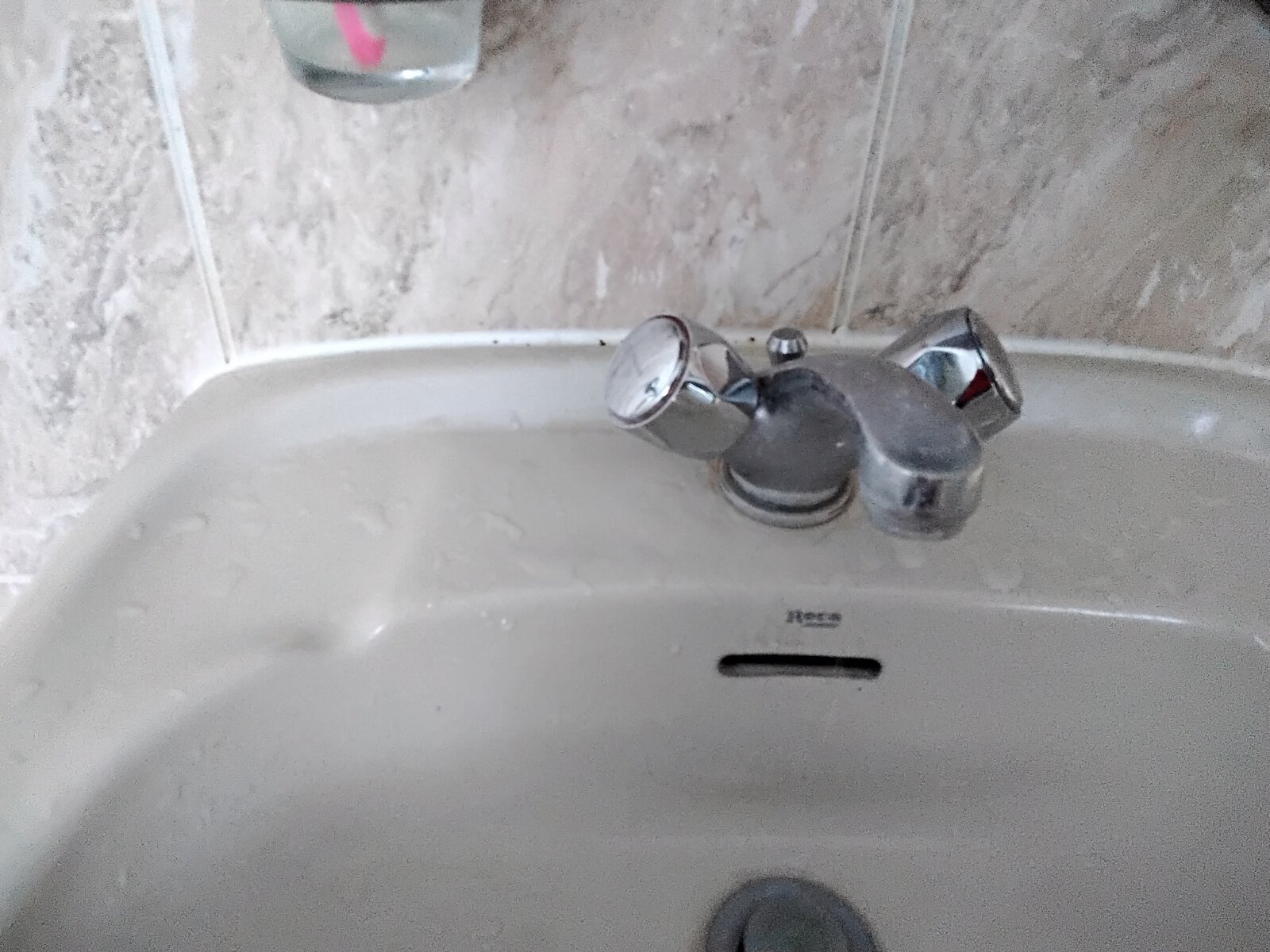

Basin tap in bathroom is leaking causing bickering in calm house kindly help
To identify the size so I can attend to it this is the only rubber washer tap
In house thanking in advance

They will be 1/2 inch washers.There are two types,flat and domed.Most are flat.
Remove the flat cap on the top and you will find a screw underneath.After that you will need a spanner.

Many thanks this bathroom is fed from loft cws tank will revival kit cause pressure issue as there is low pressure??
No - those valves are the compression screw down type - they are designed to be used with full flow taps that should be used on a gravity water supply. The 1/4 turn ceramic type valves are the ones that could cause flow issues on a gravity fed system.
