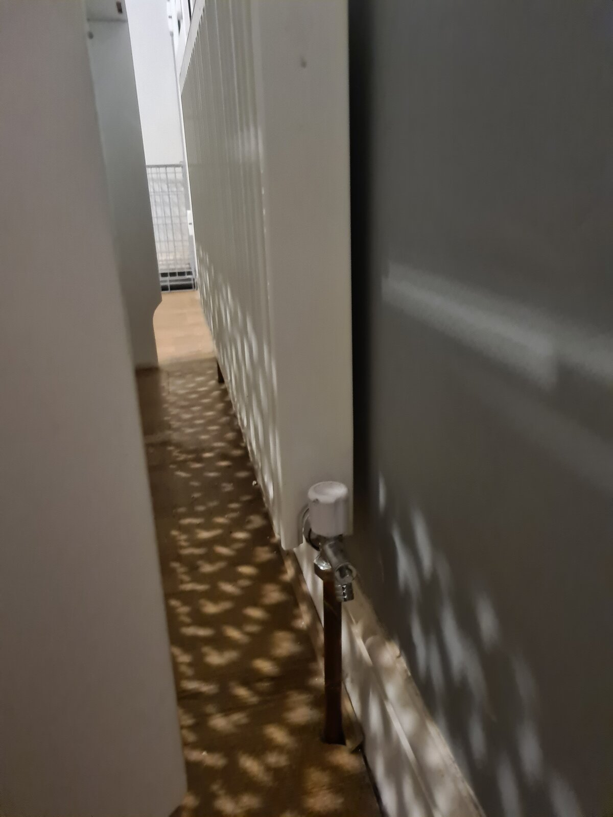

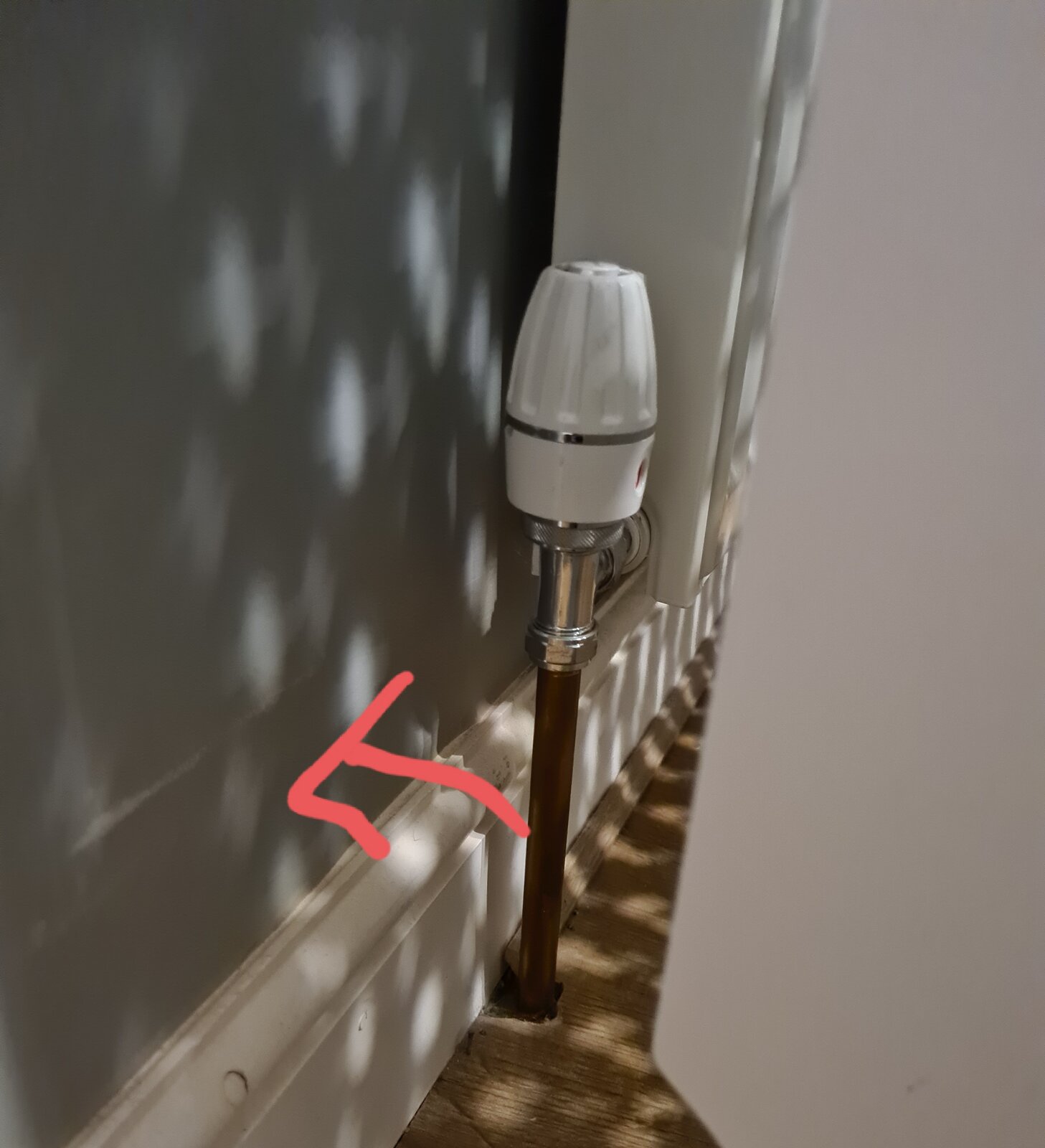

Quick question is there enough space here to tee in and send pipes through to other room for a radiator to be fitted
Not too fussed about surface mounted pipe on skirting board etc as easier than taking laminate up.

Depends whether you want to go through the skirting board. If not, you may have to raise the rad up a few inches. That’s my unprofessional view. :whistle:
There looks as if there is space enough to fit a soldered T at each end, below the valve yet passing the extra pipe through the wall directly behind and above the skirting. You will need to mark it for cutting carefully, plus move the pipes to one side whilst you drill the holes(SDS) directly behind the present pipes. The holes need to be 25mm, to allow a 22mm pipe to be used to sleeve the hole for the 15mm.

Why on earth would you not tee off under the floor, what are the floors like in each room). In my opinion I’d suggest going under the floor as it will look a lot neater (I have a feeling most plumbers you call in will suggest that also) unless one of your floors is a no go such as concrete or tiles etc.
The thing was, the OP suggested he had laminate he didn't want to disturb.
Solid concrere floor on other side of the room, so ideally not possible to go under and save ripping up all the laminate in the kitchen side.
Cheers :)
I'd take the skirting off, unless you have up/down play on the existing tails to the rad... You'll never get the T in and be able to solder the centre port that goes through the wall... At very least, without scorching the skirting board! You don't need sleeves either.
