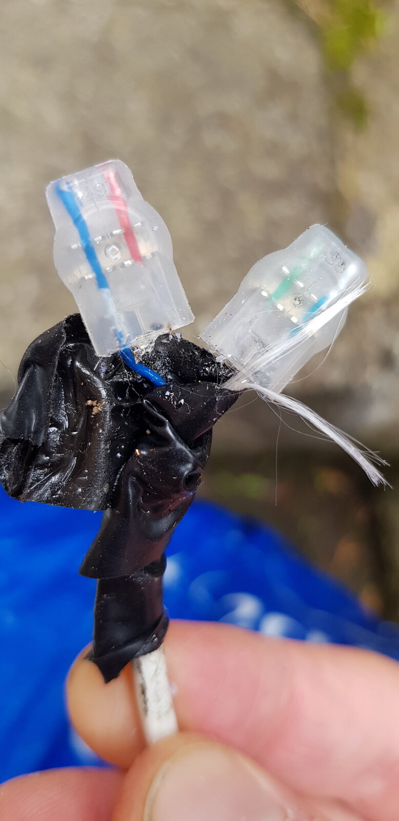

I recently had some new carpet fitted and during the work the fitter accidentally severed the internal phone wiring. It's a Virgin Media 'fibre' phone line so I was able to reconnect a phone directly to the router but obviously the extensions no longer worked.
I got some new cable to replace the damaged wiring but I could not get a dial tone. I triple checked everything to ensure there was a good connection and that the wires were connected to the correct terminals. I tried wiring each socket separately to the router. Nope. Still no dial tone. This led me to the conclusion that the severing of the wire had produced a spark that had damaged both phone sockets.
Next I bought two new phone sockets, a like-for-like new NTE5a master socket to replace the original one and a smaller PABX socket for the extension. Now I get a dial tone from the new PABX socket (I tested it by connecting directly to the router) but I cannot get a dial tone from the new NTE5a socket even after multiple attempts.

Did you not pull the face off the original master socket to test for dial tone? Plug phone in behind faceplate.
If no working phone then the cable to house is damaged.

Thanks for replying Wayners. Yes, I did remove the face plate for testing.
When the phone line was switched over to digital I persuaded Virgin to send an engineer to connect up the digital line to the old wiring, which basically involved splicing the wires together (see attached photo). That wire is now redundant thanks to the carpet.
I'll probably just buy a second PABX socket. At least I know it works.

I have no experience of working with fibre but I don't see why you cannot connect to the gel filled crimps. The voltage used on extensions is so low that you are unlikely to damage a socket by accidentally cutting through an existing cable.

I have now got the downstairs socket working again using the new PABX socket I ordered and I have ordered another one to replace the broken one upstairs.
