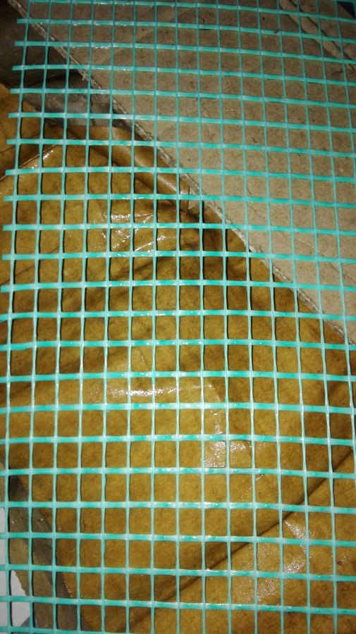

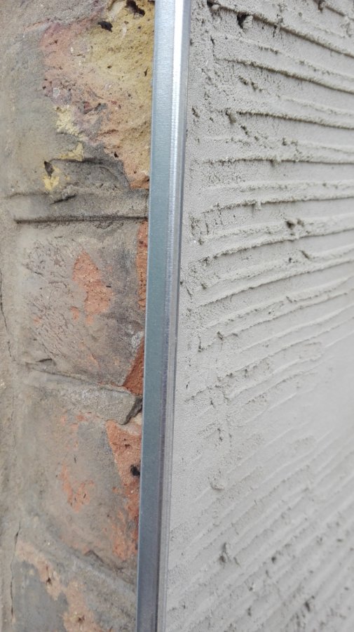

Tell me how bad they done it so far?
28 Apr 2013
137
Cornwall
I have these people in to do some rendering and they not finished the first layer yet. not been here for a week and no money has changed hands, teh quote was from a friend of a friend who is a builder and he gave the work to someone else. We never knew that was gonna happen. They have left some of the old render around the doors and windows and also left few bits at bottom at damp course level. used stop beading on all corners and now apparently used plastering tools to key it.
Any advice much appreciated

this is the mesh..fibre glass?

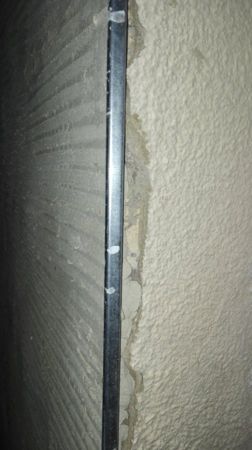

this is part they left around window

The third picture didn't get posted. I assume they are taking the render round the corner, and not just stopping on the first wall - in which case, they should have used a corner bead - unless they're going to do that on the top coat. The fibre glass mesh would normally be used on External wall insulation, so exactly what is the job, and is it a standard sand and cement render. If you're paid no money yet, then don't worry too much, but it might be worth calling the friend of a friend first, and get his comments as well.

Can't you take pics of the whole job? Your reveals should have had the render taken off and a corner bead fitted not a stop bead its a half hearted job by the pics you have shown so far

They should do around and over the old stuff because it was 'solid'....took 5 seconds to with a screwdriver to take some of this 'solid' stuff off. On other windows where its back to brick this also did it like first picture with stop bead. the guy who gave the quote should be here either over the weekend or Monday, he is a builder who comes highly rated.
The mesh was being pushed into the first layer. Just found a bag of sand that says building sand for brick laying and INTERNAL rendering.

I would put a pic up but the Mrs doesn't want that. Thats what i thought a half hearted job.

It'll be interesting to see what the friend on a friend has to say, but I'd call it quits with them before they screw up even further. They're using the wrong beading, the wrong sand, and possibly (but not importantly) the wrong tools. Has anyone else out there seen the fibreglass mesh used on a sand and cement render.
