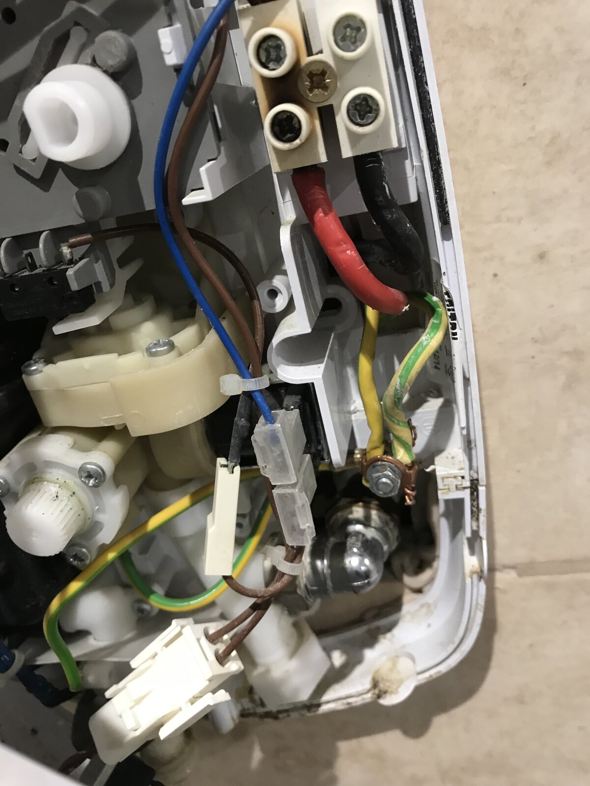

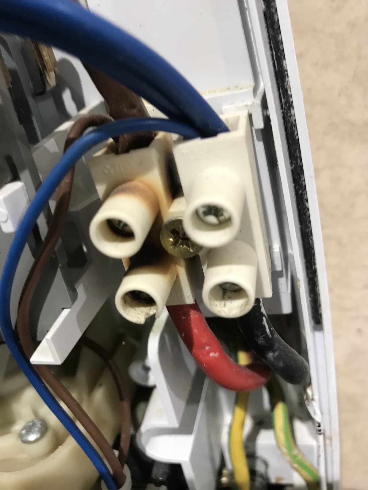

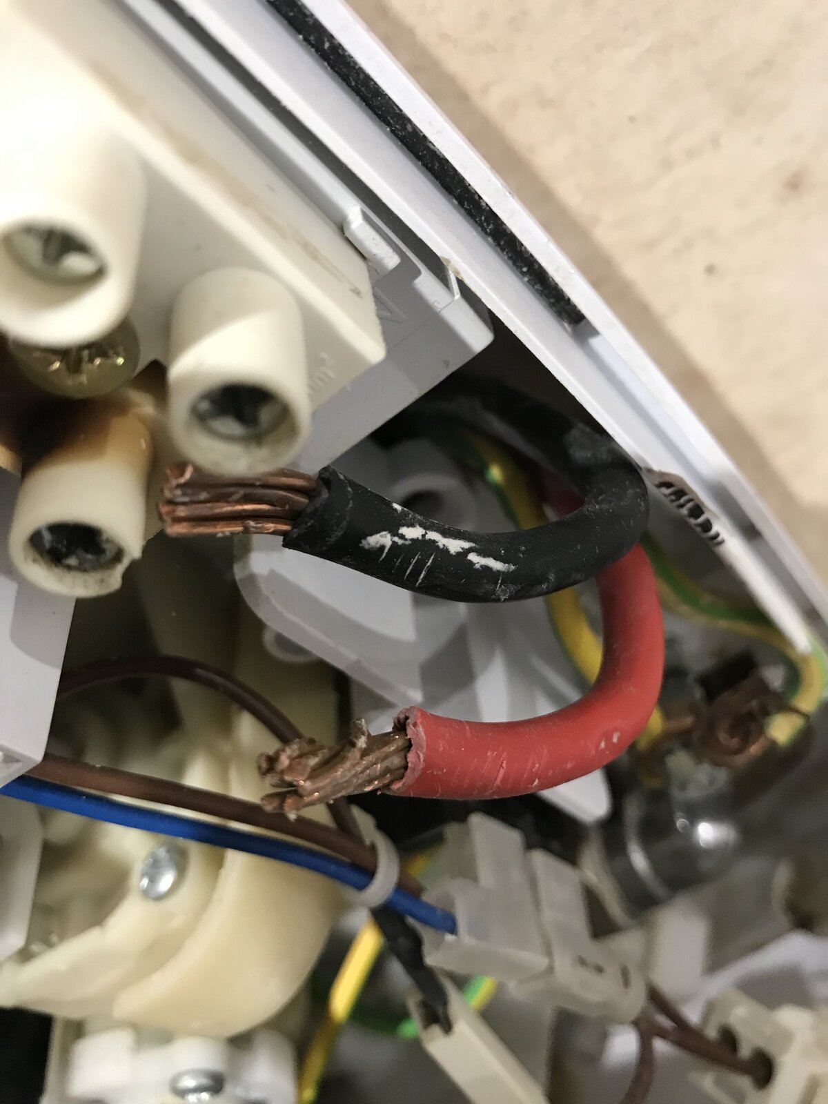

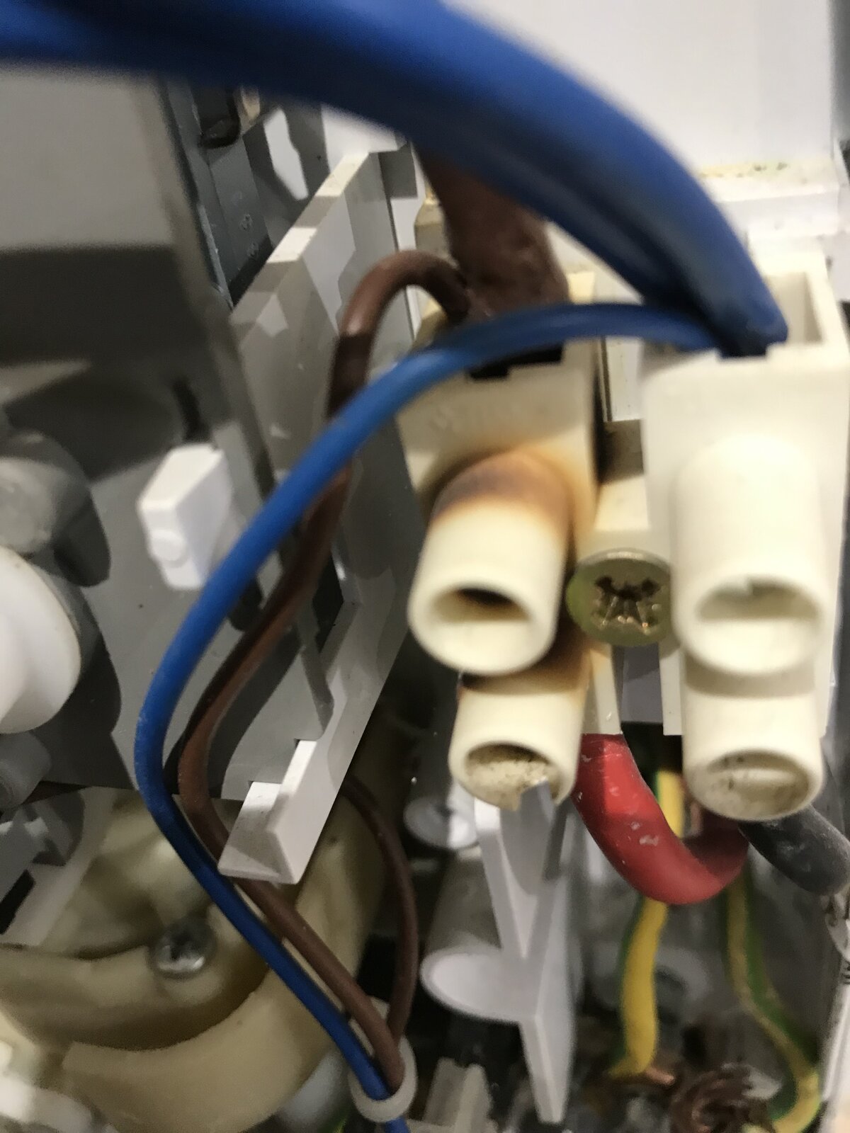

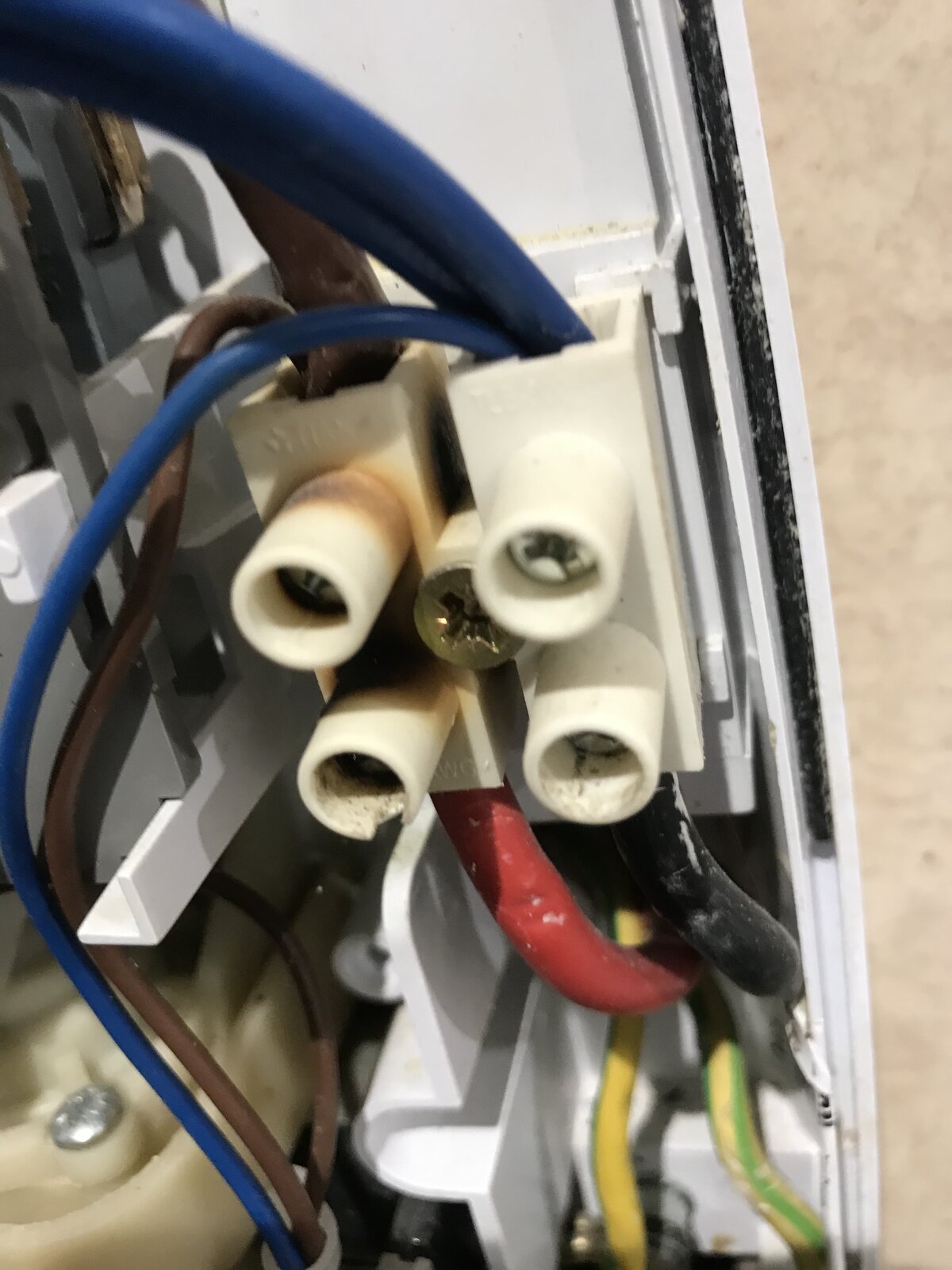

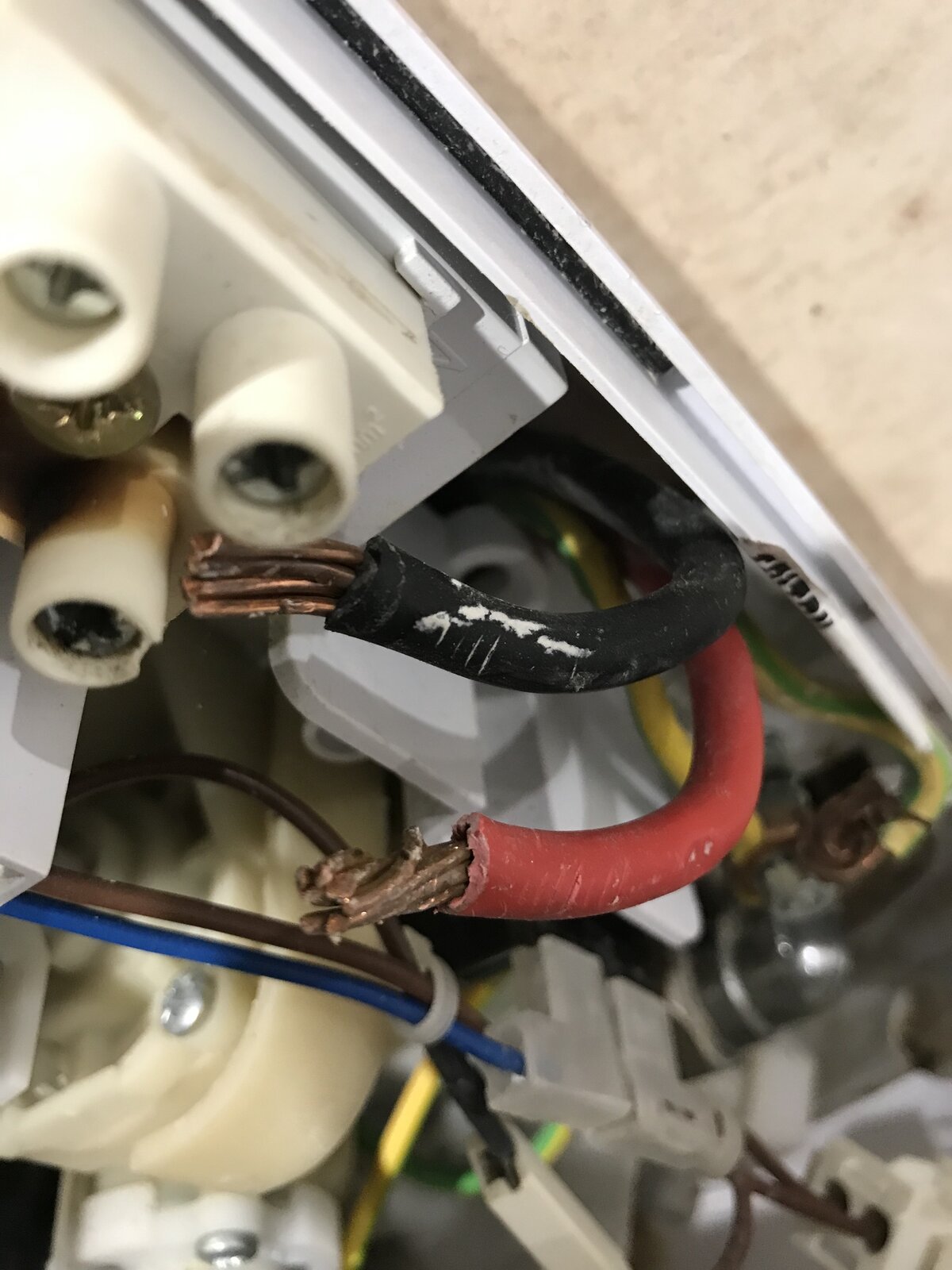

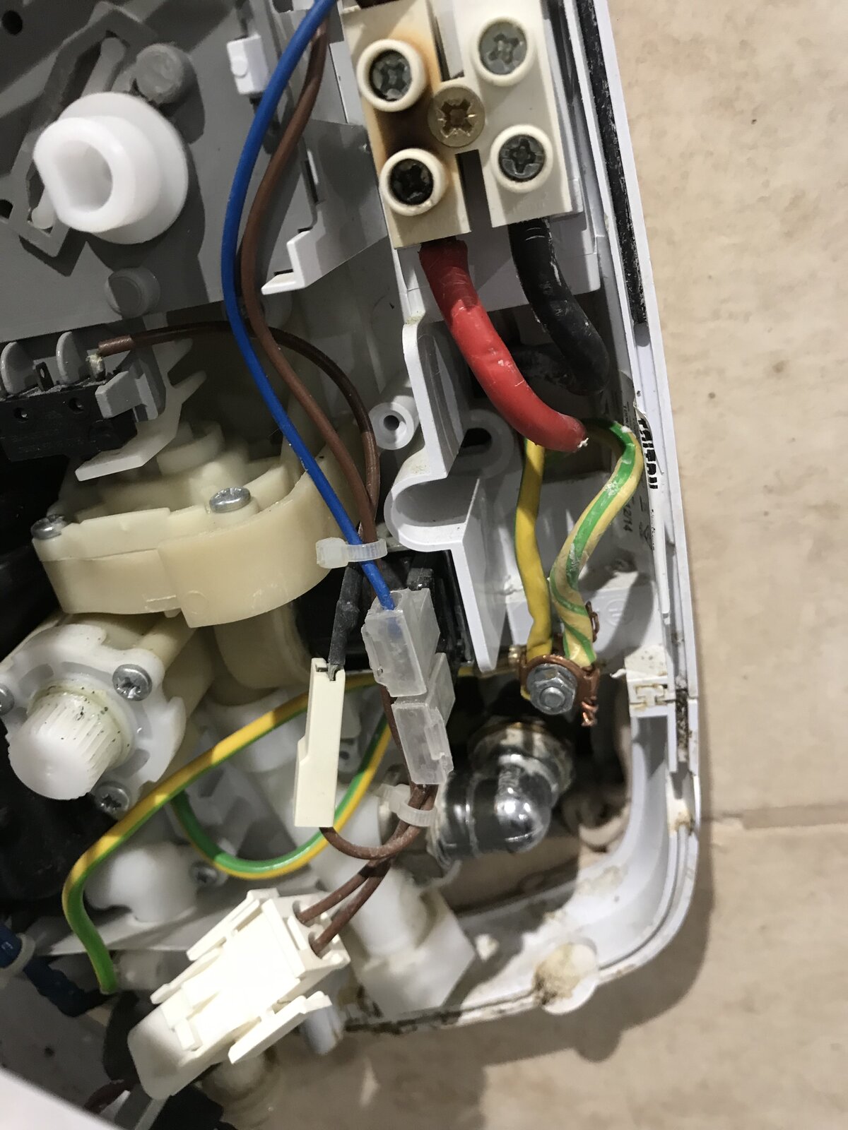

I opened up the existing shower and noticed signs of burning.
Unfortunately, I didn’t check for loose terminals before unscrewing it. I then screwed the cables back into the terminal. I have done another test and it seems okay. The issue is intermittent so it may resurface when used in anger.
Is this a plausible cause?

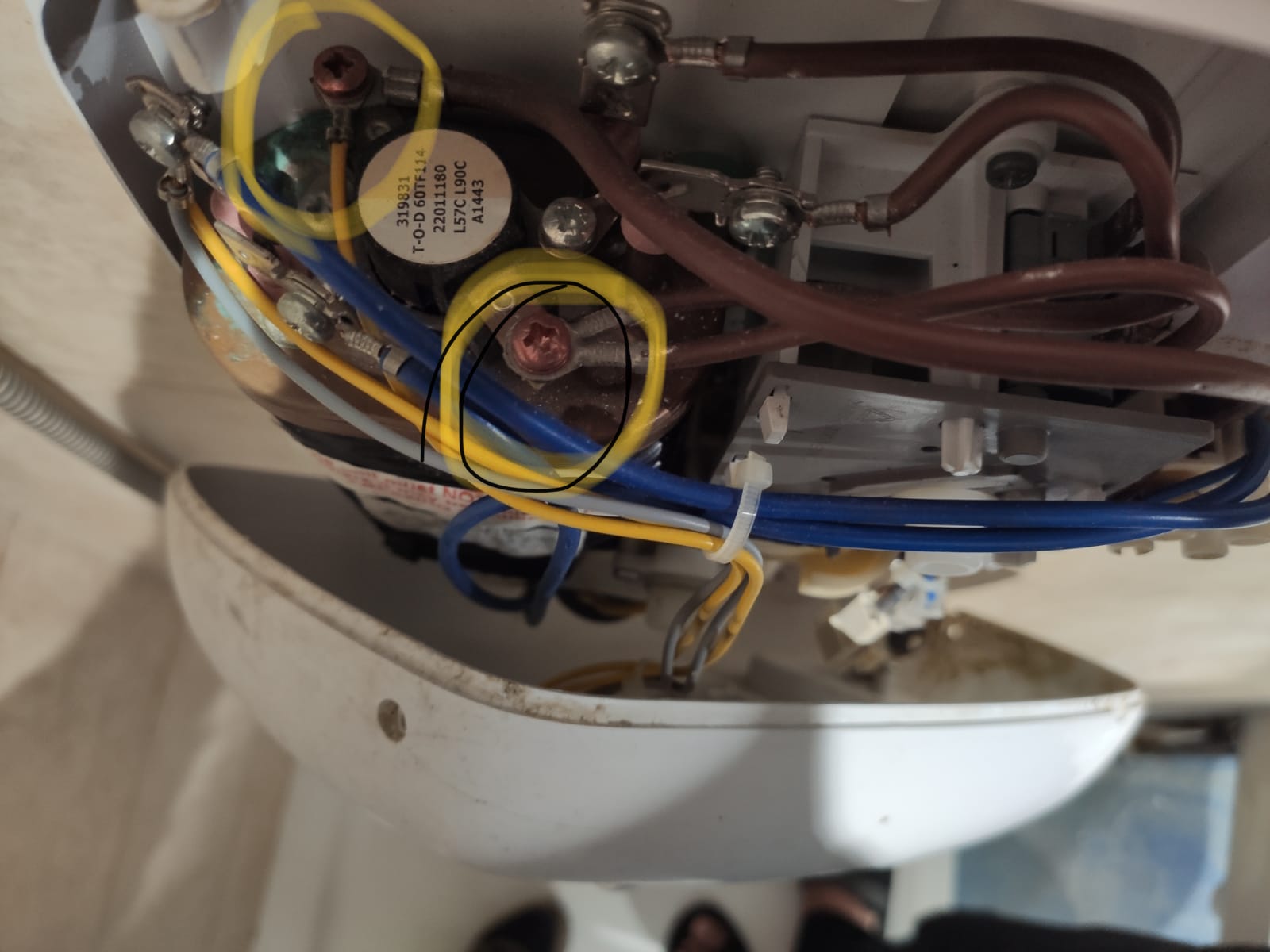

Also, the shower is 9.5KW and when I tested continuity across these two terminal (circled in yellow), it reported continuity.

You tested for continuity across the thermal cut out (tco) which proves it’s ok. Burnt connections are never good, so this could have also been the reason for you having hot water then cold. Have you tested the voltage at the shower?
Yes, 240v. I measured this using the voltage display screen on my Fluke 2 Pole Tester.
