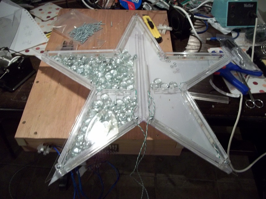

For decorations ( amd some other uses ) I have found good quality LED strips and a variable DC supply to be an adaptable and reliable way to achieve the results I want.
Such as this star for the top of the Village Christmas Tree

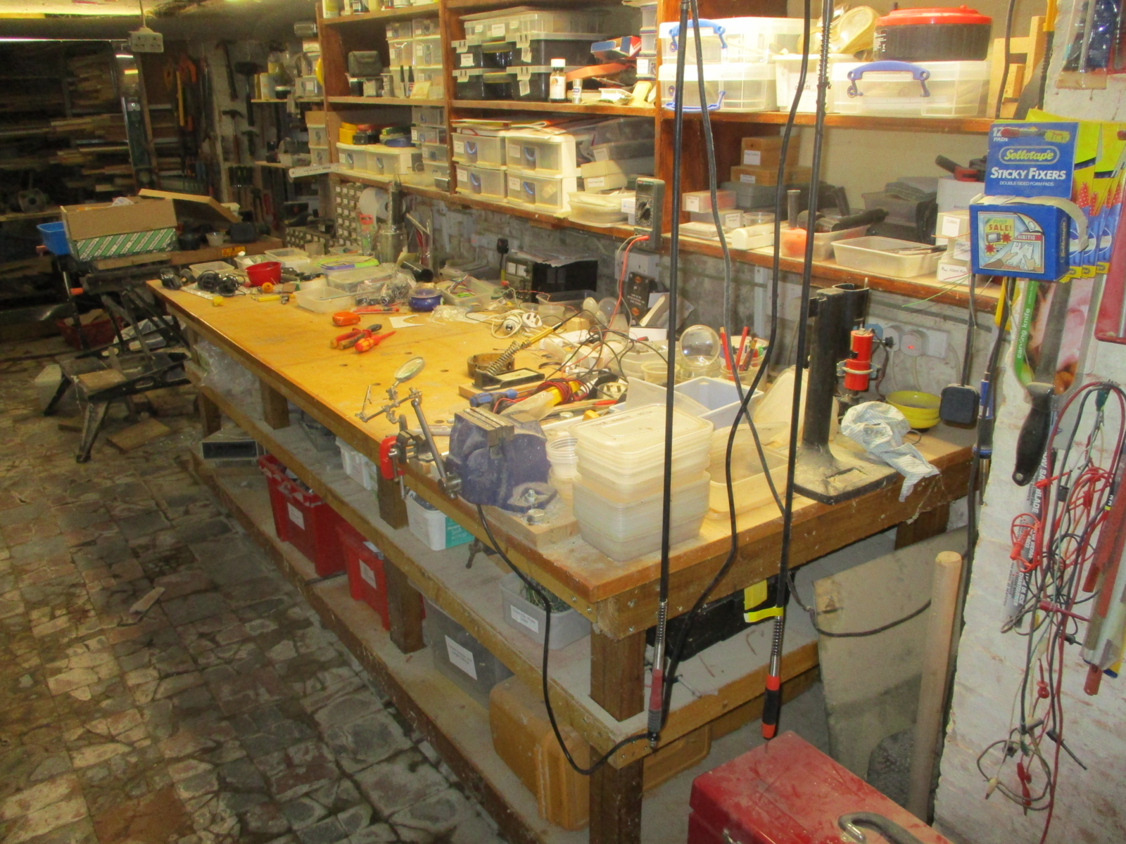

Not really, by my standards - some of the surface of the bench top is visible :)
Kind Regards, John
Id have to start by asking what that thing with square shapes is in front of the bench?
I think you'll have to explain a bit more clearly before I can answer that. I presume you don't mean the floor?!
