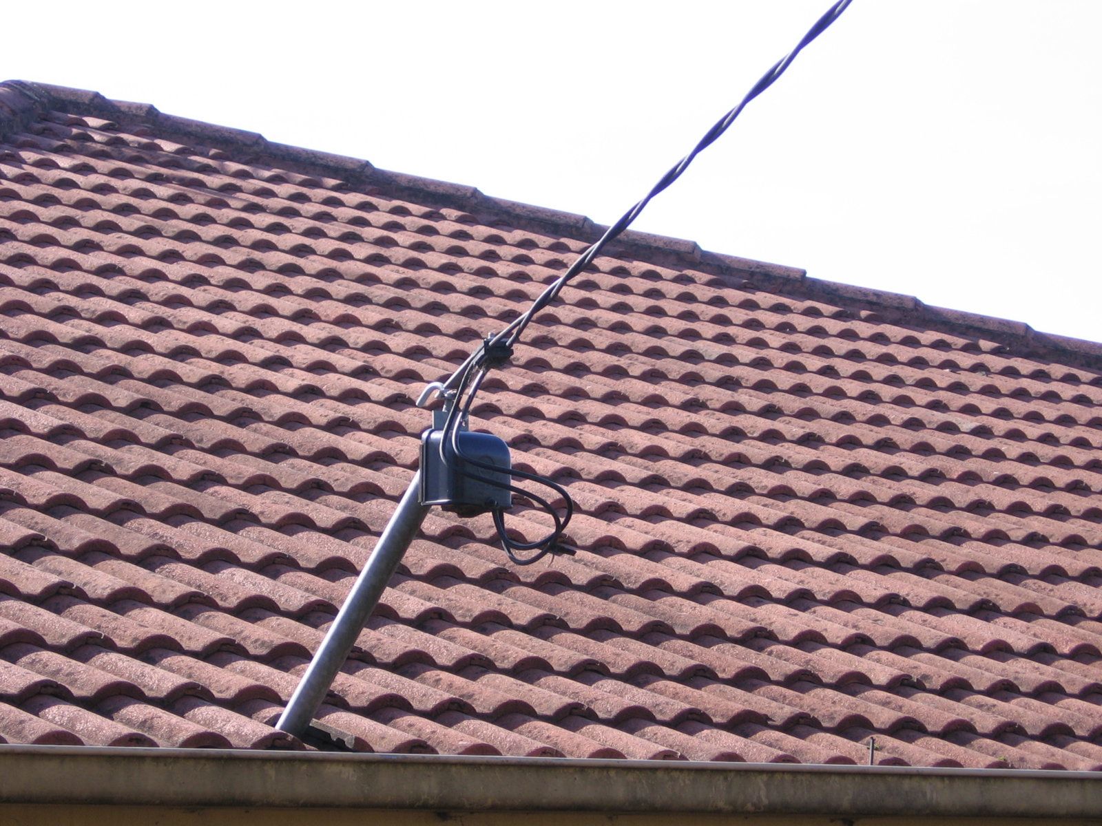

I think I read that quite a lot of Oz electrocutions are from contact with overhead lines, which are much rarer here. When run to houses, there was (is?) a program to replace bare with insulated cable in the UK, and the operators will, on request, fit protective sleeving if, say, you're mending the roof or painting the house.
I am not quite sure what you are attempting ti convey here. The "overhead" 240 V connections from the "mains" to individual houses in Australia are always via insulated conductors to the connection point - as is shown in the illustration below.

overheads are rarer here. Even when I lived in a rural cottage supplied overhead, there was a pole-mounted transformer nearby, and an armoured cable ran down the pole, into the ground, and entered the house from below. The overhead was high enough for combines and other agricultural machinery to pass beneath.
