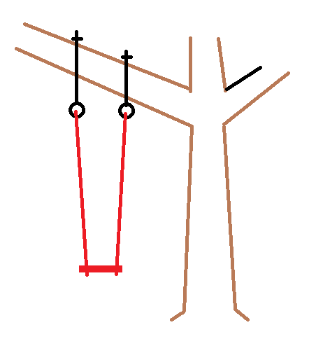

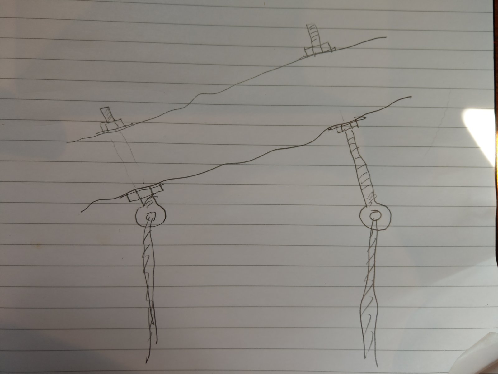

Hi, I want to fix a swing to an angled tree branch. If I attach both ropes to the branch the swing twists. I understand I need to put something rigid in, so that the pivot point for both swing ropes is at the same height.
I thought the easiest way to do this was to fix through the branch using M10 threaded rod, penny washers and nyloc nuts on top, the rod extending below the bottom of the branch, with an eye nut or coupling nut and eye bolt at the bottom.
Any thoughts on this? I know you shouldn't use threaded rod in shear but M10 has a shear strength of 23kN so way above 1 person swinging. Total cantilever distance from the upper branch 30cm.
How do I ensure the bottom eye bolt/nut is properly fixed? I was thinking of eye nuts, but there's nothing to tension them against. How about eye bolts and coupling nuts, all fixed with loctite?
See picture. Thanks.
What about using two nuts and lock them together? Or, one plain nut and a nyloc nut together?
Foxhole, can you give a bit more detail? Just tying a knot in the rope isn't going to achieve anything, and knotting the two ropes together means I'll have a single pivot - I need two pivots to keep the swinging in a single plane.
It could be an idea to use four holes in the seat timber (two per side) and pass the ends of each rope through to triangulate?

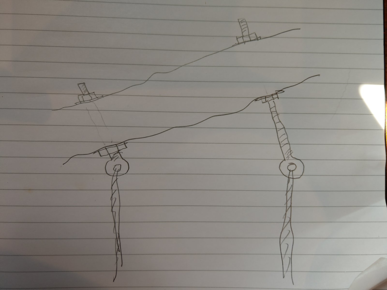

I'm assuming that the sketch is reasonably to scale
It doesn't look more than 4-6 inches with two holes straight through 18" apart
The branch is 250mm diameter and there is about 300mm height difference.
FMT That is what I want to do. I can't get eye bolts long enough, longest I can find is, 200mm, hence looking at threaded rod and eye nuts.
You could use cargo slings wrapped round the branch and looped through itself.
Ahh OK, you could join your threaded rod to your eyebolt with a threaded rod connector, I think I'd step up to M12 and grade 8.8 or above which might mean ordering from a more specialist supplier rather than toolstation or similar.
