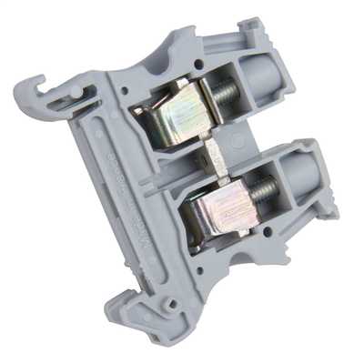

Use din rail terminals. The neutral and earth ones can be linked with bridging kits.
The din rail terminals are not particulay big, what side enclosue did you have in mind? I cannot imagine you could make it any smaller with the fused input connector blocks!

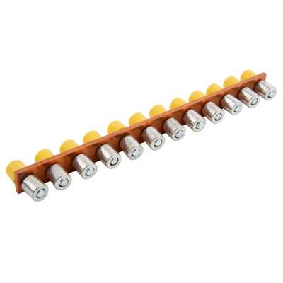

https://cpc.farnell.com/entrelec-uk...per-kit/dp/CN12829?CMP=CPC-ebooks-BIGBOOK2015
For the avoidance of doubt - when I use the terminal jumper kit, do the jumpers go in the top/bottom of the terminal block or is there an extra contact in the front? (Orientation written as if the DIN rail is mounted horizontally in the back of a cubicle). In either case, is it the intention that the jumper is then potentially open to contact with live parts - or is there a cover plate than goes over them - i.e are the name/number tags compulsory as they are the insulation.

Edit, I think the jumper kit is screwed in from beind before mounting groups of terminals together on the rain then marking separate isolated sections with a plastic terminal partition. I assume there's a small piece of the housing I snap off/cut on the rear that allow separate blocks to be couple electrically using the jumper kit. That would otherwise be in the way.

They’re screwed into the front, and remain recessed below the height of the front, so touch proof. No more exposed than terminal blocks. You can see in the pic the threaded hole in the centre.
