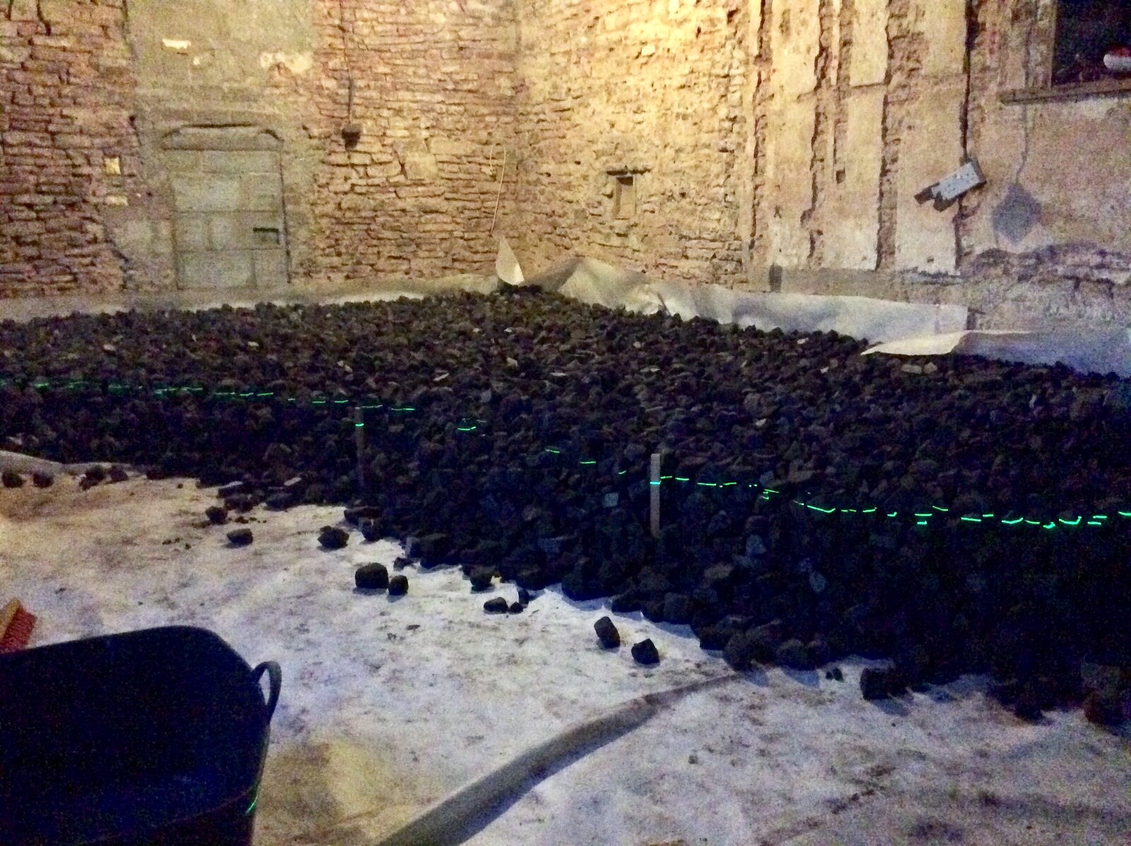

Very porous tiles, and very porous floor! Tried every combination of sharp sand, builders sand and NHL5.
Won't spread, won't stick, absolute nightmare!

Adhere-vit is probably product for you....Did you lay the limecrete over foamed glass aggregate?

Not come across that one. Yes, the more I've read about NHL5, the more I think I'll prob do cement next time - still on the foamed glass though.....
I've got the tiles to work using a NHL mortar.... It was all about controlling the suction of both floor and tile.
Here's what's working :
Wet floor with masonary paintbrush, not too much... then paint floor with a lime slurry. Spread 2:1 building sand /nhl5 onto floor with notched trowel. Soak tile in bucket of water for 10-15 seconds, back butter tile with the mortar. Press tile firmly into place.
Then grout with 3:1 sharp sand /nhl2
I've done about a square metre, only 15 to go.....
Foamed glass acts as damp/moisture control and thermal insulation to acceptable building standards u value.
