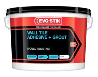

I have got a tub of Evo-Stick Tile Adhesive & Grout (which seems to be somewhat thinner and more 'runny' than previous tile adhesive that I've used) and it says to allow up to 24 hrs on porous surfaces and 48hrs on non-porous surfaces for the adhesive/grout to set.
Is it okay to use the adhesive/grout directly onto the plywood or should I seal the surface of the plywood first with some paint or varnish.
If I should seal the surface first - which is best - a primer/undercoat, an emulsion paint or a varnish? Also, if a paint or varnish, a gloss or matt finish?
Since the instructions on the product say 24hrs cure on porous surfaces, I'm guessing that I can use this directly without sealing the plywood first.
Is this correct?

9mm ply too thin to hold tiles, adhesive + grout tends to be too thin for adhesive and too thick for grout , terrible stuff.
Ply is the wrong material.
Use cement board, such as https://www.wickes.co.uk/Knauf-AQUAPANEL®-Board---12-5mm-x-900mm-x-1-2m/p/207027
Tub slop adhesive isn't recommended either.
No, it means that it sets by drying out, so on porous surfaces the water in the product will soak in and it will dry out faster.
On other surfaces all of the moisture must evaporate through the grout lines, which with small tiles will take a long time and with large tiles it will never set.
Cement based adhesive supplied as a powder will be far better, and you won't need any primers/undercoats or other nonsense.

I agree that the 'tub slop' is too sloppy to be an adhesive (I'm part-way through the job which I'm doing for a cash-strapped friend). It seems to be okay as grout though.
