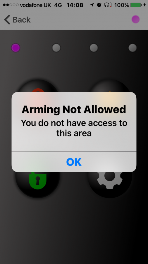

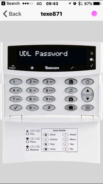

Im having trouble with the texecom app, I have no problems getting notifications/emails, my issues are that I'm unable to log into keypad , keep getting UDL PASSWORD on screen(I know my UDL password is correct ) image1.PNG also every time I try to use smart key app get message "arming not allowed you do not have access to this area "
Any help would be much appreciated as Its driving me nuts , going away on holiday soon and would like remote access to alarm

The smart key needs to mimic a user code thats already in the system, for example user 01 code 1234. Set this is in the app itself.
As for the keypad screen, are you waiting for the icon in top right to go dark blue?
IMG_9577.PNG I've set the user code as you have discribed i.e. User 02 and my code 1234 But smart key within app won't work , as you can see from above photo.
As you keypad screen led top right is pink with keypad display showing UDL Password .. do I need to enter udl p/w on app keyboard ? ,

So the top icon must be solid dark blue which means your connected to the panel, without being fully connected nothings gonna work.
Make sure UDL password in app matches panel and that the IP address entered is correct too.
I thought seeing as I'm getting notifications through the app that my ip settings were correct , ip updates every time I log in via app
Could be a router setup issues ?
Are you connecting via wifi on same network or on 3/4G? Have you enabled port forwarding?
I'm using a ethernet comport to connect to the alarm , as for port forwarding , Im not really a expert , but pretty sure I've done it , anyway that i can check if my port forwarding is set up correctly i.e. ping alarm panel ?
Do you get dark blue icon when on Wifi of same network? Totally close app and restart if you make any changes as its a bit of a cranky app.
does UDL password match panel to app?
The IP address in App should be same as your routers IP (Google "whats my IP") then the port number needs to be the same as what you setup on your router programming. You may have a firewall preventing access too. Are you using wintex?
I've just checked the ip address on the app, and its incorrect, I've just changed it to my current ip address, when it logs in it auto updates ip to the old address
Not come across that before, try turning update ip off and connect/disconnect from panel whist on wifi then 4G and restart app then turn update ip back on again. Worth a try but i dont know other than that.
