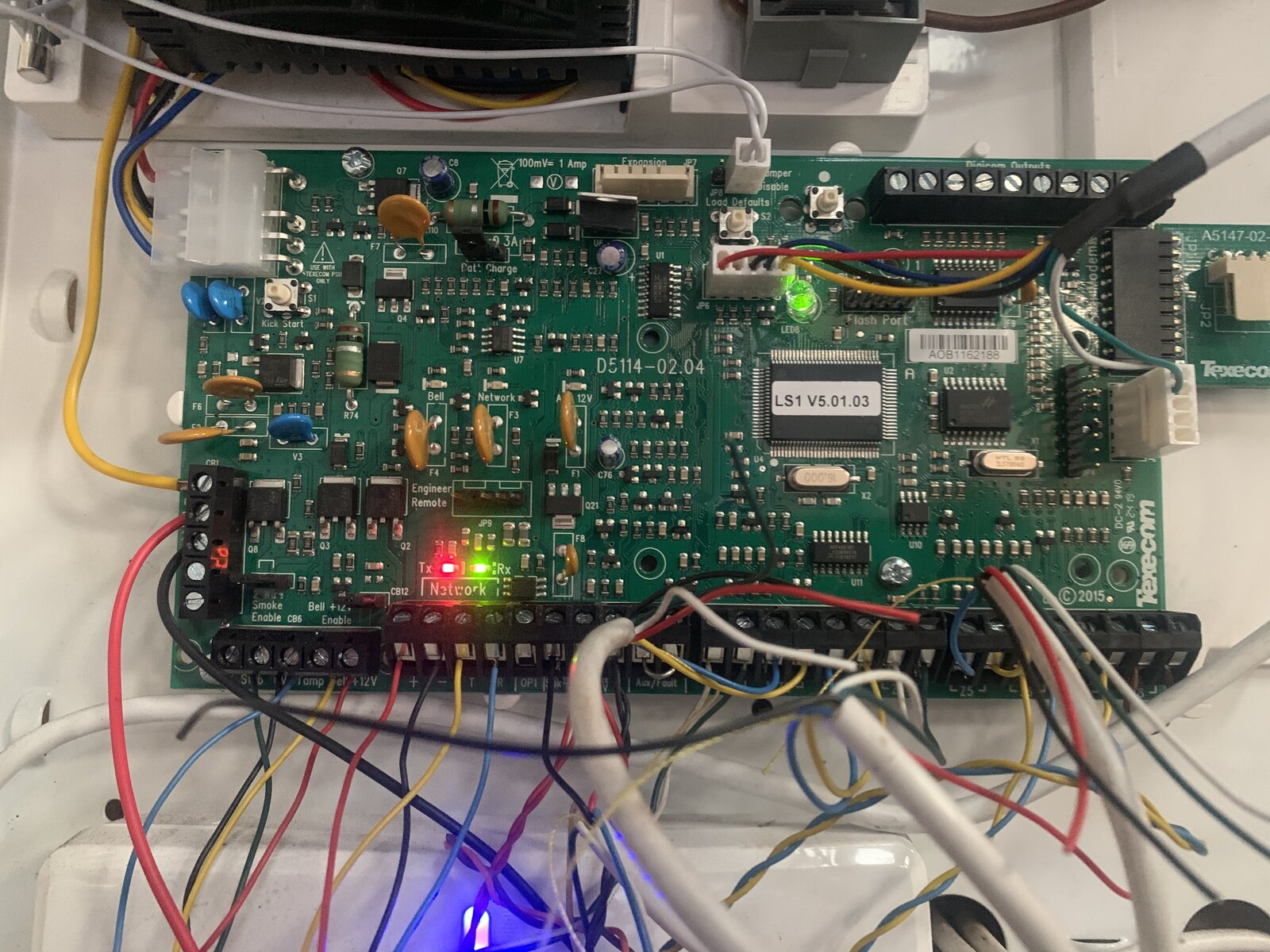

Ok, so had a look, the internal sounder is connected to spk and +12v.
the external bell seems to be connected normally.
so is there a way to have it instant arm rather than having the 5 minute countdown?

when you say auto part arm on a timer, how is that programmed?
if its auto part arm due to the entry / exit door not being opened the count down is a full set not a part set as such and will probably still sound. (but that isn't a timer)
if its an output into a latch or momentary key zone using a control timer then it could be set to instant and silent on the zone.
