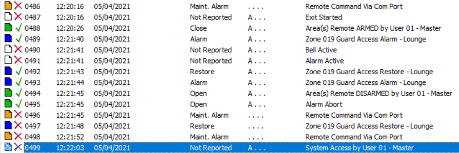

Hello,
I have a Texecom Elite 64W with a Smartcom, I have internal sounders connected to the panel outputs. When the alarm is triggered and I attempt to disarm from the Connect App the external bell will stop but the internal sounders do not. The app says the system is "Disarmed" but the panel outputs are still active! If I then physically enter my code on the panel keypad then the internal sounders will then stop.
Anyone have any ideas why Disarming from the App doesn't stop the internal sounders?
Here is a screenshot of the event log. I disarmed from the App at 12:21:45, the external Bell stopped, but the internal sounders did not, until I entered the Master code on the panel at 12:22:03.

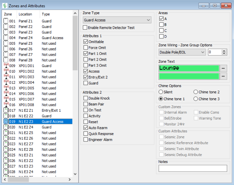

And here is the PIR Zone which triggered the alarm:

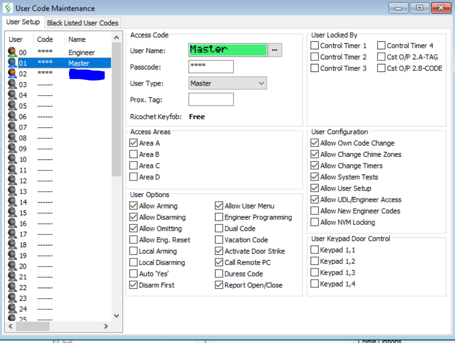

I am logged into the App as the Master User:

sounds like from the keypad the alarm condition is being reset, from the app it isnt, so you you could try unset button again or creating a reset button or program to sab
I was testing it by arming from the app and then triggering one of the internal PIR's. No opening doors.
