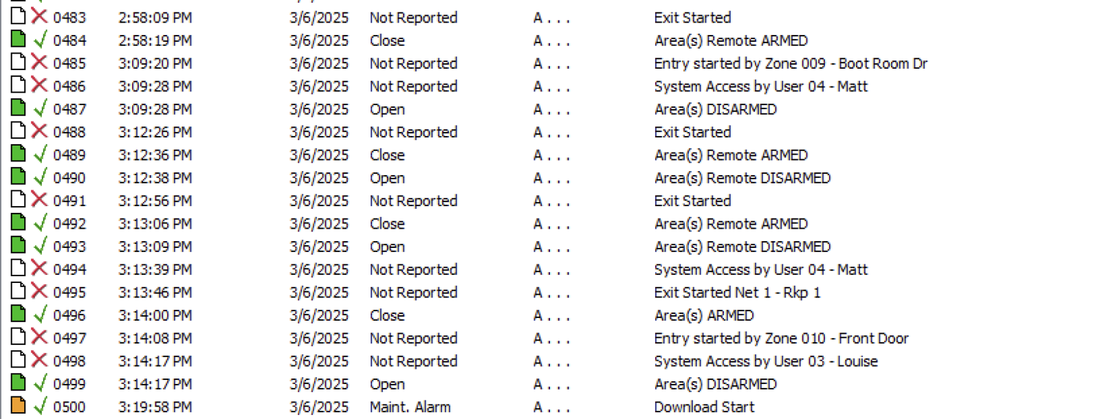

Nothing interesting in the logs - unless I need to do something for more detailed log

so your remote arming the system with the app?
or re we talking about you arming via keypad 1 wrt to sound?
sorry didnt read all the posts
so your unsetting at the keypad before or after starting entry?
so for example you armed and disarmed via the app, but Louise disarmed after starting the entry zone, zone 10, after you armed from the keypad.
if disarming from the app or texecom2mqtt it does the normal Texecom tune (not sure what else to call it) to signal disarmed.
If entering, you get the entry tones, then when you put the code in it just stops - no Texecom tune to signal disarmed.
