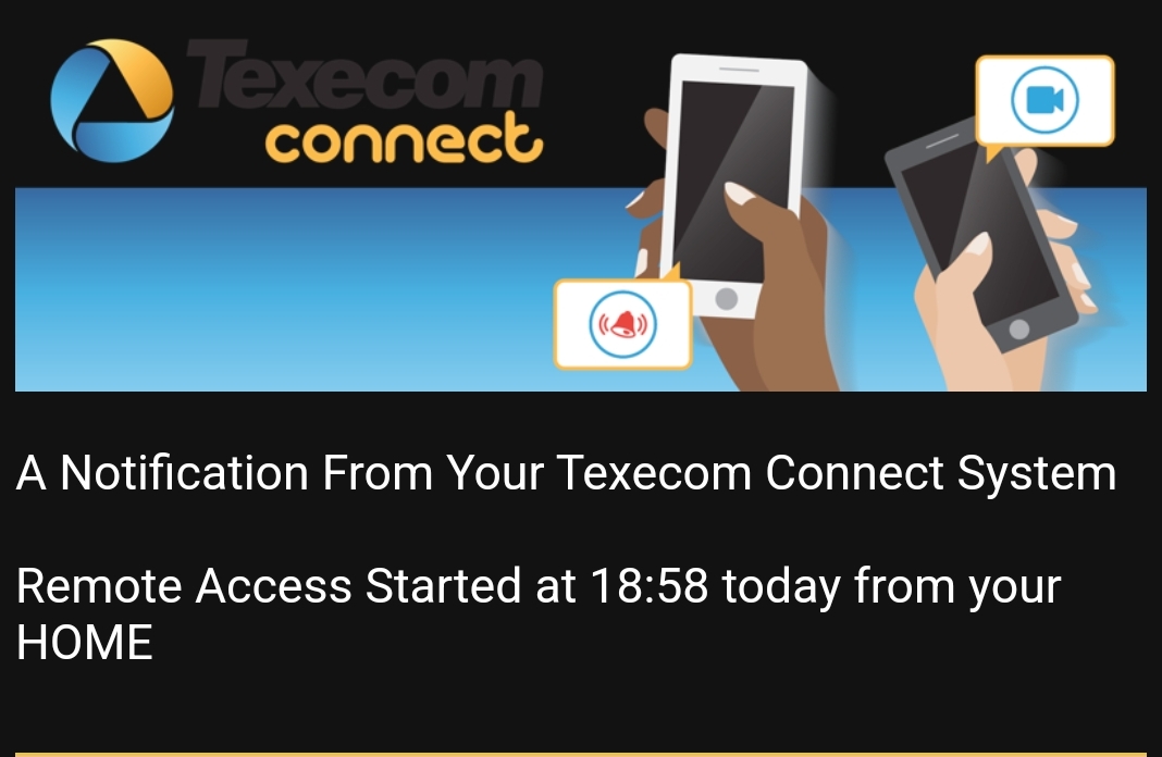

I had the android texecom connect app installed on my Samsung android mobile for the past 2 years and it never failed in sending me notifications when alarm set and disarmed etc. However annoyingly my phone was reset and I had to reinstall the app from my backup but my previous settings didn't transfer across.
I have set the app up again by using a new user code form the main panel, but can't get any notifications to my mobile. I have checked all the texecom settings in my mobile settings, ensured everything is on, the app is never put to sleep mode.

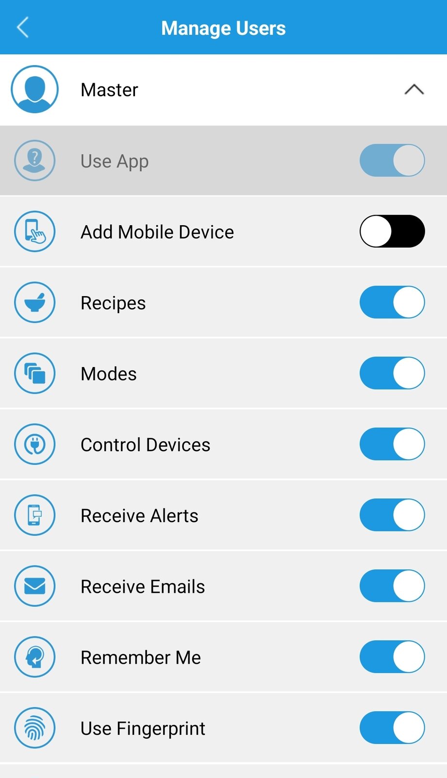

In the app itself I can see when the alarm is armed or disarmed. Under user settings receive alerts is on. I tried synch panel also. I then enabled email alerts and these come through but the notifications on my mobile don't??!
PS. I am using Connect V1 app and have not installed V2 from the Play Store as I heard from my installer it can cause problems with the comms module.
Any ideas please?

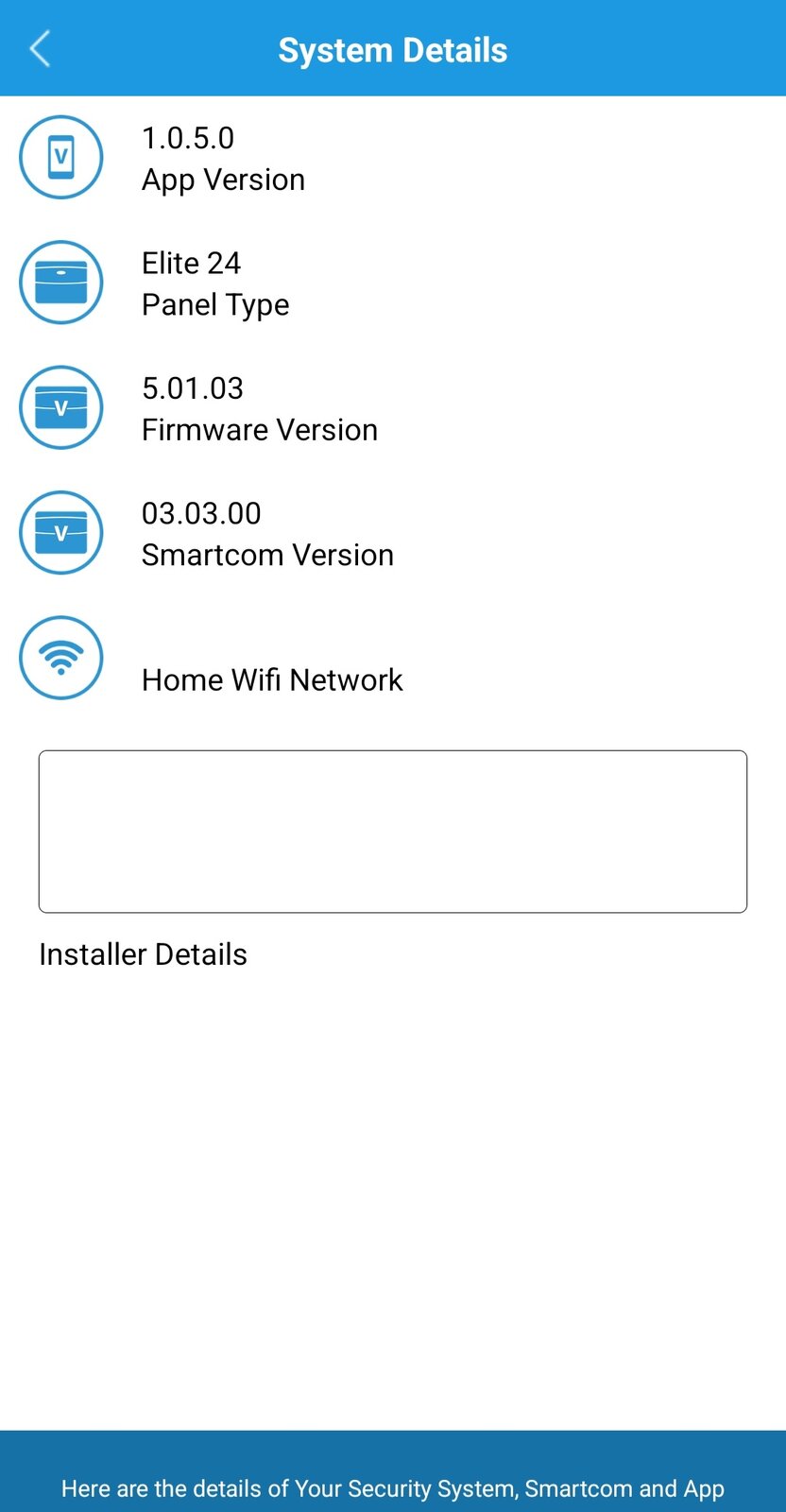

if you log in and out of app do you get a notification?
in the app, what are the system details.

I've attached some screenshots.
When I go into my app and log in I don't get any app notifications but I do get email notifications instantly. Same when logging out.

resolved, it appears to be V1 was no longer working for the notifications, after installing V2 the notifications appear to be working.
It was noted that on V1 logging in and out of app or setting system didn't appear to generate a notification, normally would have expected an app notification from those processes as phone was active, indicating issue not with phone sleep/ battery saving modes.
