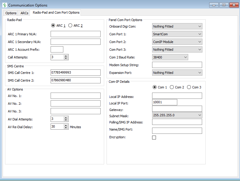

what is the ARC programming for connect and has the udl passcode be put back in the panel? once i do the reset it sticks the loopback in arc1 in the primary number once i've pulled it from the panel into Wintex i can see it there.
i disable the arc1 protocol as i said above and send that to the panel or alternatively disable option 7 then disable it in the panel ive done it both ways.
Im disconnecting wintex from the panel before resetting.
I'm connecting to the panel with wintex and so the UDL is correct and ive checked the UDL is there

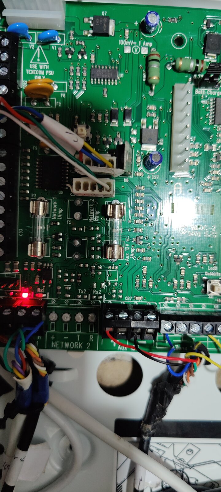

picture of the smart com and the cbles connected to the board, ie 4 wire to com1 and 2 wire to com 2 based on wiring and using udl on com 3?
sorry.

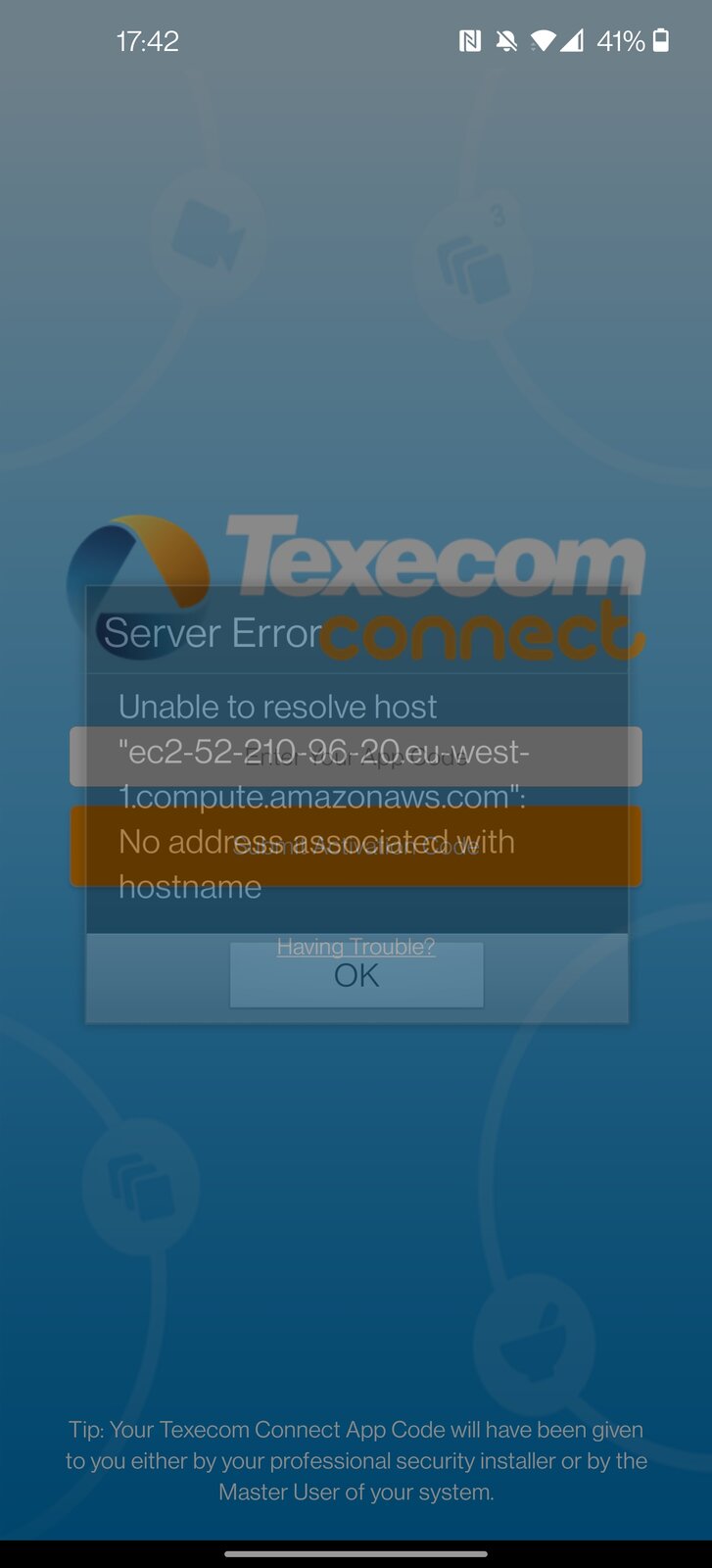

I've removed the app and reinstalled it?
It's an Android phone I'm using.
I sent the new guid to support I presume they need to sort it?
if you have removed the app then you jut need to set up new site after generating a app code first on the panel
so the panel is fine you can generate an app code, so whats happening when you use the app to setup?

DNS can use DNS servers of google 8.8.8.8
The panel was a version 5.02 and upgraded to 5.04.01? so should be okay on the 127.0.0.251 in arc although
what version is the smart com?
