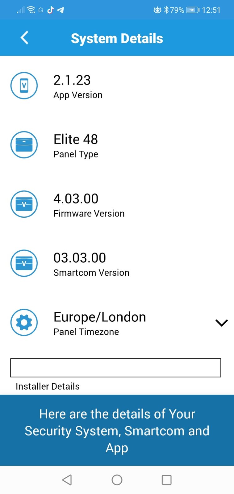

Looking at moving house, how do i register app with new owner? what else do I need to do to hand over to new owner?

So what is best way to proceed, can I not just put it back to a dumb alarm not connected to internet?
This is my system

Okay with that panel version number and smart com version it isn't on the cloud and guessing you are on version 1 of the app, which is no longer available?
contact Texecom and get them to advise on best way forward.
I cant see if its assigned to an account or not (I suspect not), unless I try and add it to my account.
There has been lots of changes recently and not 100% confident on a definitive answer as i dont know enough on your system and it would take time to establish where things are at.
I would recommend getting panel firmware and smartcom firmware up to date, panel firmware would have to be done manually.
If your able to generate an app code Then someone can check easily and advise on best way forward.
