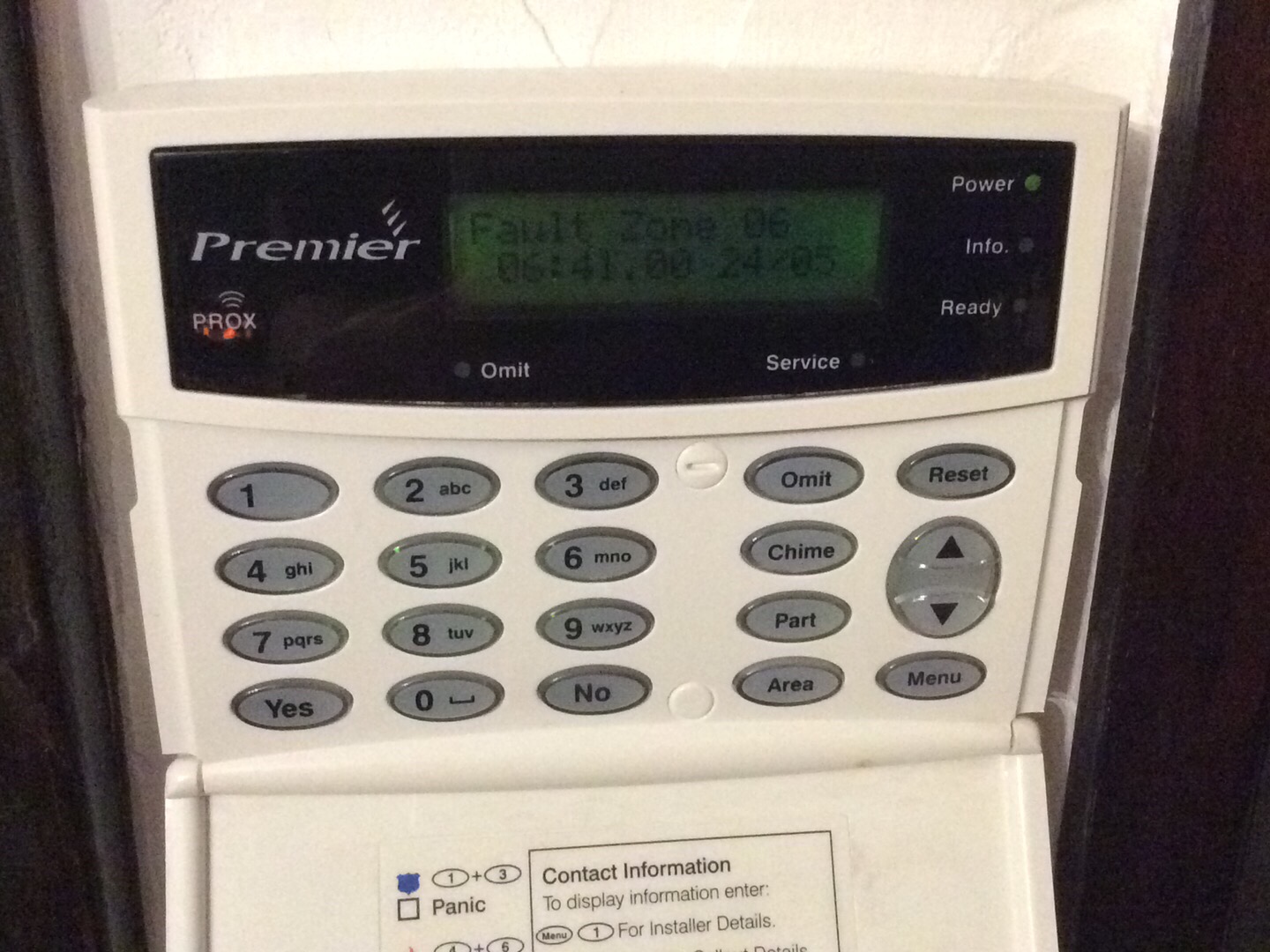

i don’t use the alarm system in this house (moved here in January) because I have a dog. Yesterday I came home to the internal audible alarm going off and the 3 channels that are the fire / smoke sensors had all “tripped”. I silenced the alarm but they are still reporting the error - that is to say they report smoke even though there was none. I’ve pressed the only button on two of the smoke detectors including holding it in for a good 30 seconds but that doesn’t seem to make any difference. Having reset the overall alarm I now get an audible warning when I open the front door plus a message about the fire channels which are 5, 6 and 7.
I’ve been through the instructions, which leave me quite cold for lack of user friendliness, and I’m none the wiser. How do I get rid of the smoke detector message and stop the door warning please ?

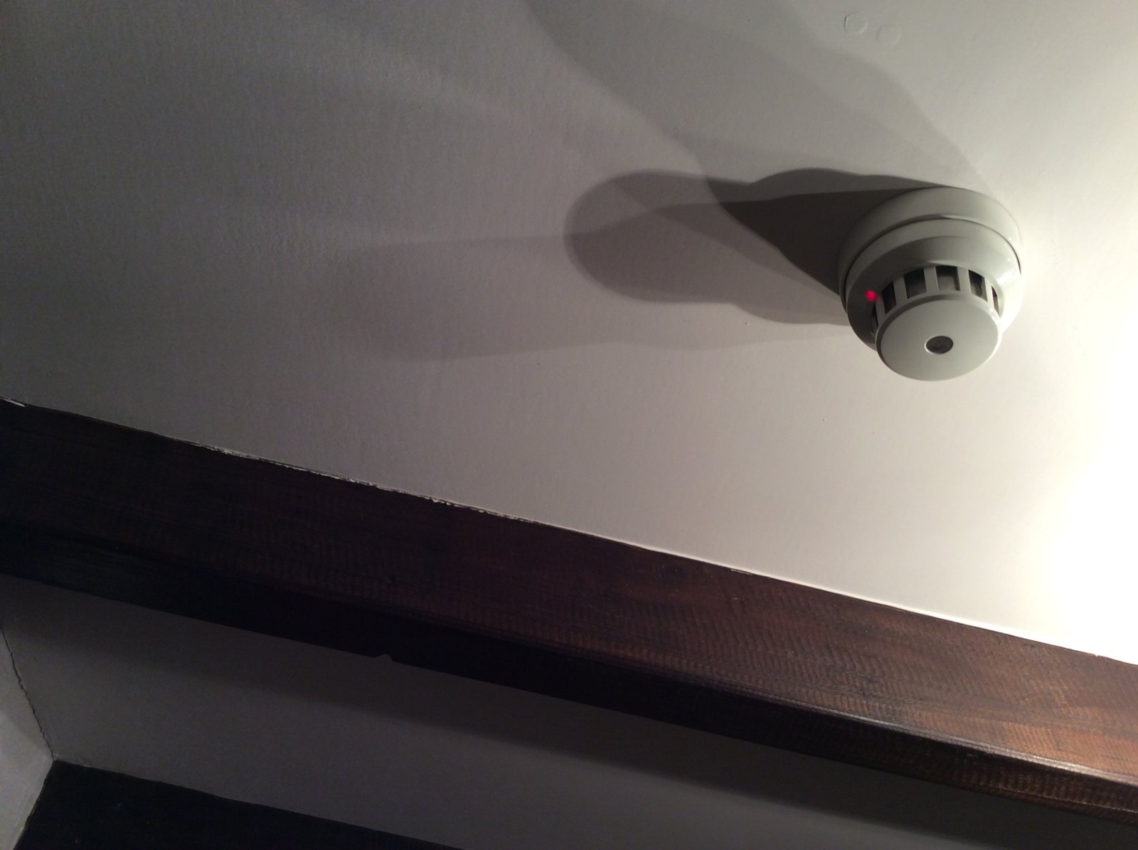

Are any of the PIR movement sensors lighting up? Do the smoke detectors show any lights? You may have a blown fuse therefore keeping all powered circuits open & preventing setting.

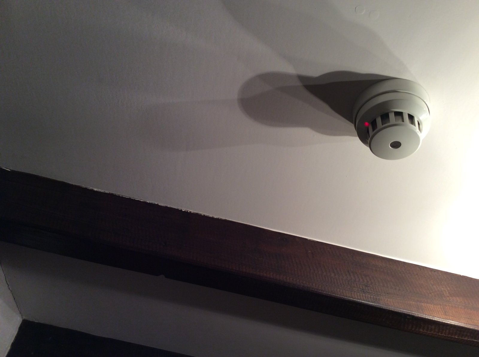

The 3 smoke detectors have a solid red light. Motion detectors respond to movement.

Fuse is ok then... Sounds like they have latched open & need resetting. This all depends how it was installed, some will have a custom fitted reset button on the main control panel (could be underneath) other systems will reset stokes if you Set then unset the alarm. Failing this (if circular smoke heads) untwist the head off the smoke detector then refit this should clear the light, repeat on the others.

@Alarm Engineer - I’ve tried pressing the only button on the detector to no avail and thus far I’ve failed to manage to unscrew the covers. I’m not clear what reset there might be on the panel? I’ve done the overal reset and I still have the message which is stopping me from setting the alarm in order to unset it lol!

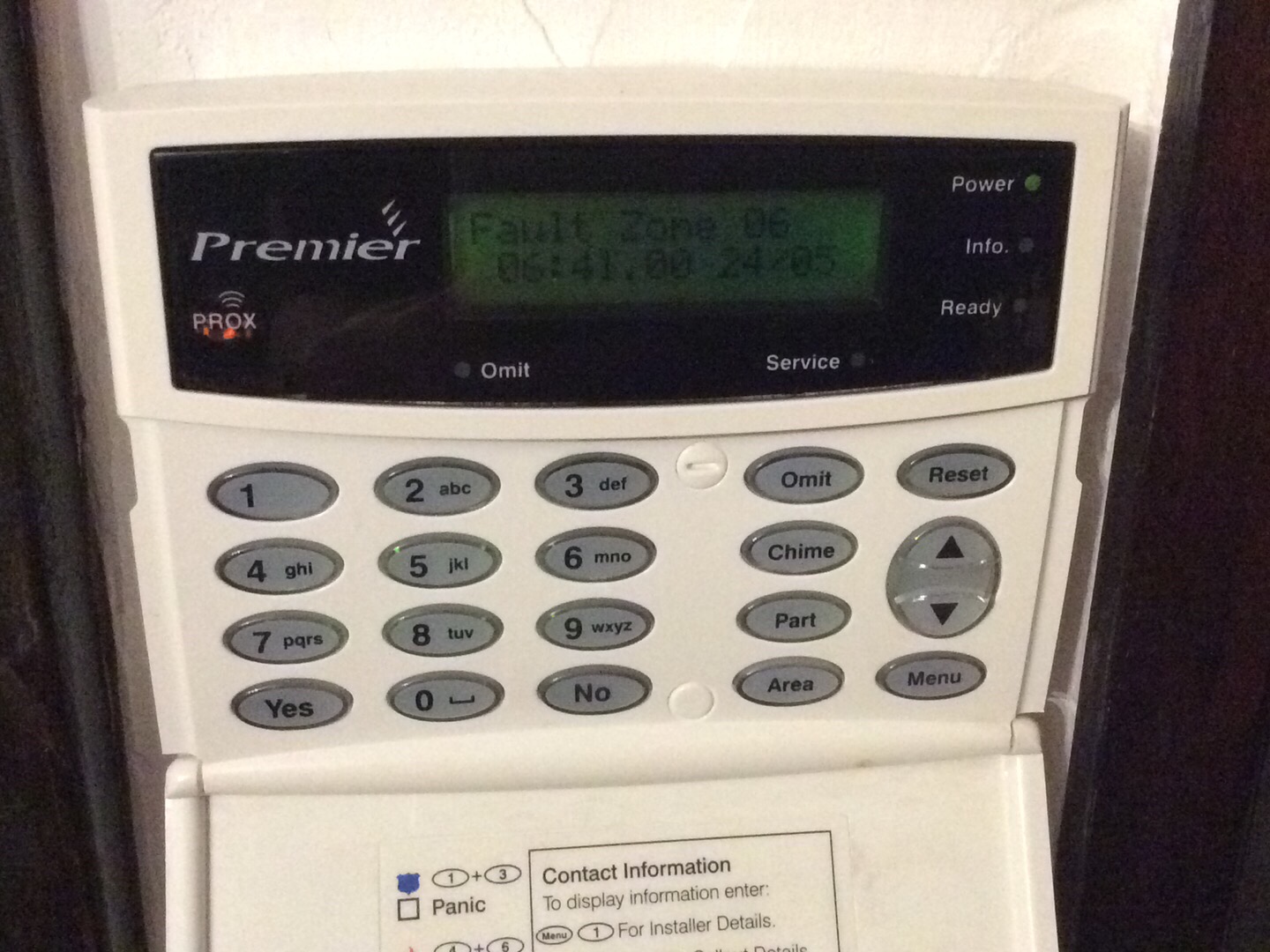

Try setting alarm or pressing reset , post picture of smoke detectors and alarm keypad
The alarm won’t set because of the message. Apologies for the photo of the detector - its near a light which I had to switch to get the shot :)

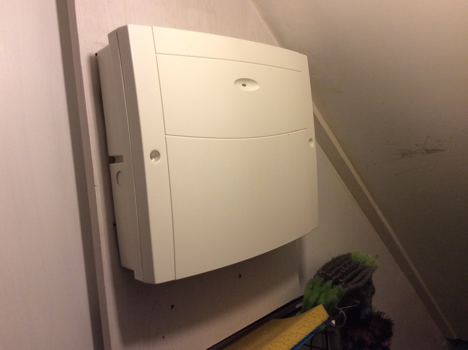

That detector should twist out anti-clock wise , what happens if you press the reset button on the keypad ? Or press code or fob followed by reset ? , other than that you need to find the main box it may have a press to reset button on it ? Normally you program smokes to detector reset output that resets on code + reset
What main box?
I’ve applied remote fob and pressed rest. I’ve typed the code and pressed reset. I’ve pressed reset. The latter gets me an audible alarm because of the fault. The other two make no difference but there is now a tone when I open the front door and that didn’t used to be there.
Press chime button on keypad that should turn off chime , there should be either an A4 size plastic main box of a larger metal box somewhere !
Menu the 5 message is “no location text has been set up”
There’s an unmarked box on the other side of the wall - ie in the understairs cupboard - which is screwed shut. That it?
I assume you mean the a4 box.
