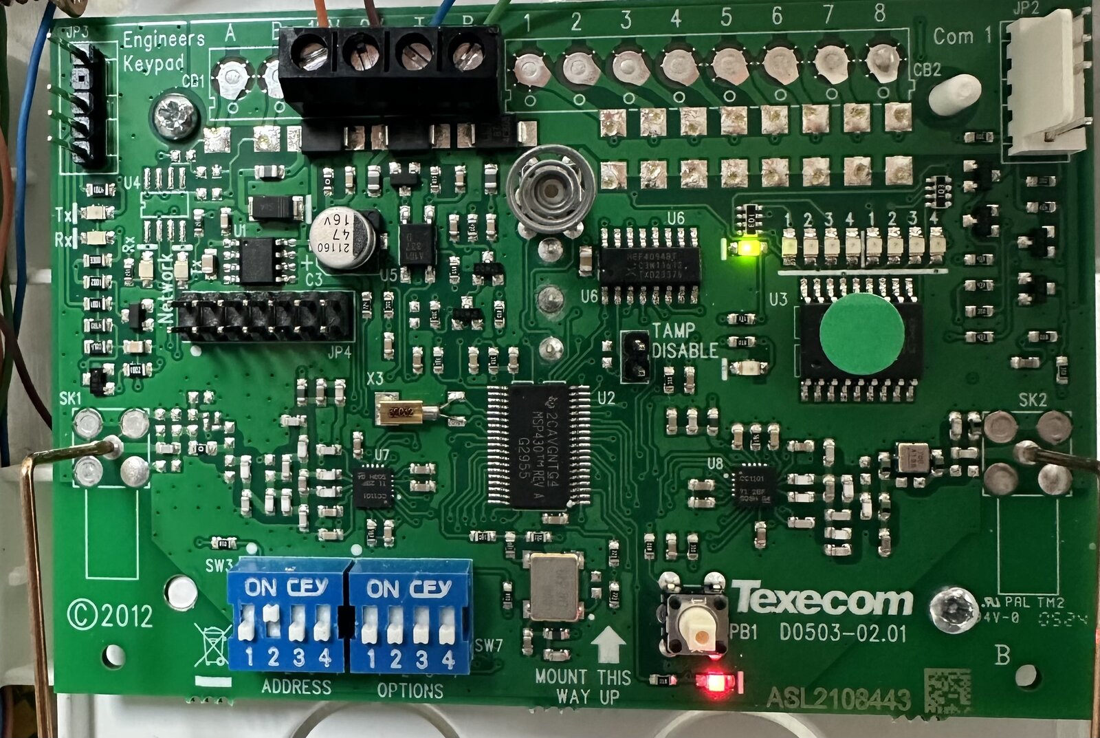

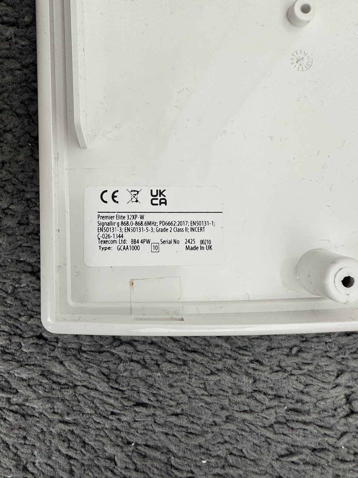

Hi all,
ive just upgraded my alarm with a Texecom Premier 32XP-W Remote Zone Expander GCA-0001 ver 3.11 (bought off Ebay as a new item ) so Im able to add wireless devices to my system, but having trouble installing it,
I have one keypad installed so ive extended the wiring off that 12v 0v T & R & set DIP SWT 2 to ON,

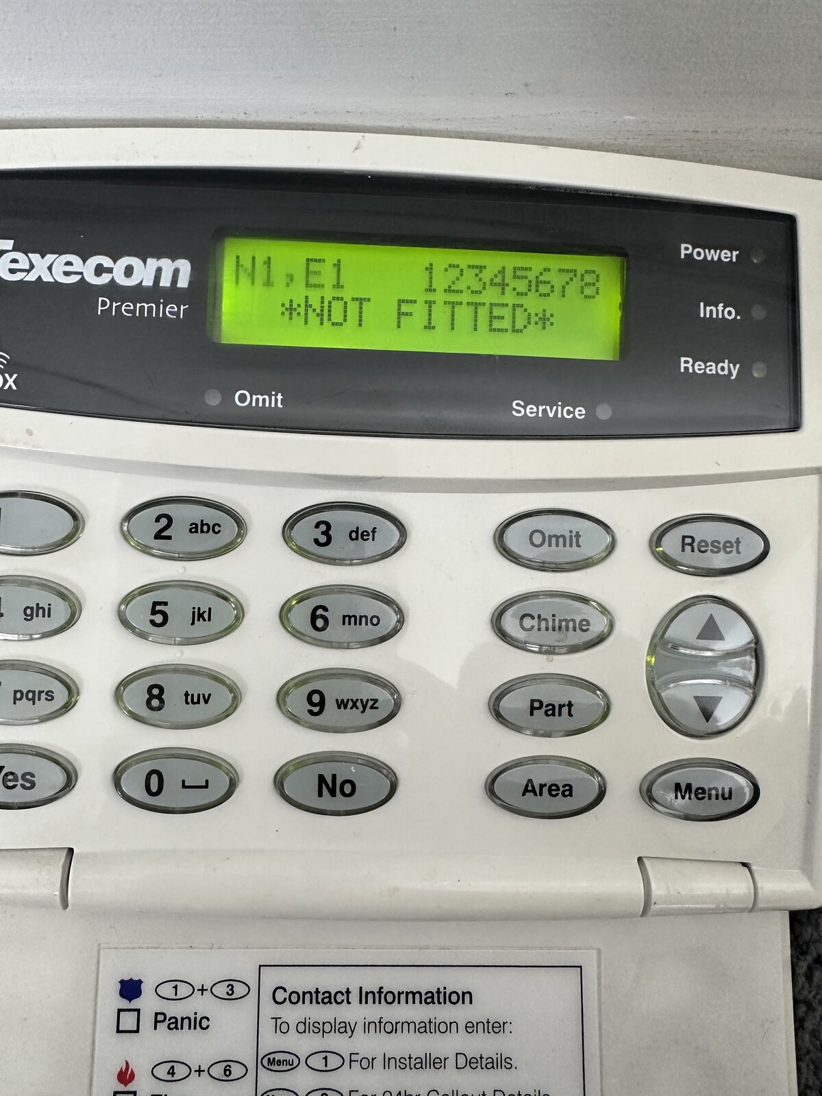

when I enter my system menu to confirm device , its states no exp device fitted , Id be great full for any advice please
Premier Elite 48 (CAB-0001)
Firmware v6.05.03
Ive added photos if that help's
TX led flashes red & red Led below Texecom name flashes on/off

Is there any other expanders on the system.
I would set 32XP-W on a 48 to address 1 and you start wireless zones at zone 9, as address 2 you start wireless zones at address 17
