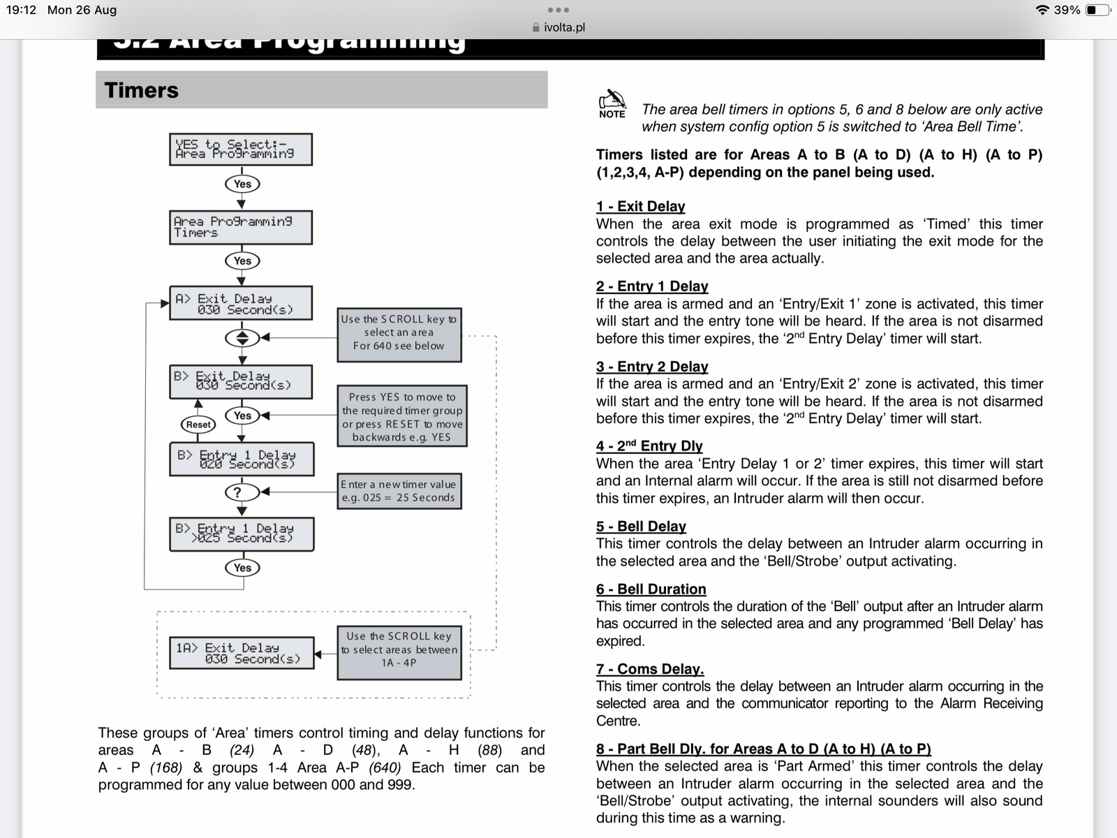

Only thing I can think of is comms delay ….but I think this is in the seconds range ….
As below….
Thanks Sparky appreciate your efforts...I'll check - might be set for 2,700 secs !
I think I did check them though against the default settings and nothing appeared untoward - I was looking to see if the default 15Min Bell Duration and some other 030 Min default might somehow be connected but nothing jumped out..
Cheers
FF
