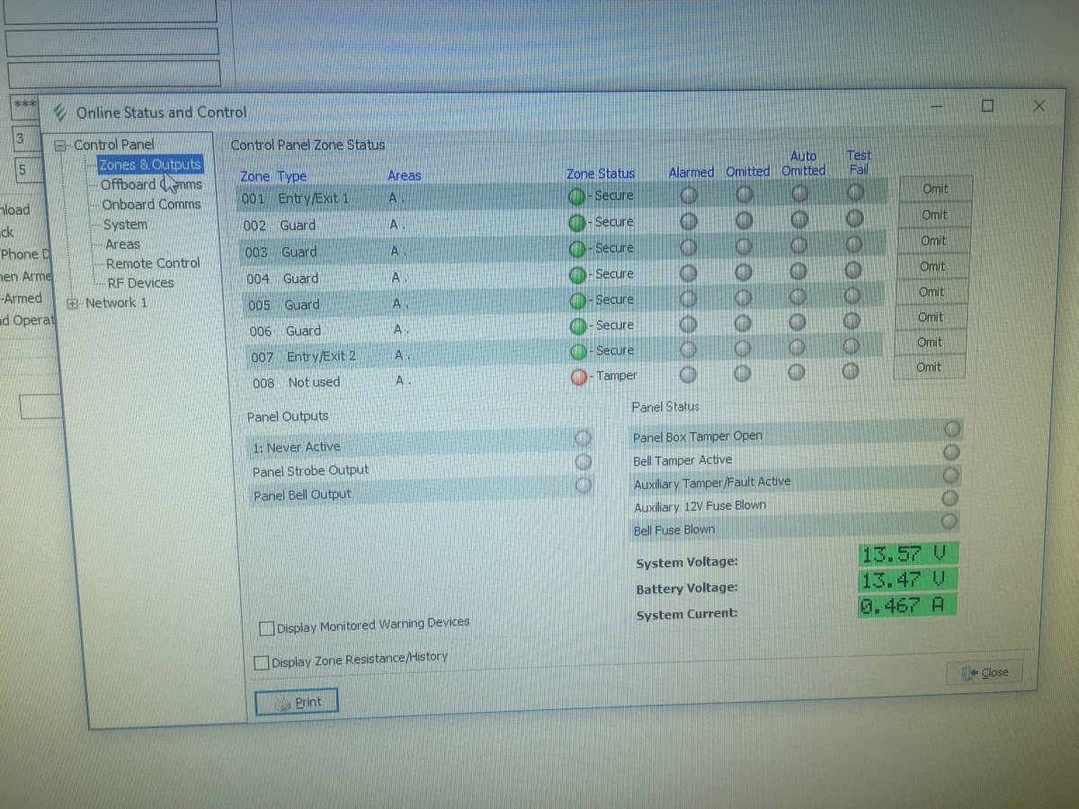

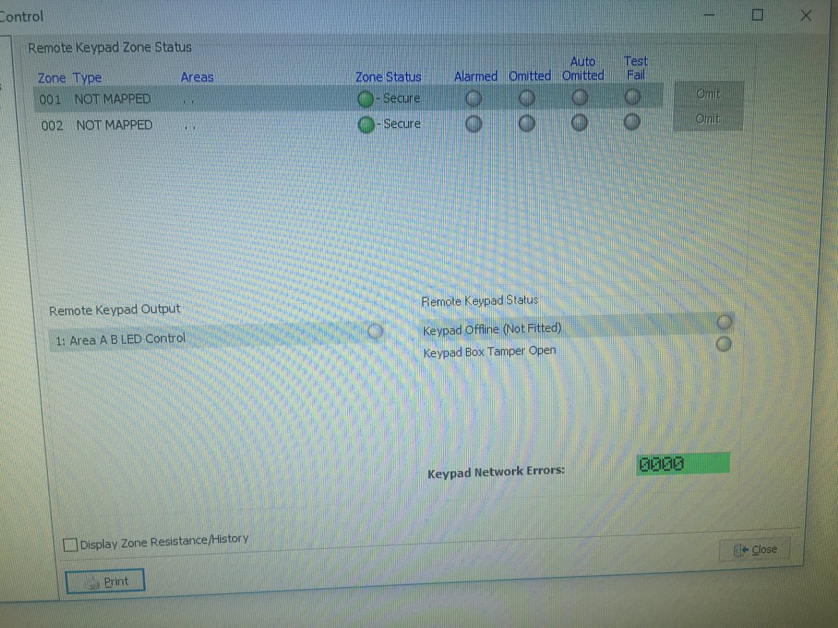

Are zones set right, Why is keypad not mapped, Zone 8 is not used (or wired) yet it showed a tamper when I checked door contact 2 which is zone 7

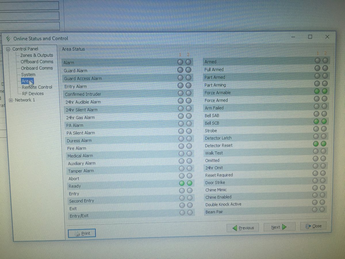

Bell shows SCB (not sure what that is) and I wired for SAB (I think) and SCB is not ticked in software
Because your not using the keypad zones ... You can map these to any zone you want , if needed , it will show tamper on 8 if not used unless you put in a 2.2k resistor .
Where would I need to put in the resistor? To part set do you just enter a user code and press the part set button on the panel ( that shows evening set)?
across the zone in the panel
theres o need to if you know its not used.
You could go to zone setup and change the wiring type of zone 8 to normally open and leave as not used and it should show up as secure.
If you use wintex, you have to change the zone to something other than not used to change the wiring type.
