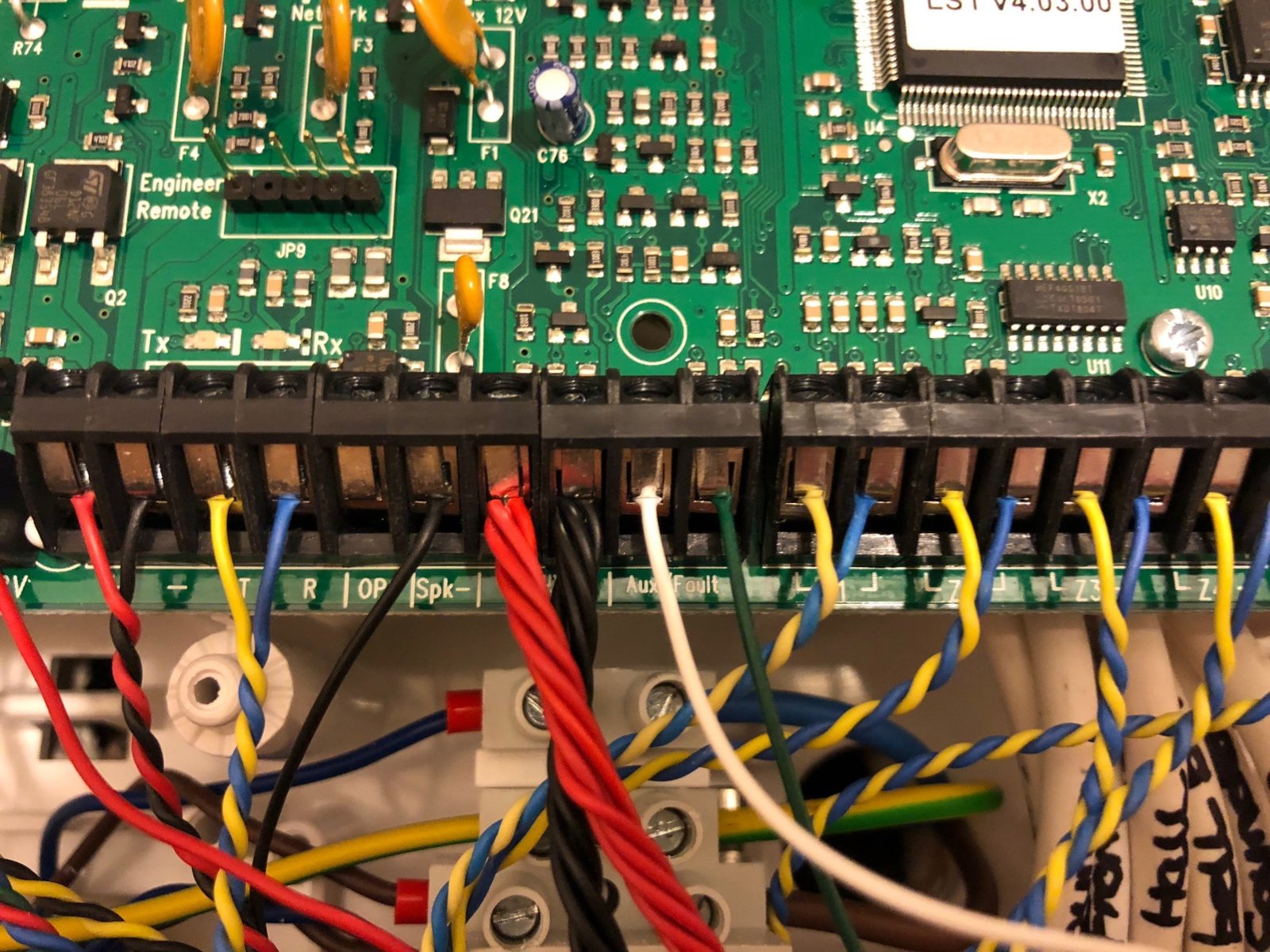

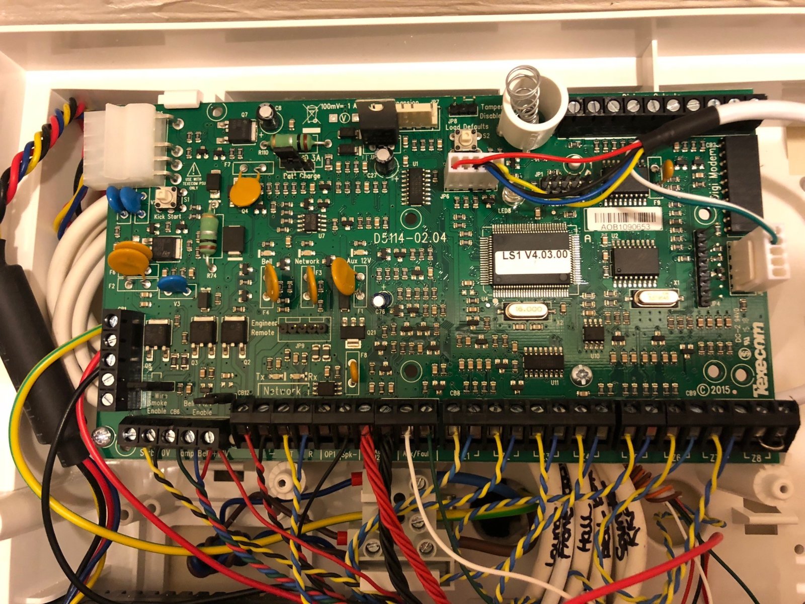

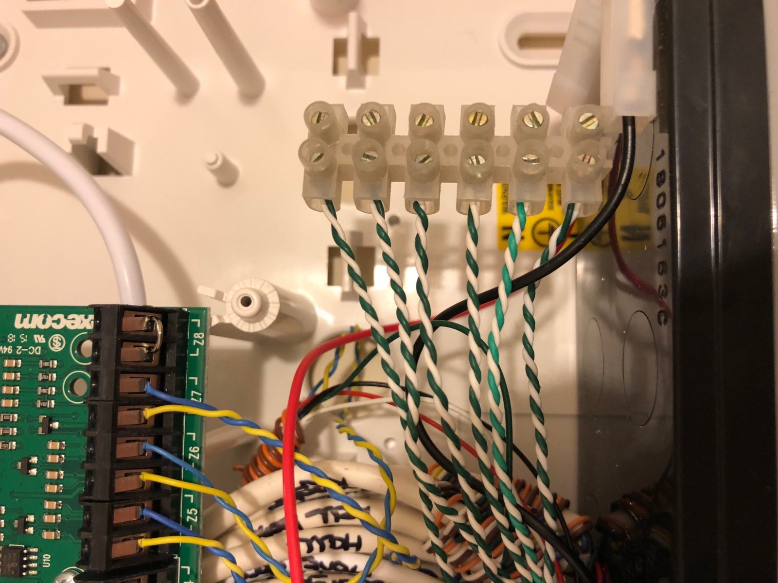

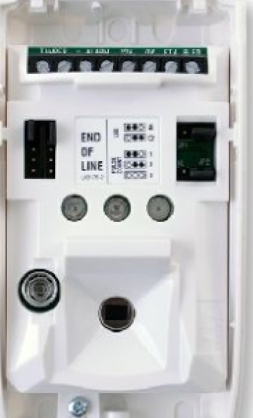

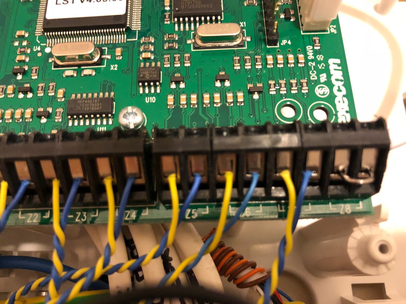

Hello all,
Thanks for reading this post. I had a new alarm fitted to my house last week. I currently have an expensive ornament and before I seek another professional to get it sorted I am wondering if I can get it sorted myself. I am a fairly technical person and class myself as a fairly competent DIY guy. I have no prior knowledge of alarm setup so please be gentle.
System comprises of the below.
TEXECOM CAA-0026 - Premier Elite 24
TEXECOM CEL-0001 - Smartcom
TEXECOM DBD-123 PREMIER KEYPAD
TEXECOM PREM.ELITE PIR PETWISE AFL0001 x 1
TEXECOM PREM.ELITE QD PIR AFF-0001 x 5
CQR SC517/WH -Door contact from Alert Electrical
External Sounder
As soon as the Alarm is powered it shows all Zones are in Tamper, now I have read a bit about EOL and I believe that's how they are setup but if someone could confirm it? I don't think the door contact is EOL or the Pet wise PIR. I have managed to get the Smartcom setup and I have Wintex installed and connected ok but not entirely sure what needs to be done to the Zone setup to tell them how they are configured.
If anyone could point me in the right direction of what needs doing it would be appropriated.
Thanks for reading and help is appreciated.

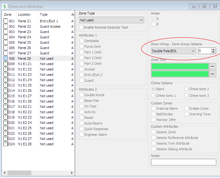

Hi mate, firstly, I too am a total novice but managed to install a premier 24 myself so I know a little bit but nowhere near as much as some on here who I'm sure will easily sort this for you, I just think it's a settings issue. All I can say is try changing the zones from Double pole/EOL to Normally Closed. It looks to me that the tamper system is wired the traditional way not EOL. If you have paid for this install though, they should be fixing this. Not done one before isn't an excuse to fob you off. Keep us posted :)

I know the zones need setting up so I will try Normally Closed to see if they come out of tamper. I was hoping it was wired in EOL as the little I have read on here that is better and if the panel is capable it makes sense to get it setup that way.

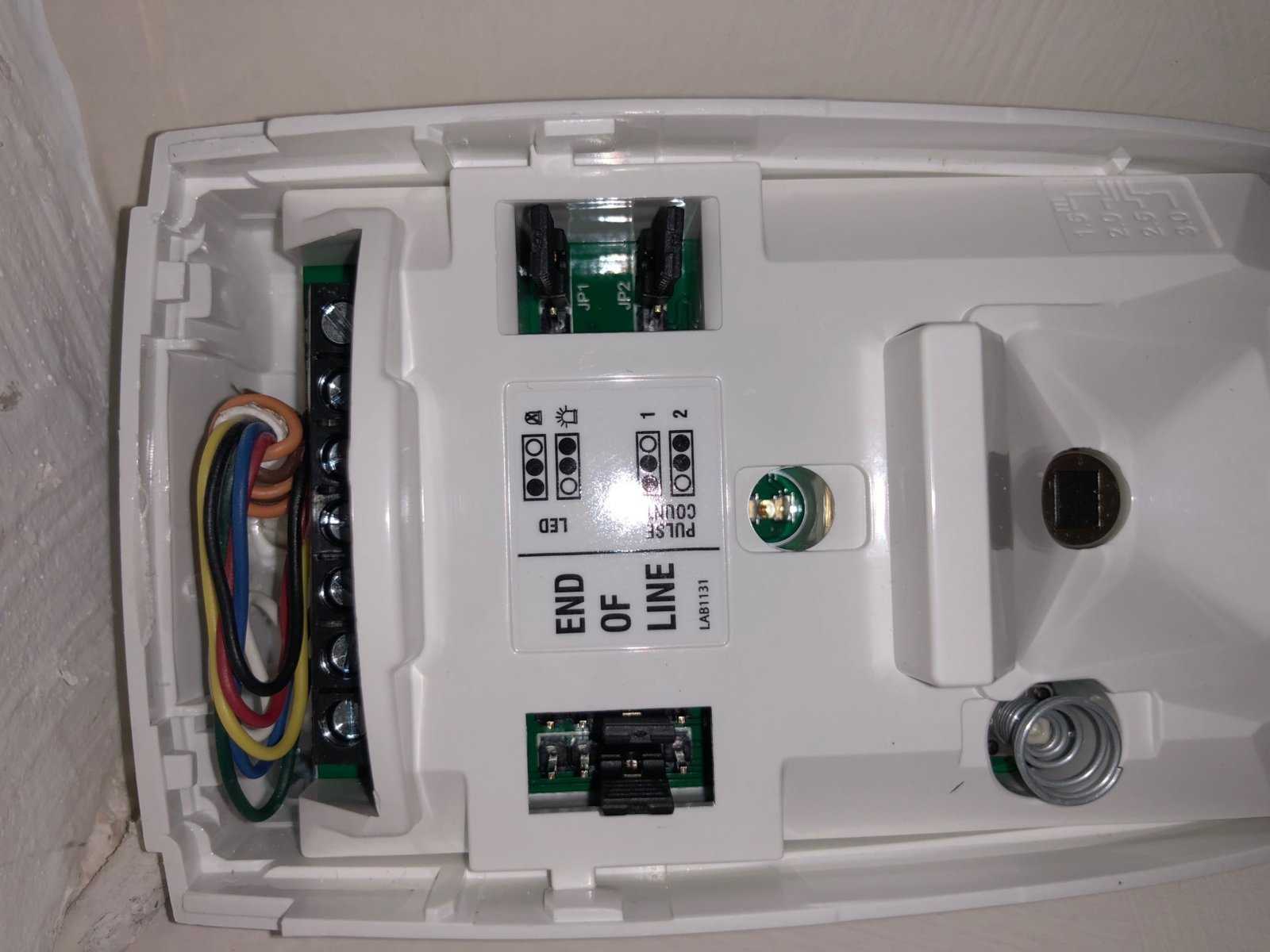

Firstly you have wired the pirs to the panel correctly, the blue and yellow cores.
The PIRs should be wired first alarm last tamper only with blue and yellow based on the alarm connections.
The jumpers selected for 4k7 alarm 2k2 Tamper/ EOL
The wiring type should be double pole EOL in zone setup.

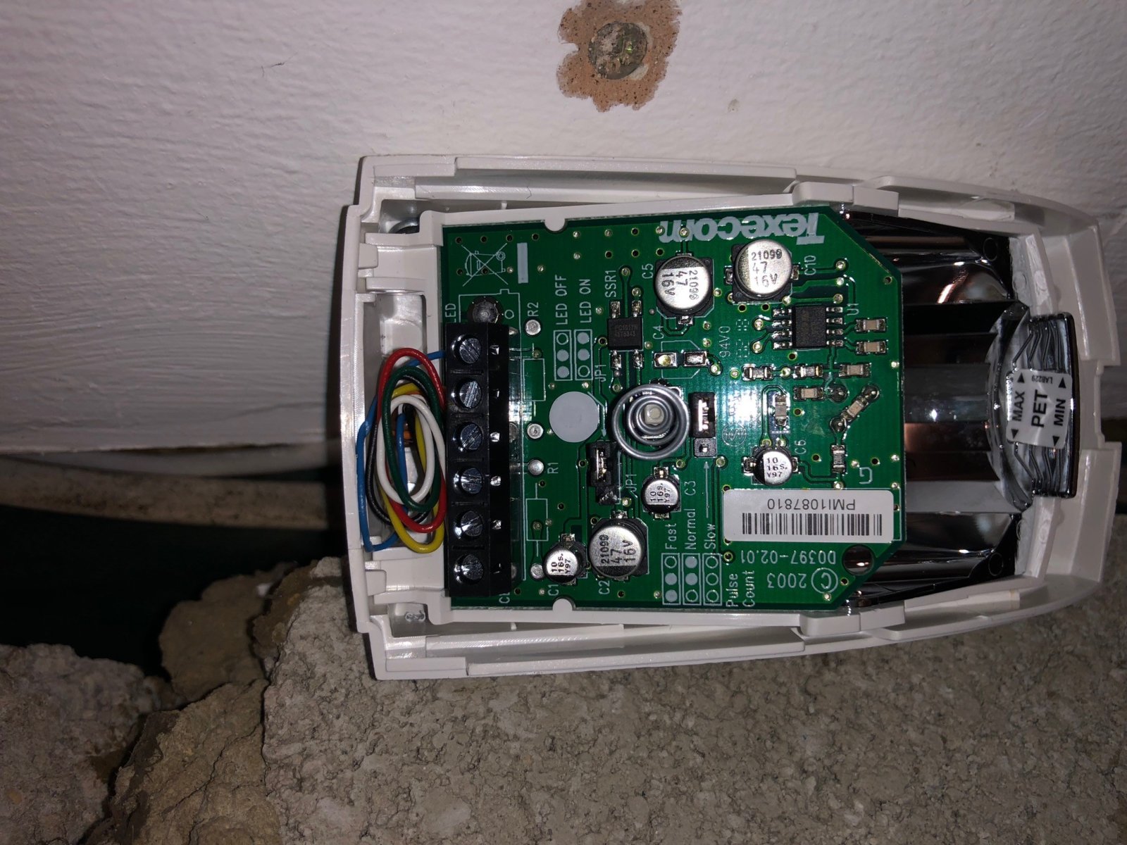

Can I ask why you have 1 petwise sensor?

Thanks for the reply!
So the panel is correct and the pir's are correct? I only have one pet wise as it is in the garage which is attached to the house which has an up and over door and I was advised it would be better than a standard PIR.
I am looking at contacting them, I just want to get it sorted first. No unfortunately he wasn't the cheapest!

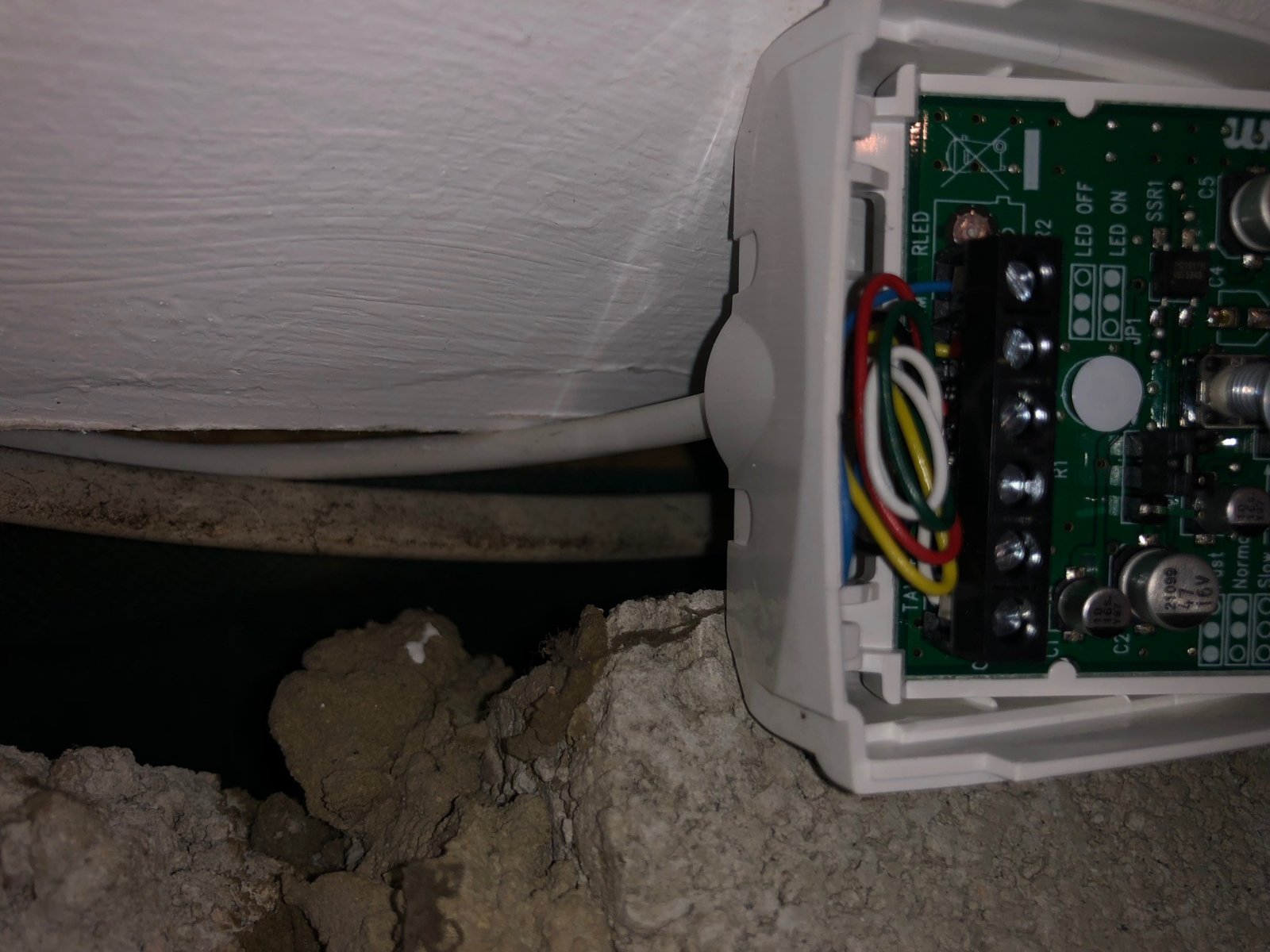

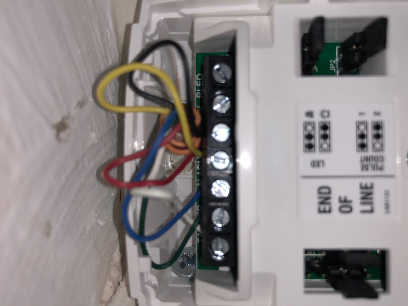

no the PIRs are not correct at the PIR end I see six connections.
PIRs correct at panel end if you move wires at the PIR end.
2 power (red and black)
2 tamper (white and green) remove these.
2 alarm (blue and yellow) move the blue one to where the white was in PIR 2 picture.
have to check the jumpers for the resistor selection as I cant make out which pins they are on, this is covered in the manual.
A petwise sensor isn't something I recommend as they are designed to ignore activations below a certain height approximately 4ft, some detectors are better than others.
A DT is the usual recommendation for a garage or conservator not a petwise sensor, although some petwise sensors were DT's I believe your model is not.
A standard PIR is unlikely to pick up a small cat or dog if the don't jump up or climb, cats are notorious for setting petwise sensors off, in kitchens and living rooms and on the stairs, because they get above the cut off height.

I am going to change the Pir's wires as per you suggestions tonight but could you tell me the position of the jumps should be for EOL from this pic?
Many thanks!
