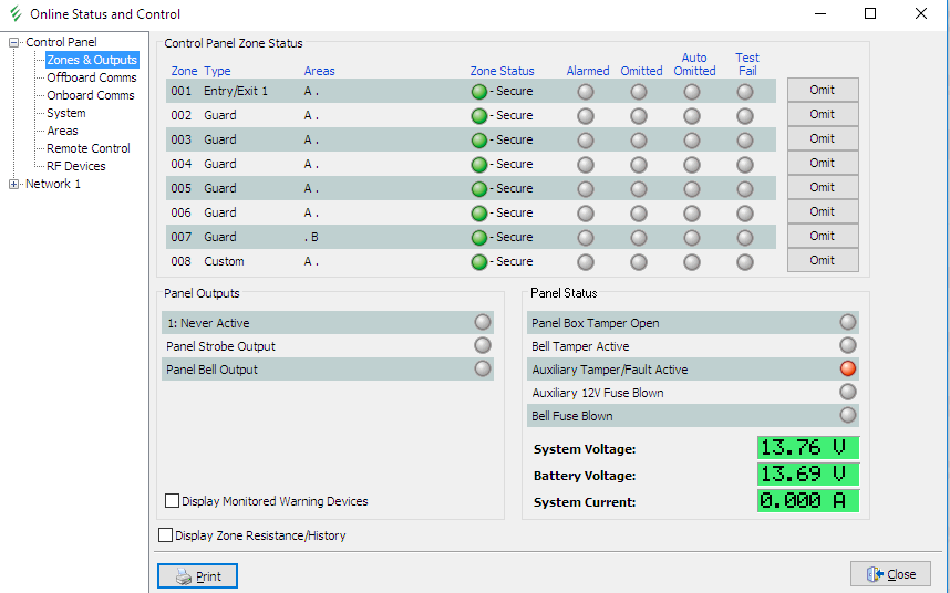

I do have one question though, I have a couple of system alerts that I can’t seem to work out how to clear. I done a bell test when the battery jumper wasn’t set so I believe the one Aux tamper alert is that but how do I clear system alerts? Also Zone 8 is not used and set to not used but it has a tamper. I tried to remove the loop pin from the Board but makes no difference. Any suggestions?
Thanks once again, your help is much appreciated!
Okay if its programmed as not used it wont show other than in wintex, you can program as normally open if you wish for zone 8 so it shows up as secure if nothing is wired into it, if the loop is in program as normally closed, unless the loop is a resistor which I doubt but have seen it where 2k2 resistors have been placed in the zone.
the aux tamper may have been wired up as a global tamper circuit, place a link in Aux/ Fault Terimnals (NOT AUX 12V and 0V).
Open sorted Zone 8, thanks!
Not entirely follow on the AUX Tamper. How do I place a link?
Thanks!
Typical IT person ....lol .... small piece of cable ....strip both ends ....put one end in one side of the tamper terminal ....screw down with screwdriver ....now put the other end in the other terminal and repeat ...
Doh, way off the mark there wasn’t I! I assumed it was a wintex change! :-(
Perfect explianaton for me! Thanks!!
