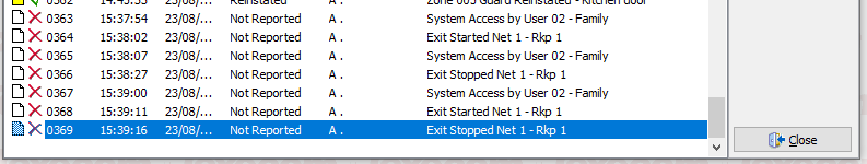

I just tried it from the keypad (with the internal door open) and the alarm went off. Log just says exit started and exit stopped, and doesn't even report that the alarm was triggered.

What does it say in the event log as the sequence of events?

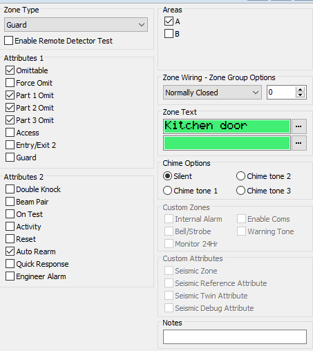

The internal door in question is programmed as below. To activate the part am I am pressing the 'at home' button after entering the user access code. The keypad then asks me if I wish to part arm [part name]? So I press Enter.
The event log doesn't really give me anything to go on...
It must have armed as the alarm went off when I tried to set it. As I noted above, I am part setting by entering the user code and pressing the part arm button, where it asks me if I want to set part arm, and I press OK to set.
part arm 1 for example at default is programmed as evening arm.
when you enter your user code, press part arm you should be presented with
Do you want:-
Evening Arm (or if changed whatever part arm 1 text has been changed to)
You would press yes or tick to start the arming process.
The system would set by timed exit for part arm unless part arm instant was selected in area options.
Thanks for your help, much appreciated. Yes, I’m arming as you describe, but the arming appears to be instant. Part arm instant is not enabled in area options. However, in area arm suites, there are two suites listed, both are set as Timed exit, but have no areas assigned to them. Is this correct or should I be assigning the areas to these and setting them as Entry/exit?
EDIT: OK, it seems the alarm isn't arming, it's just an arm fault causing the internal sounder to sound. I think the arming fault is because the sensor on the omitted door is active. This is strange as I would expect the part arm to ignore this sensor as it is omitted.
