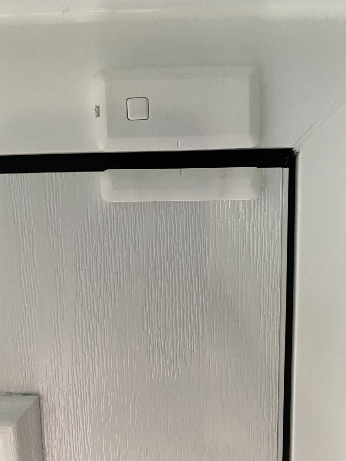

Hello, apologies if I don’t use the correct terminology, with the current corona virus situation we are unable to get some out to look at our alarm.
We have a Texecom premier elite alarm system and recently had our front door changed. Since the change we have been unable to alarm the house using the keypad, it beeps to set but once we shut the door it does not activate. We can however set the alarm on the app.
I am unsure if maybe the micro contact needs resetting? Please could someone help me! Thank you.
Check the event log for fail to arm on front door.
Post photo of door contact sited on door

Handyman no - no fails on the event log. I’ll attach photo. Thank you.

you can set via the keypad by opening and closing the door I suspect when you start the panel in exit.
in the event log you would expect to see exit started ????? When using the keypad to arm system. So what’s in the log.

So when we go to set the alarm if leaving the house we enter the code and set it to arm, it makes that long chime until we open the door and close it but the chime doesn’t change to say it’s activated and is still making the noise after several minutes.
I’ve just tried to arm by opening and closing the door but after a few minutes the chime was still going and when I touched the keypad it just asks if I want to cancel exit
Difficult to say, if the tone changes when you open the door it’s registering the door opening.
what does it now say in the log?
enterthe code open close the door, if the code is entered during that period it would ask if you wish to cancel exit
I don’t think the tone changes at all from when I hit the tick to confirm I want to arm the alarm. That alarm stays in place until I cancel the alarm because it hasn’t worked.
The log now says:
EXIT STARTED 1,1
EXIT STOPPED 1,1
I’ve just been on the keypad to view the status of the zones and 001-008 say tamper?
But the rest including the front door say secure.
Zones 1 to 8 are hard wired, your door contact is wireless, so zone status of 1 to 8 are irrelevant if system alerts are not on the keypad
