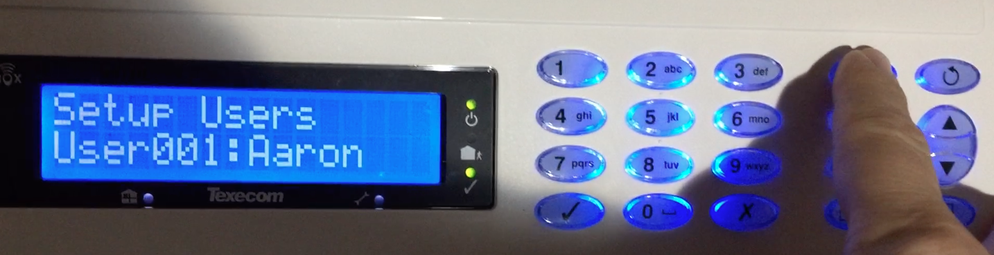

I have 2 Smartkeys to use for myself (setup as master) and my wife (Standard user).
I have seen you can do this setup on the User menu but if I go to the user configured it just asked for Code not Learn like the Texecom youtube clip

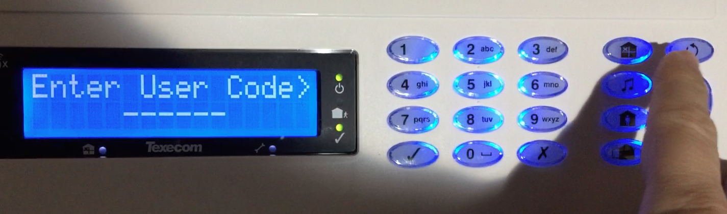

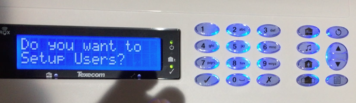

secureiam - That is the exact process I am doing but I do not get ricochet free message it just says Code.
I will take a video clip in the morning.
definately pressing the omit button (picture of house with x) and this takes me to the code page. it wont let me attach video but I have added 3 pictures of the sequence
Does the system need to be in commissioning mode ? I have tried both ways also using engineers and master codes in and out of commissioning mode but still same outcome.
