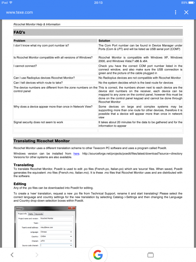

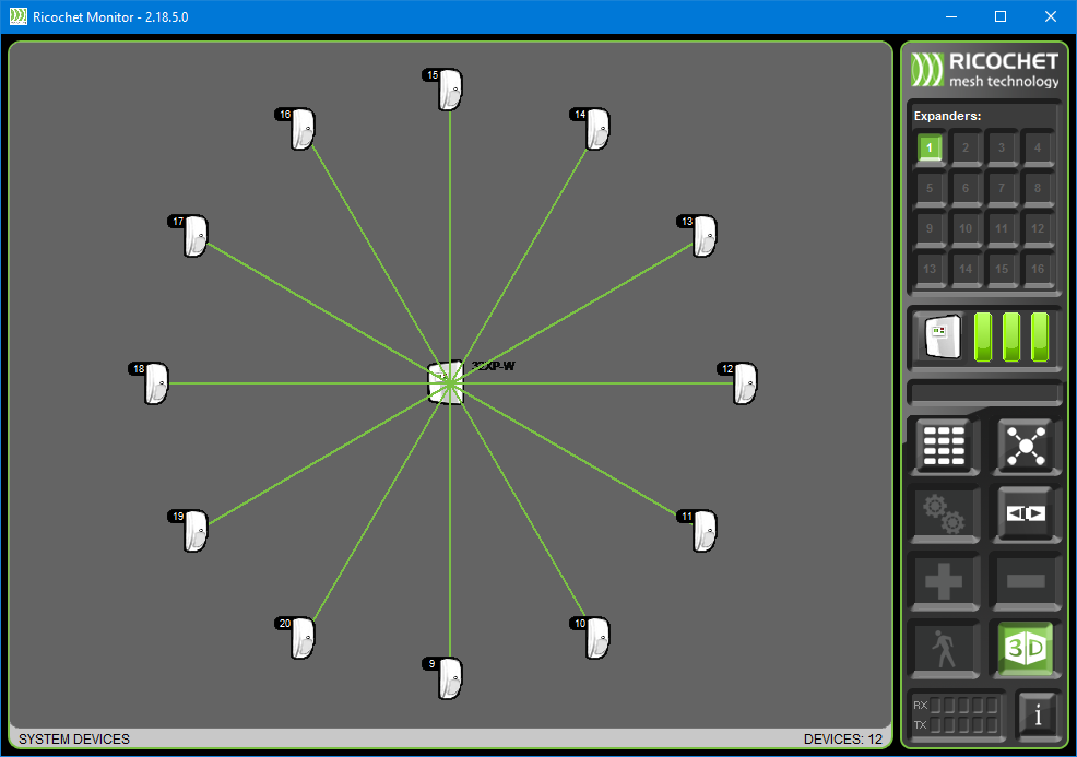

Hi,
I am stalling my Premier Elite 48 panel (v3.0.2) with a Ricochet 32 XP-W expander. I have 12 PIR's which are a mix of DT-W and QD-W. Whenever I use the Ricochet Monitor Software I cannot see the signal security values. I installed the PIRs using the 'Learn Ricochet' menu from the keypad. I have read the instruction for the 32 XP-W expander and it refers to learning devices using the 'Configure Radio' menu. I am now concerned the PIRs have been learnt using the wrong menu which is the reason the signal security values are not displayed.
Is there a difference between learning the device using the 'Learn Ricochet' or 'Configure Radio' menus?

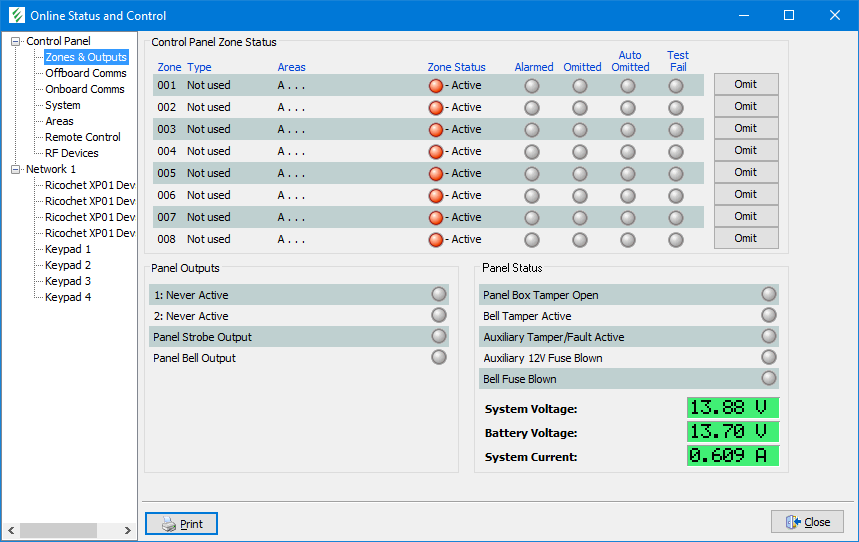

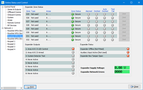

Although the 32 XP-W appears to work correctly I have noticed there is no expander supply voltage shown in the Online Status and Control diagnostics. Is this normal as the voltage and current is displayed correctly for the panel?
