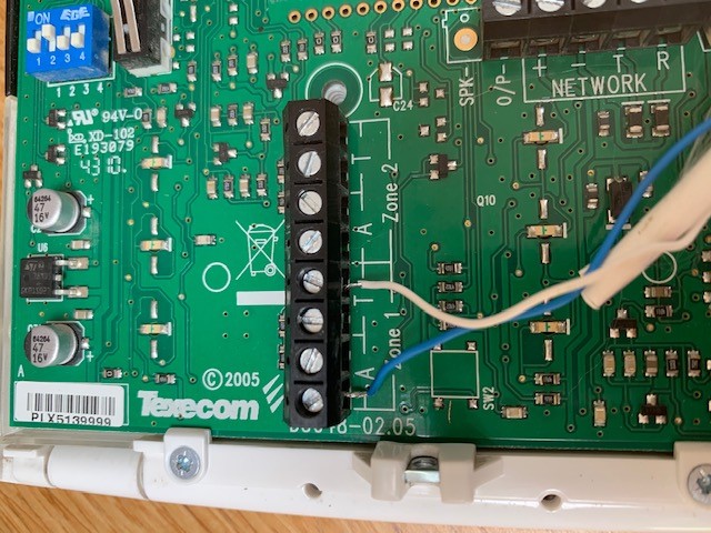

Hi folks,
I have a Texecom Premier 24 panel that i put in a few years ago and am now adding a second wired RKP for the garage - with a Premier PIR and a CQR 517 magnetic door contact to install.
Can anyone advise how to wire these into the RKP's zones to pass through? I just can't get them working - the resistance for the whole extension zones at the panel just jumps up and down constantly or sits at >100K when I try it.

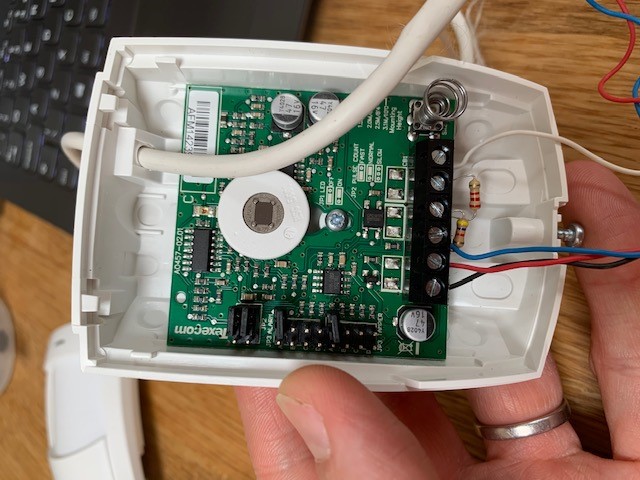

For the PIR, I have put in the resistors and wired up correctly (tested directly on the panel), but just can't work out how to get the passthrough working from the RKP's zones (they're allocated in Wintex to zones on the panel.)
I have tried various combos of the connections, but just can't get it working! Can anyone help?
Images:
  • PIR - wired (hopefully correct, works when directly connected to actual alarm panel)
  • RKP board - (just to indicate the A and T connections - power would obviously be connected... Is this correct? I even tried double pole, but it didnt work)

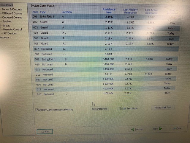

  • Wintex - (zones 1-8 are rest of house... Zones 9 - 16 are expander panel, with Zones 9 and 13 are when the PIR and door contact are wired directly to alarm panel, so we know they work)
Hope the images help
Thanks so much in advance!
try closing the tamper spring?
if no difference, then you will find the resistor selection isn't correctly shorted
I would take out the physical resistors out and use the built in ones by shorting out the correct pins?
Thanks @secureiam - Unit all closed up as if fully operational when testing... (pic was just to show wiring).
Jumpers - wow - always wondered why i was doubling up - thats how i was told to do it by friend that did his! Now corrected, but original issue remains that when plugged through the RKP's zone, the restistance is jumping all over the place. Wintex shows me when the PIR is active, but the resitance sets off the tamper. When wired in directly to the alarm panel, its stable (as wintex pic in orginal post).

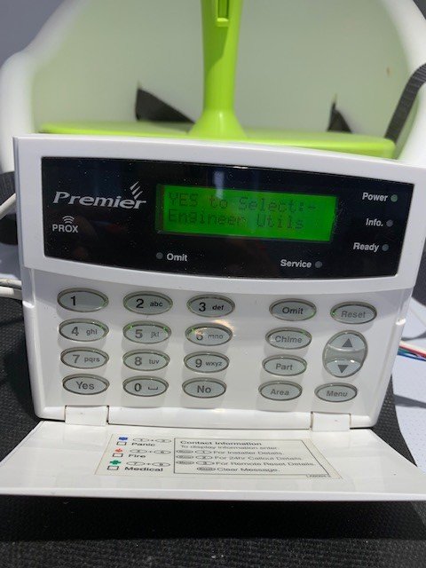

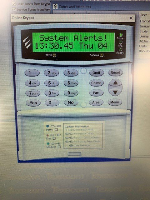

if you look on the wintex online keypad in engineer utilities how does it look for that zone.

Thanks @secureiam
Do you mean this for the wintext keypad?:
which keypad address is the device on: RKP 2
is the keyboard zone mapped: Yes
what zone is it mapped to: Zone 9 (sorry - stupid thing to omit from last post!)
how is the zone programmed all the way through (have mapped it to zone 9 on the main alarm panel, with nothing actually wired in to the main panel zones themselves)

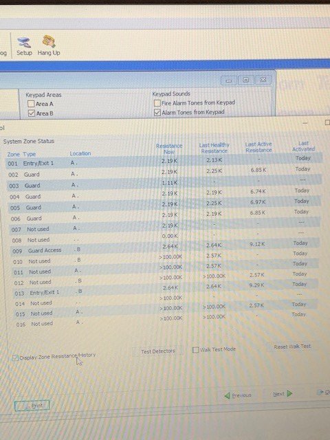

I've just tried wiring it into the main panel again (into Zone 12), just to check it (leaving power from the RKP) and it works perfectly...
do you have any expanders on the systems?
just I see zone resistance on zone 12, if that's the case map the zone to 24, the last zone on the system
yes the online keypad makes it easier to deal with if your messing around with the physical one

so you have an 8XE? so that means you shouldn't map keypad zones to 9 to 16 as it will try and read both and it wont be happy.
Amazing! Thats resolved it!! You genius, thank you so much!
My zone 1 is mapped through RKP 1 and never had an issue, so i was just replicating that setup with RKP 2, but as you say, this time through an 8XE. You've saved me many more frustrated hours!
