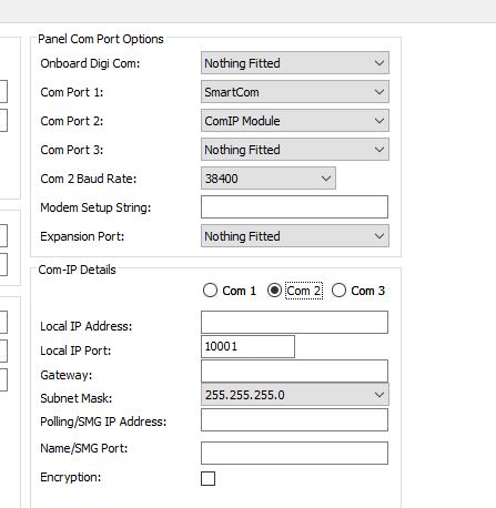

The Smartcom is connected via ethernet straight into my network switch and getting DHCP IP address, I can ping the device.
Im actually
going backwards now as cannot connect to the panel using Wintex wireless like earlier, I played with the port details on Com 2 and now cannot access but still can access using USB cable.
the best thing to do at the minute.
is turn off the smart com and comip via the keypad in comport options, disconnect the cables for the smart com to the panel, clear the ip address assigned for the comip in setup modules ip settings, effectively doing a complete restart.
once its all off, connect the smart com and comip back up and and reprogram them back on including the texecom connect settings, make a brew, then check the ip details have populated.
If they have you should be able to generate a code, setup a new wintex profile. and try and connect.
I am around if you want to pm me, but may not respond immediately.
ok strange thing, now working and all i done was enter the details back in..
