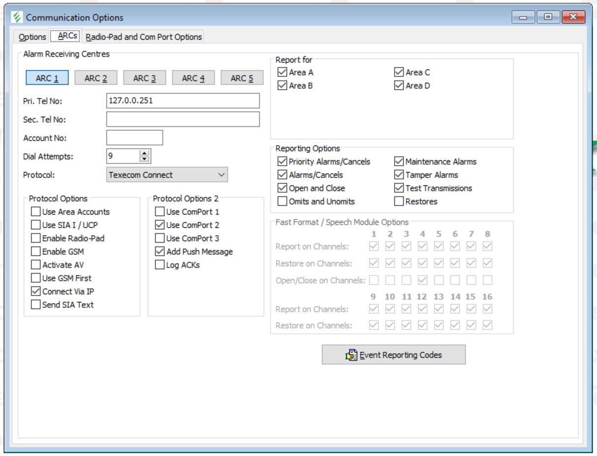

I am able to successfully generate an app code from the keypad however when arc 1 is configured as Texecom connect the panel periodically shows “ATS failed”. Additionally, when using the app code it doesn't seem to work.

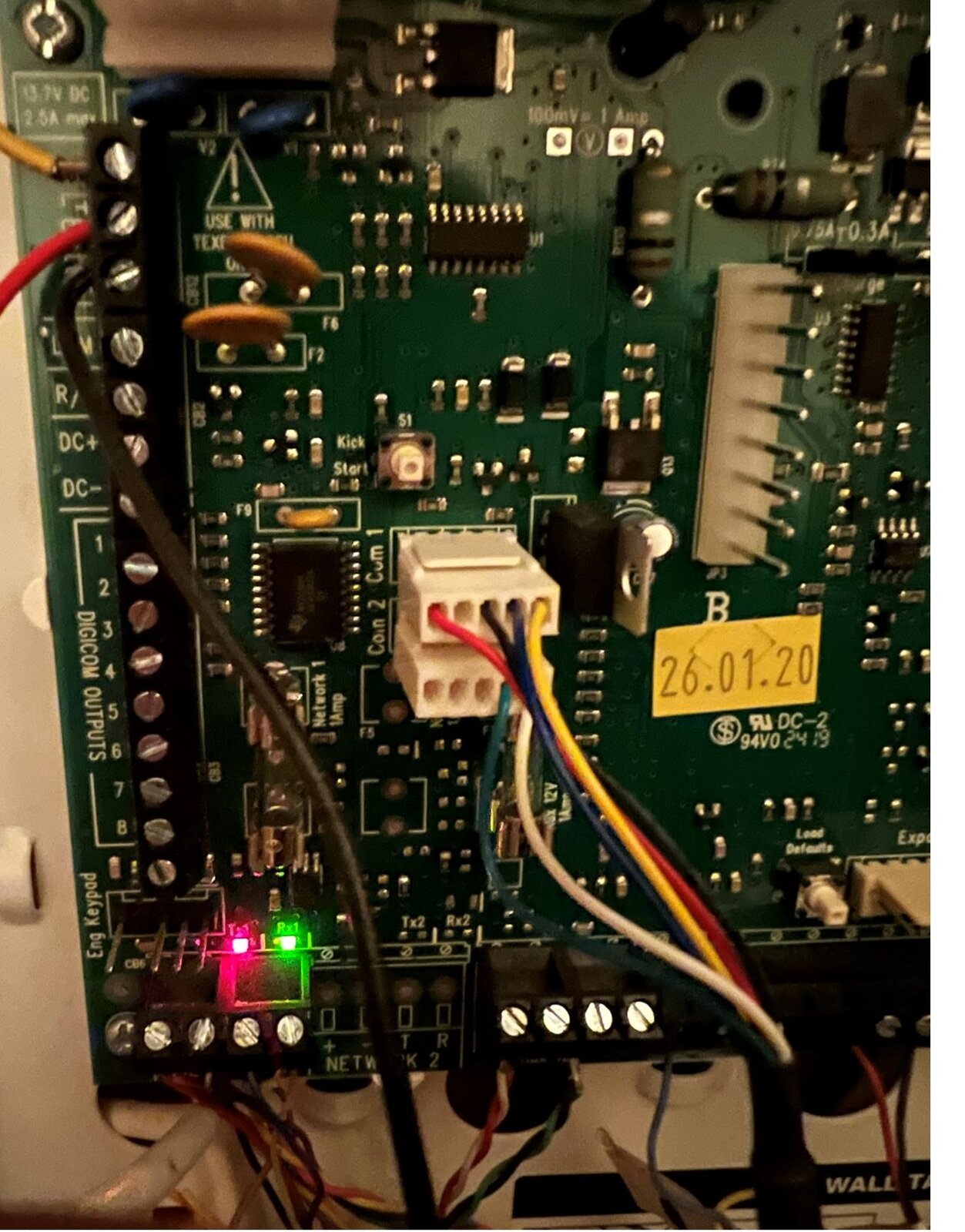

The smart com 4 pin lead is connected to the panels' com 1 and the 2 pin lead to com 2; the internet connection is provided via WiFi.
On the smartcom device the LEDs are showing as; Cloud - Flashing, WiFi - solid on, Ethernet - off, power - solid on. In the router control panel, Parental controls are not configured and the 'texe_hub' device shows as connected to the network with internal ip 192.168.1.146 (dhcp).

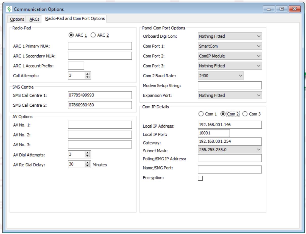

I am able to connect to the panel through Wintex connect via ip but not by Smartcom the current comms configuration is shown below
wintex-com-port-options-jpg.270777

Thanks for the suggestion, I have changed that setting now but still get the same errors when trying to use the app code.
