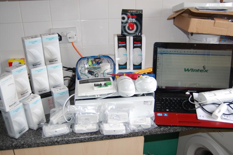

Please tell me those aren't the contacts you're planning on putting on your windows, Lee? They're bloody massive! lol
thanks for your info scott, no lol they aint going on the windows, yes they are quite big as they are grade 3 with all the eol stuff built in, so will be used on some internal doors, and all the doors on the out buldings.
i have alot of windows and i mean a lot, all of the down stairs windows will be covered with shock sensors, once i decide which ones to use and research them some more.
