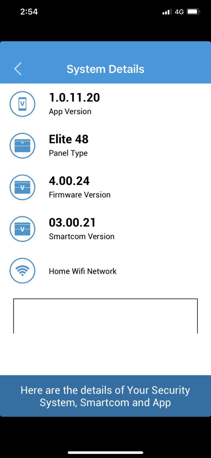

Firmware version 4.00
That's the panel firmware version, not the wireless expander firmware version. When did you buy the wireless expander, new ones since mid 2017 should have the correct firmware.
