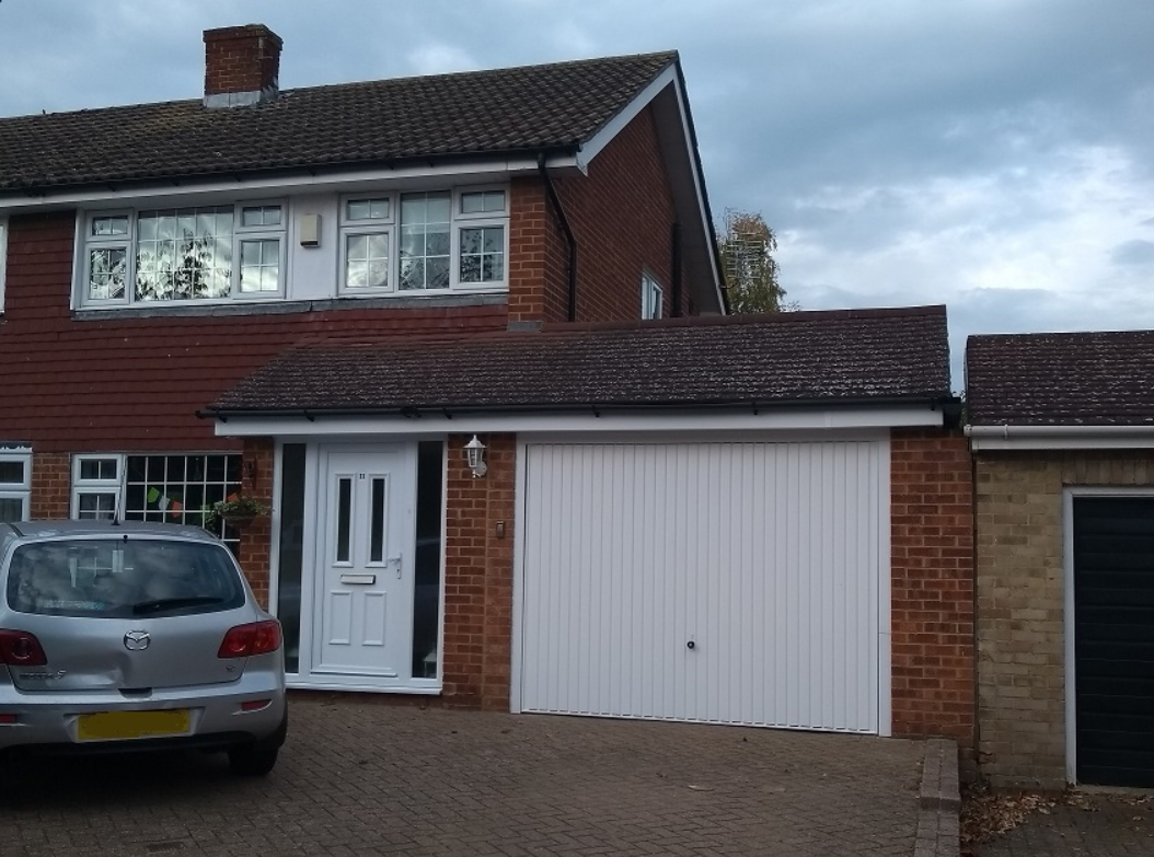

Thanks. Obviously I am looking into this in far too much detail but do the architect and structural engineer organise the inspection and digging of the holes?
Yes they would. These holes are dug by groundworker companies as a rule and I think it costs around four hundred pounds.
I don't think you are going into too much detail atall. Yours is a tricky one in that if you don't plan it properly you could end up in a pickle.
These holes can be dug by anyone with a shovel. Costs will depend upon access, ground conditions, how deep the existing foundations are and to what extent the customer wishes to make good (patio slabs, tarmac etc).
The OP could dig the trial holes themselves. If they are not sure what they are looking at I'm sure if they posted some photos here, between us we could give them some idea whether the garage foundation is sat at the same depth as the main house foundation and whether the ground will have adequate bearing capacity to take the new first floor extension.
Thanks guys may take you up on that offer.
Had someone round this morning to look at doing the building regs. He said you wouldn't be able to build off of the flank wall as it is only 130mm of block work. He suggested small steel piers.
Is that accurate?
