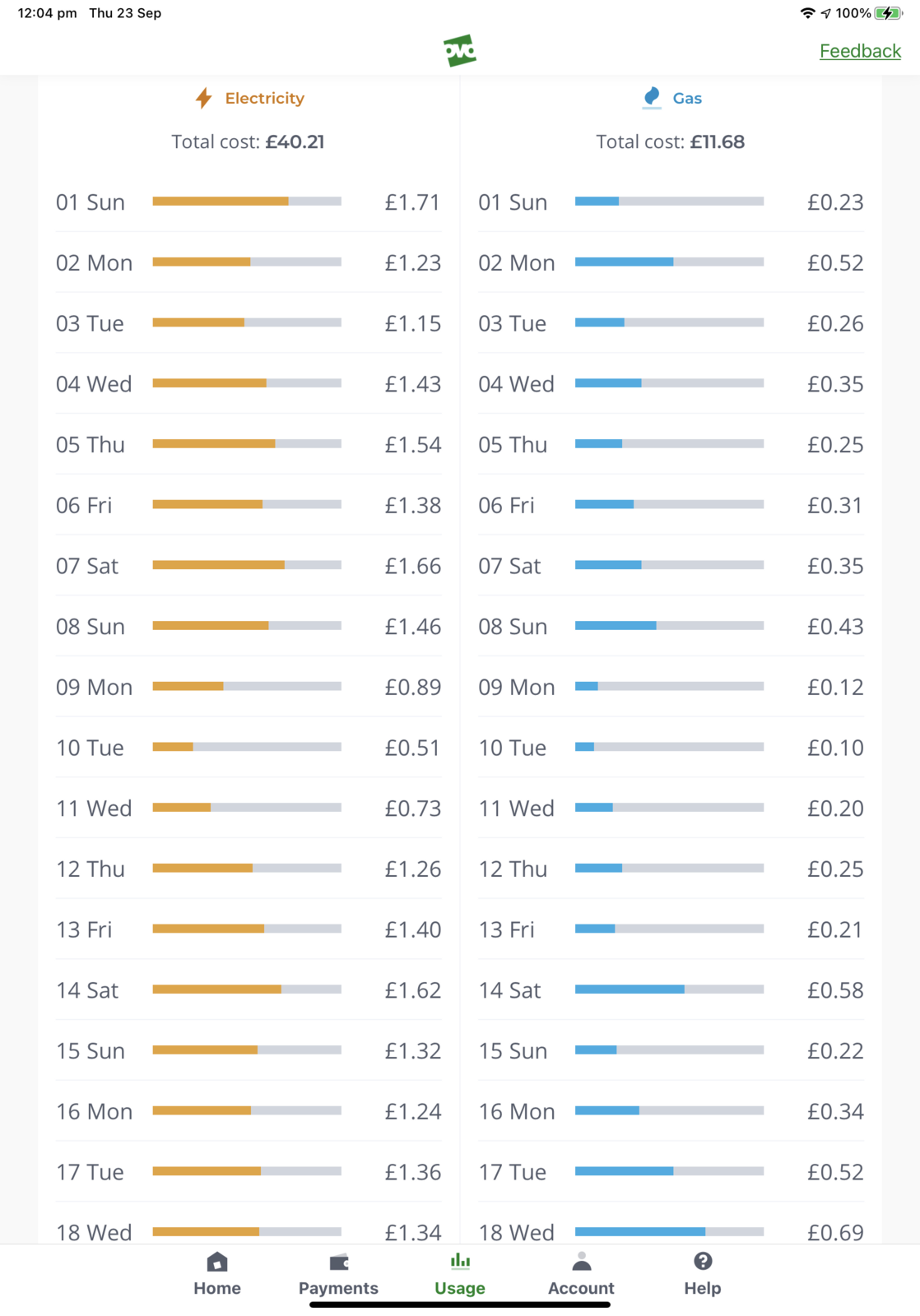

We cook on gas and we both have a longish shower each every night plus the odd sink/basin of water for washing up and washing and our gas costs when we are not using the heating are not much at all. We have a conventional system with a 150L hot water cylinder (not a combi).
This is our daily cost for use in August - the amounts in excess of 50p are probably when Mrs Mottie has had a bath instead of a shower.

These are my numbers collected last Sunday for the week, including the standing charges - E / G / W
19/09/21 / 90 £3.83 53 / 53 £8.33 / 1.754 £6.45 Total £18.61
