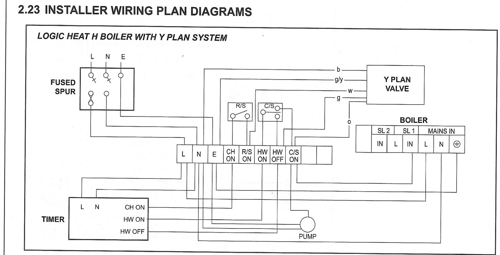

The forth wire on a Ideal Logic 18kw Heat Only System Boiler
I beg to differ, but only slightly. The circulating pump is [edit: should be]wired directly from the boiler.
[edit 2: there is confusion in the title; a heat only boiler is not a system boiler, and vice-versa]
you can beg to differ all you want, and I assure you I know the difference between a heat only and a system boiler, OP has a heat only boiler, look at page 37 diagram 2:23 the wiring diagram for Y plan with this boiler, you will clearly see there is NO pump over run and the pump live is a switched live from the mid position valve
https://idealheating.com/uploads/documents/logic-heat-h-installation-and-servicing.pdf

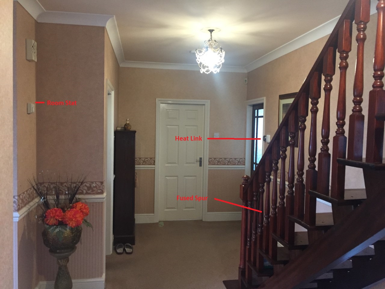

what is this cable and where does it connect to ?
Sorry for the confusion Ian, I had viewed it on my phone and hadn't seen the red circle ... the grey flat twin is the wire from the original room stat in the hall ... I intended leaving it there in case it ever went back to programmer and room stat.

is the other end of this cable near the heatlink ?
No Ian it's in the hall but a distance away ... it doesn't pass down the same wall as the Heat Link and the main fused spur is on.
can you post pics of your loft, showing the boiler and anything electrical near it, same with the wiring centre, that is an unusual place for a fused spur

When we moved in 30 years ago it had hot air heating ... with a floor to ceiling boiler and a what seemed like a 24" diameter fan. During the changeover it would have been a convenient place for the fused spur, straight up the wall to the programmer then up into the loft to the Honeywell Board at the side of the hot water cylinder and the pump.
The Ideal Classic gas boiler was a distance away in the garage - It had replaced an Anthracite Boiler which was in a room at the back of the garage ... this was in the good old days when the fuel was supplied free of charge courtesy of British Coal.
There is another fused spur in the vicinity but its for the Emersion Heater.

If you have a logic heat then the switched live comes from the 3 port valve, this brings the boiler and pump on, the permanent live is there for when the call for heat is satisfied the fan over-run can activate and cool the boiler and store settings, when the fused spur is switched off the permanent live and switched live are both isolated if wired correctly
If a mistake has been made connecting the live to the wrong side of the fused spur I think there was a genuine belief it needed to be "permanently live"

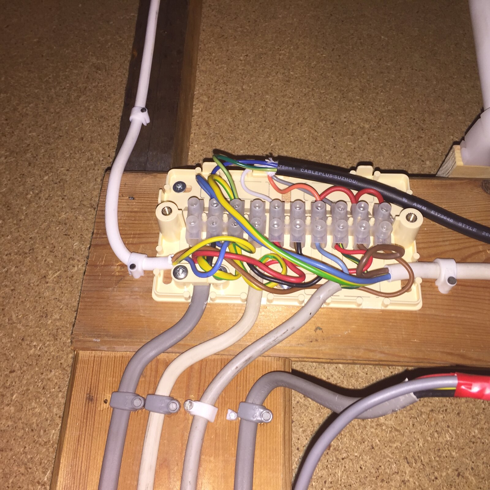

I'm wondering now if the fused spur is all it appears ... why would there be 7 wires in it plus earths?

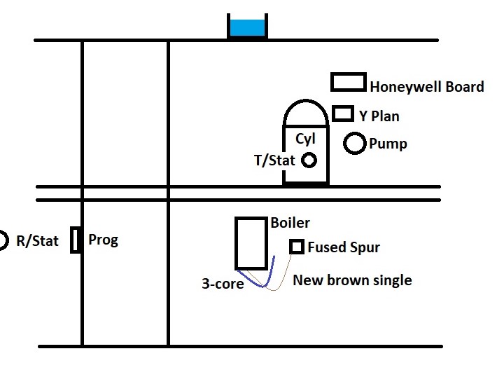

I had thought the three core cable to the boiler appeared to be coming from fused spur but may be it was coming down behind the plaster from the Honeywell box in the airing cupboard ... I need to do a drawing to explain .....

Trying to work out what the 7 wires might be in the fused spur, and presumably the 3 core is coming behind the plaster from the Honeywell board

So, if I'm not mistaken ... the Room Stat, Cylinder Stat, Y Plan valve and Pump are only wired to or from the Honeywell Board along with 3 of the 4 wires to or from the boiler.
The forth wire to the boiler comes from the output side of the Central Heating Fused Spur.
The Fused Spur should have 2 wires going in, and 3 wires going out, 5 wires in total excluding earths.
I wonder why there appears to be 7 wires in the fused spur of House Two ?
No the usual way is L,N,E in from consumer unit, and then L,N,E out from the fused spur and connected to the wiring centre, everything else is distributed from the wiring centre,switching off the fused spur and removing the fuse should then remove power to any part of the heating system and controls but I understand why yours hasnt been done properly
