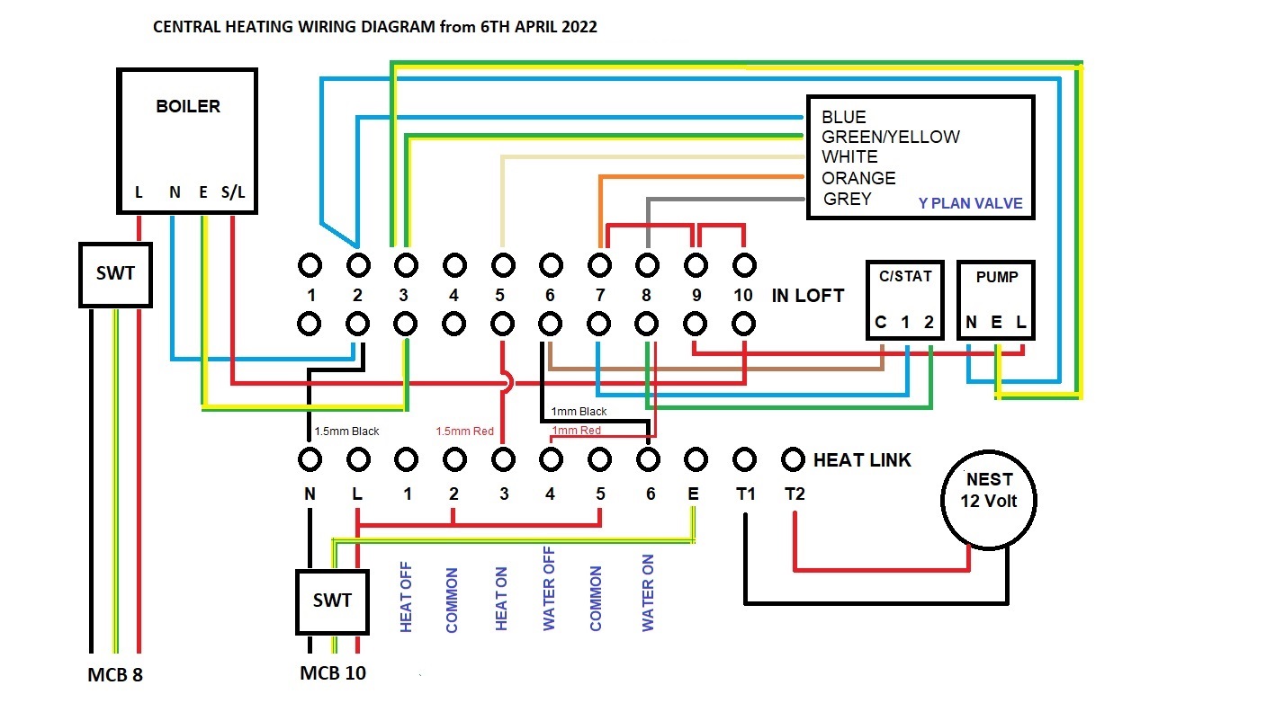

The forth wire on a Ideal Logic 18kw Heat Only System Boiler
I understand Ian, I was discounting earth wires and assuming it would be OK to get the second live from the fuse spur outlet making 2 in and 3 out.

I don't see what the problem is. From your layout sketch the fused spur is local to the boiler, so should be able to run a wire between them. You wouldn't normally use a single-core length of wire, it would look a bit messy, but from any of the junction boxes or terminal strips which has a permanent live. If it's currently a 3-core to the boiler you could change to 4-core for a neater job.

No the fused spur is simply an isolating switch nothing else, just like pulling a plug out of an appliance, you need the permanent live from the fused spur run to the wiring centre, then the switched live is picked up from the orange wire on the mid position valve inside the wiring centre, leave the fused spur switched on but turn the HW AND CH both off at the nest, then test the wires in the wiring centre with a multi-meter and see which ones are live and post up which numbers are
There will be - but I’m hoping to somehow have only one central heating isolation switch.
If I’m not mistaken it involves having an extra wire in the trunking, behind the plaster, from the heat link to the Honeywell wiring centre in the loft which can then be connected to the live coming from the fused spur.

The fused spur isolates the whole system.
Sorry, I meant there are no junction boxes or terminal strips local to the boiler that are covered by the Central Heating fused spur.
this makes less sense with every post, how is the nest heatlink physically wired to the wiring centre ?
As shown on the coloured wiring diagram on page 1 there are 4 wires physically connecting the Nest Heat Link and the Honeywell Wiring Centre.

At my son's house the permanent live is on the wrong side of the fused spur and needs changing for a properly insulated cable and moving to the output side of the switch where it will be included in the isolation procedure. Almost certainly the reason for the the fused spur having 7 wires plus earths is because it's on a ring main.(ianmcd)

Today the "permanent live" has been moved by the installers from the input of the output of the fused spur.
To complete ...
This topic has been a bit confusing as I couldn't avoid referring to two different houses.
Our house had a Ideal Logik 18KW boiler fitted three years ago without a permanent live to power the cooling fan after timed shutdown.
This only became apparent when we had the same boiler fitted at a different house a few weeks ago and observed the overrun procedure for the first time.
The forth wire has now been fitted by the people who originally installed the boiler.
They chose to add a second fused spur to provide the permanent live and marked it as also needing isolating elsewhere.
