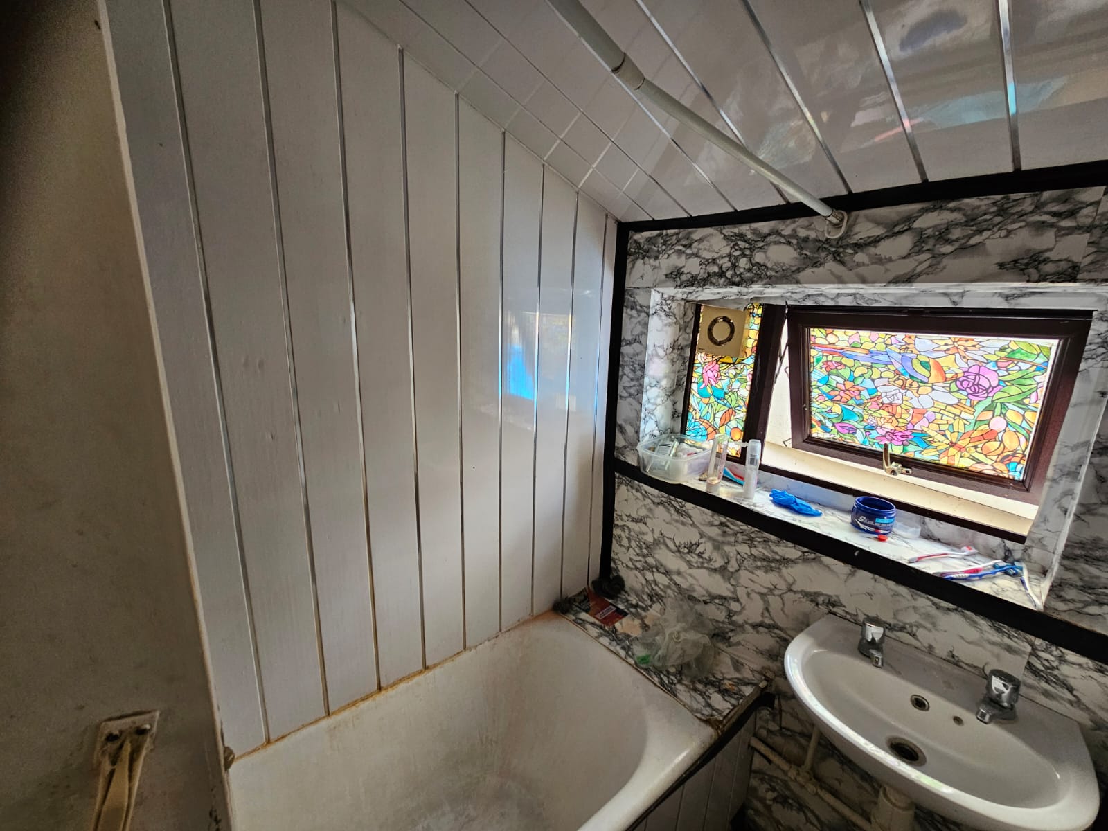

found then but they are for wall mounted, the one i have is window mounted, see pic. is there an alternative

Ahh you fitted it. It doesnt comply with regs now, or back in 2000.
The fan may be suitable for bathrooms, but not everywhere in a bathroom. That position is inside zone 1. There are specific voltage and IP requirements here/ Read this. https://niceic.com/householders/bathrooms-and-electrics/

Zone 1 is directly above the bath. Fan is in a window recess, and the bath doesn't reach the end wall anyway, so even if there was no recess it's still in zone 2.
