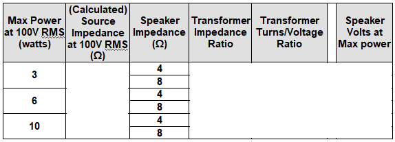

Very easy to understand (albeit there are several different ways of 'looking at it'). However, unlike your microphone transformer scenario, in this case one usually will want to use an (impedance) 'matching transformer', since one wants to optimise power transfer to the speaker.
Fair enough but you are only talking about how one marks the transformer, not what it is doing (which always is 'matching' the source impedance to the speaker impedance, to optimise power transfer) - the only important thing being that the 'power' figures specified only apply to a particular voltage (which I will assume is 100V RMS at full power) (and which I might have expected would be indicated on the transformer!).
Once one knows the source voltage at a particular maximum power, it is arithmetically trivial to determine what source impedance it equates to, and hence what impedance ratio (hence also turns/voltage ratio) is required to 'match' the source impedance to any given speaker impedance.

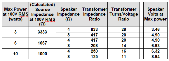

Assuming 100V RMS at full power (and also assuming I can do arithmetically correct in the middle of the night!), the following tabulation shows that for the example you illustrated. In other words, marking the transformer with powers (with an assumed voltage) and speaker impedances is just one way of doing it. The same information would still all be there if the transformer were specified in terms of turns, voltage or impedance ratios - but perhaps some of those who use them would not be capable of understanding that?

I've blocked out the information in your chart that is not required or considered or useful in 99.99999999999% of applications of such a device and as you say; not even understood by a very high percentage of the installers of such a device.
Some of that information may come on a data sheet with the transformer or a device containing it
or may even be printed on a device containing one
But the reality is in the main the the only 'really useful' information is the power.
Fair enough but, as I implied, you could 'block out' different columns (including the two you have retained) without 'loss of information'. In fact, one only really needs one 'column' - either the turns/voltage ratio or impedance ratio to provide 'full information'.
As I think you agree, we are (now) only talking about how the transformer is marked/labelled.
The downside I see of marking the primary with 'powers' is that those figures are only correct for one input voltage (100V RMS in your examples). The transformer could obviously be used with any line voltage, but the marked powers would then be incorrect. As I said before, I'm surprised that does not seem to be made clear in the labelling of the transformer you illustrated.
One could but it would be totally pointless to remove the useful information and replace it with something that would necessitate a lot of complex calculations for the designer/installer of a system

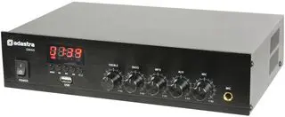

Chances are an 18W amplifier is hard to source so one would aim for say a
40W with built in tuner, that allows for some extra speakers to be added if required, especially for when the summer allows for people sititng outside.
Now it's easy to see these are not 'matching' anything, they are presenting 3x2.5KΩ, 2x5KΩ & 2x10KΩ total 555.6Ω to an amplifier rated at 250Ω and very far from matched.
