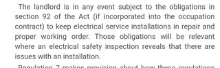

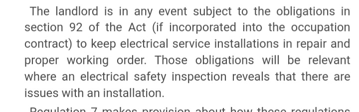

I have been reading The Renting Homes (Fitness for Human Habitation) (Wales) Regulations 2022 and to be frank not sure what it means as far as an EICR goes, it does refer to BS 7671:2018+A2:2022 it says inspection every 5 years, and 14 days to pass over the report, and that
“qualified person” (“person cymwysedig”) means a person who is competent to undertake the inspection and testing of an electrical service installation, and any further investigative or remedial work, in accordance with the electrical safety standards;
But nothing about what is a pass or fail, and how long one is allowed to do the repairs. It clearly means homes must be inspected, but does not really say much about what happens after. Nothing about what code is a pass or fail, clearly dangerous is a fail, no argument about that, but what about potentially dangerous? Or further investigation? if the landlord decides to do only items flagged as dangerous is he clear?
Not specific at all (does it need to be?), but this was also in the notes:

Interesting. Although it mentions BS7671 (inevitably in English) and says that the report produced will be an "EICR", it calls the actually testing a "PIT" (Periodic Inspection and Testing), not even "PIR".
Unlike the English Version it does not say which EICR findings (codings) require (or do not require) remedial action (so some might take it to indicate that even C3s have to be 'remedied'!) and it is rather vague about how quickly the remedialwork has to be done:
In addition, a landlord is also required to provide the contract-holder written confirmation of all investigatory and remedial work carried out on the electrical installation. This written confirmation must be provided to the contract-holder within 14 days of the occupation date. Where investigatory and remedial work is carried out after the occupation date the written confirmation must be provided within 14 days of the landlord receiving this confirmation.
... it indicates how quickly 'confirmation' of investigations and remedial work has to be given, but seemingly not how quickly the investigation/remedial work has to be undertaken!
I don't think I would call this an improvement over the (not really fit-for-purpose) English version!!
