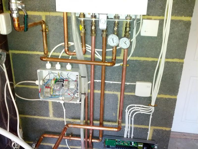

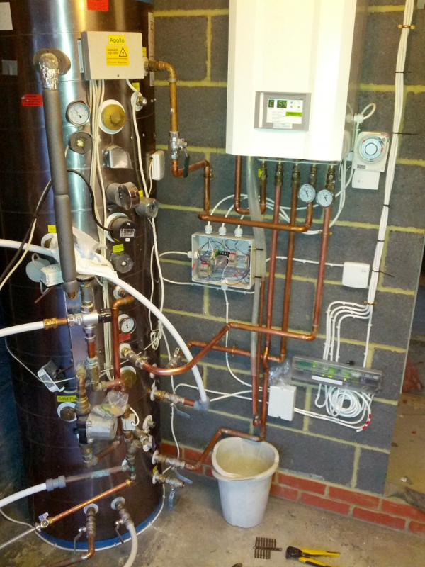

However, my Excel heat bank is twice the size needed (although I am only using half of it) and can absorb pretty much whatever I can throw at it. There are no coils in mine except a separate 1m2 solar coil at the bottom.
Will be considering playing with adding a second plate in series to see if I can reduce the store temp further.
Ignore all the plastic this was a temporary lash up during the building works. Need to tidy the garage up before i get some newer piccies :D
Whats in the tupperware?
Looks a bit over complicated!

Tony - There is no heating coil. The 350lt of water sloshing around the store is the very same water pumped through the boiler, so coil absorbtion rates are irrelevant. Personally, and for the very reasons you've stated, I wouldn't want an indirect boiler circuit. (Apart from the solar coil).
That was the sensor altering rig I made up (remember we were discussing the wiring in the CC). Subsequently found a secret parameter in the boilers PCB software that did it all at a touch of a button :LOL:
Going to be removing it to make space for the condensate pump - getting bored of emptying that bucket twice a day.
