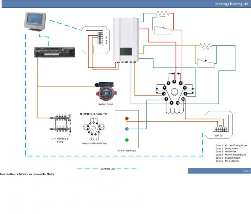

It's an RGI joke we have running in the CC - he is referring t the wiring centre under my boiler.
I was experimenting with varying flow temperatures and could do it with the version of my boiler's PCB. A subsequent upgrade of either the PCB or my control regime (haven't figured out which yet) meant it became irrelevant.
That was the sensor altering rig I made up (remember we were discussing the wiring in the CC). Subsequently found a secret parameter in the boilers PCB software that did it all at a touch of a button :lol:
