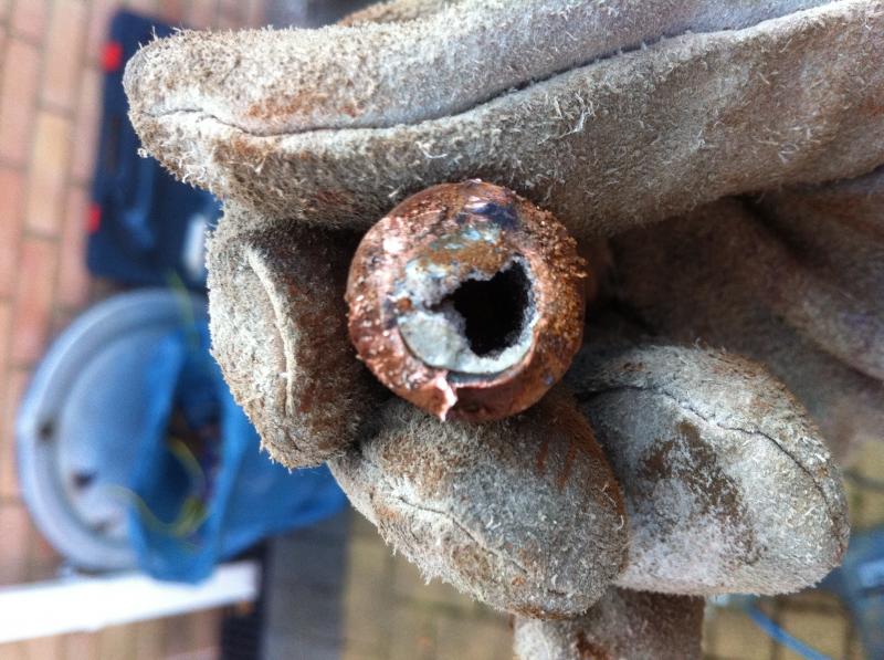

re: plate heat exchangers, your right about your points but plate hes are inexpensive and relatively easy to clean.. scaled hot water coils on the other hand............
This one was about 15yrs old. Obviously a water softener would have prevented this, but thats another £600-1000 +ongoing salt and wasted water costs(if on a meter)
I guess a lot depends on the specific situation. Up here we don't have hard water so it's not a problem - but I do recall when I was at uni always finding sediment in the teapot as the kettle had got so bad the lumps were flaking off. I did have fun descaling that - thinking it was a bit slow and "perhaps a little heat would speed up the process" (electric kettle, add a little heat, ... ) - it did speed up somewhat and was quite an impressive amount of "foam" that erupted out of the top :oops:
Just a thought on descaling ...
Would a dosing pot upstream of the coil work - just add a pint of vinegar, leave a hot tap dripping to let it diffuse through the coil for an hour or two, then open tap to flush out ? Obviously done more frequently that "after 15 years". Or is that too naïve ?
