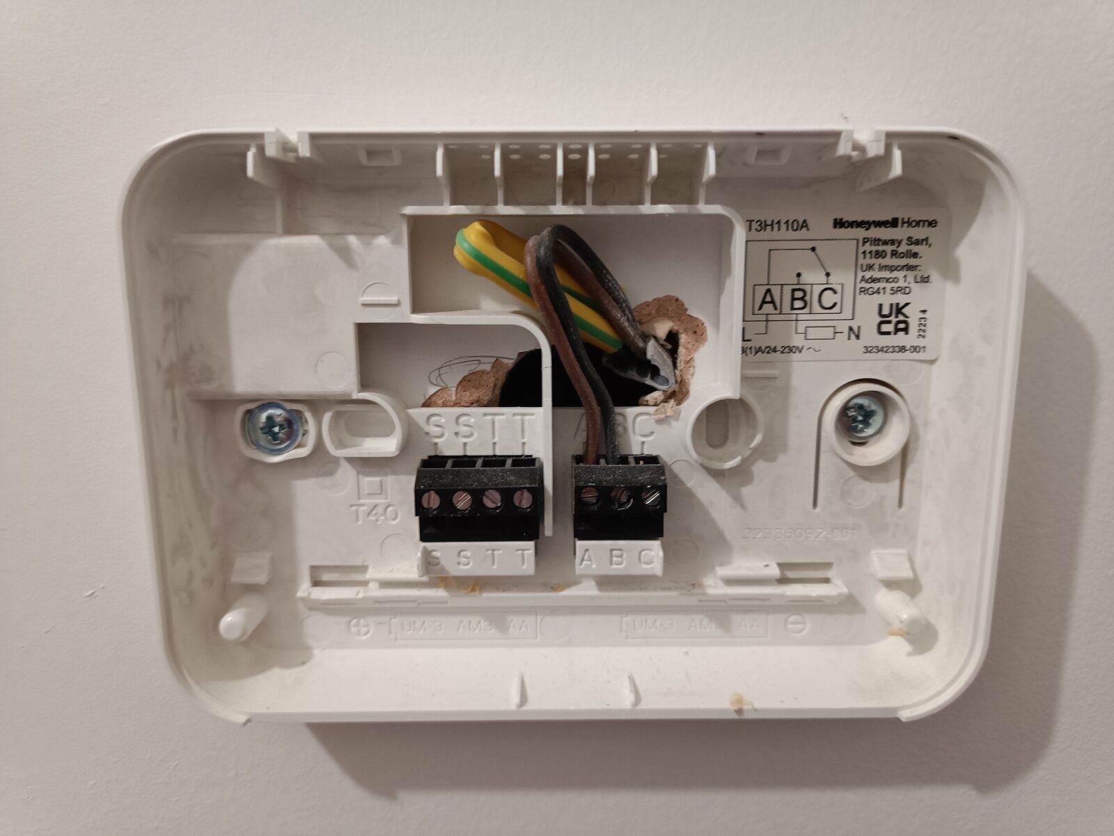

The Honeywell T3 can be battery, or mains powered; posting a picture of the wiring behind it, may help.us to provide further options.
I have attached a photo below. My thermostat also has batteries in it too (2 x AA).
Your Honeywell is a two wire stat.

Another option would be to use the hidden grey wire (in the triple and earth cable) behind the Honeywell. It could be connected to a neutral terminal in the wiring centre - enabling power to the receiver, when mounted in place of the T3.
