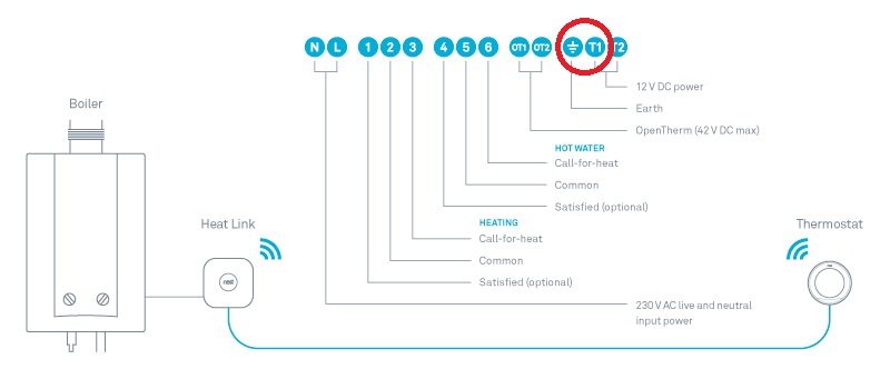

Hi there,
Total novice here looking for advice or guidance on fixing and upgrading my home heating solution.
I've recently moved into a new apartment. It was rennovated before I moved in, and multiple walls were demolished & erected along with a total rewire. There was an existing Worcester Greenstar junior 28i combi-boiler which was rigged up to the new wiring. There is no water tank.
The controller that's been installed is a Horstmann Centaurplus c11 controller, and I'm not sure but i believe it existed prior to the rewire.
My main issue is that the hot water works but the heating to the radiators does not. I believe the source of the issue is that the old thermostat was removed and then the wiring was plastered over. I don't believe the wiring on the boiler was updated to relfect that the fact that the thermostat will never trigger the boiler "on".
From the research I have done the appropriate solution would have been to jump the Live Return and Live Stat wiring ports on the boiler itself, so that it was essentially always on.

Here's a simplified diagram for the Nest wiring
It suggests jumping from live (L) to common (2), however I'm not sure this is needed.
I believe the way to go is to remove the C11 completely, then wire:
C11 -> Nest
N -> N
L -> L
2 -> 2
4 -> 3
Does this sound like an adequite solution? are there any oversights I mightn't have considered?
