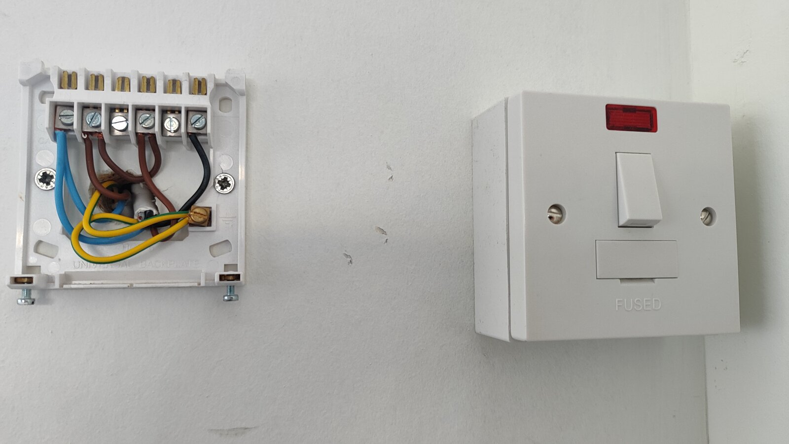

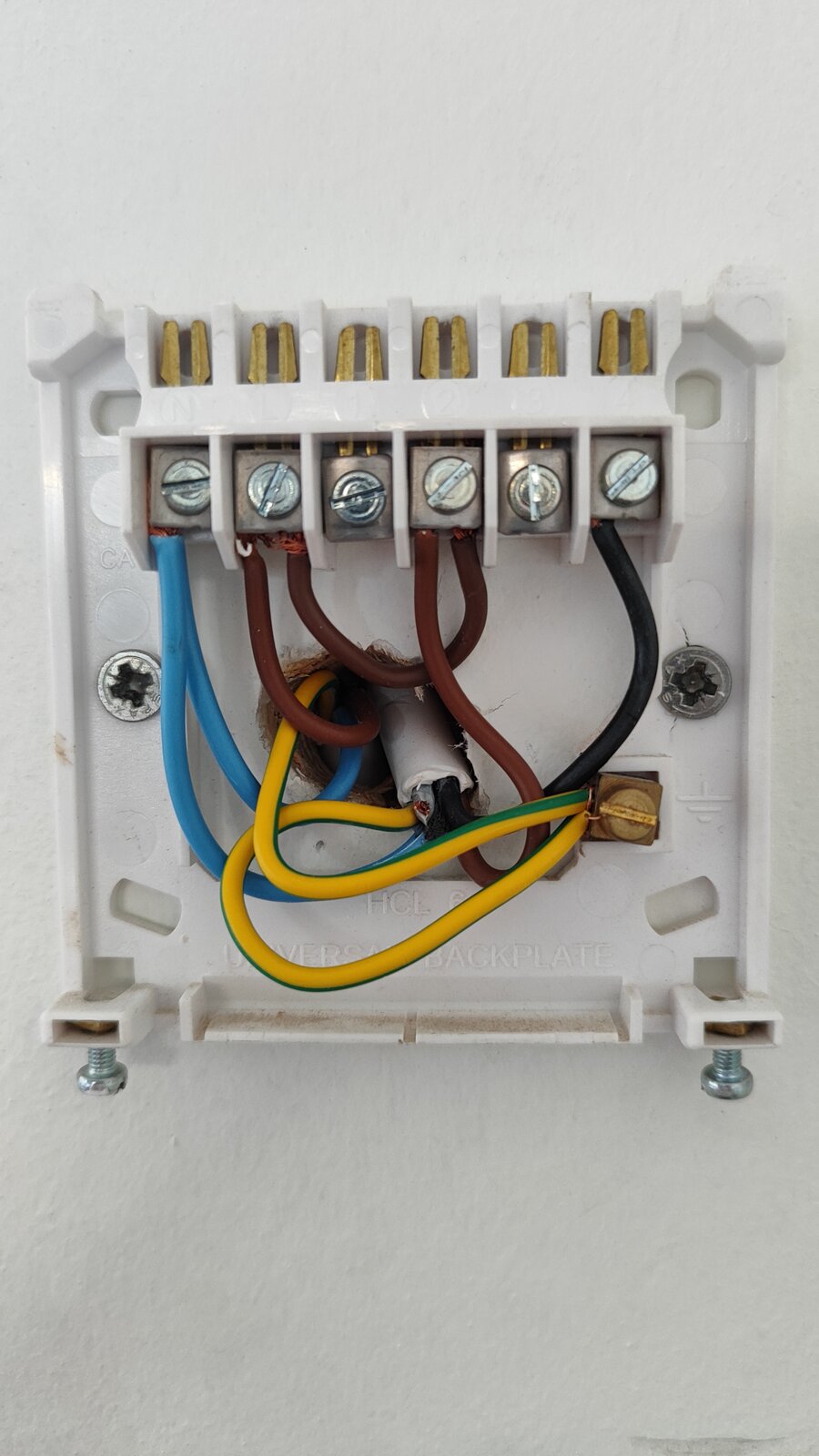

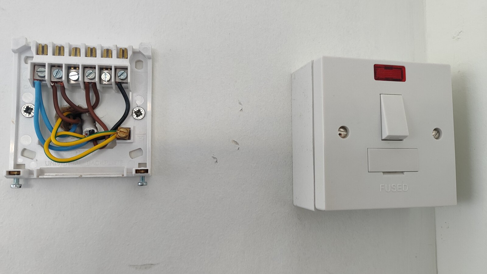

Here's the photo of the current timeswitch.

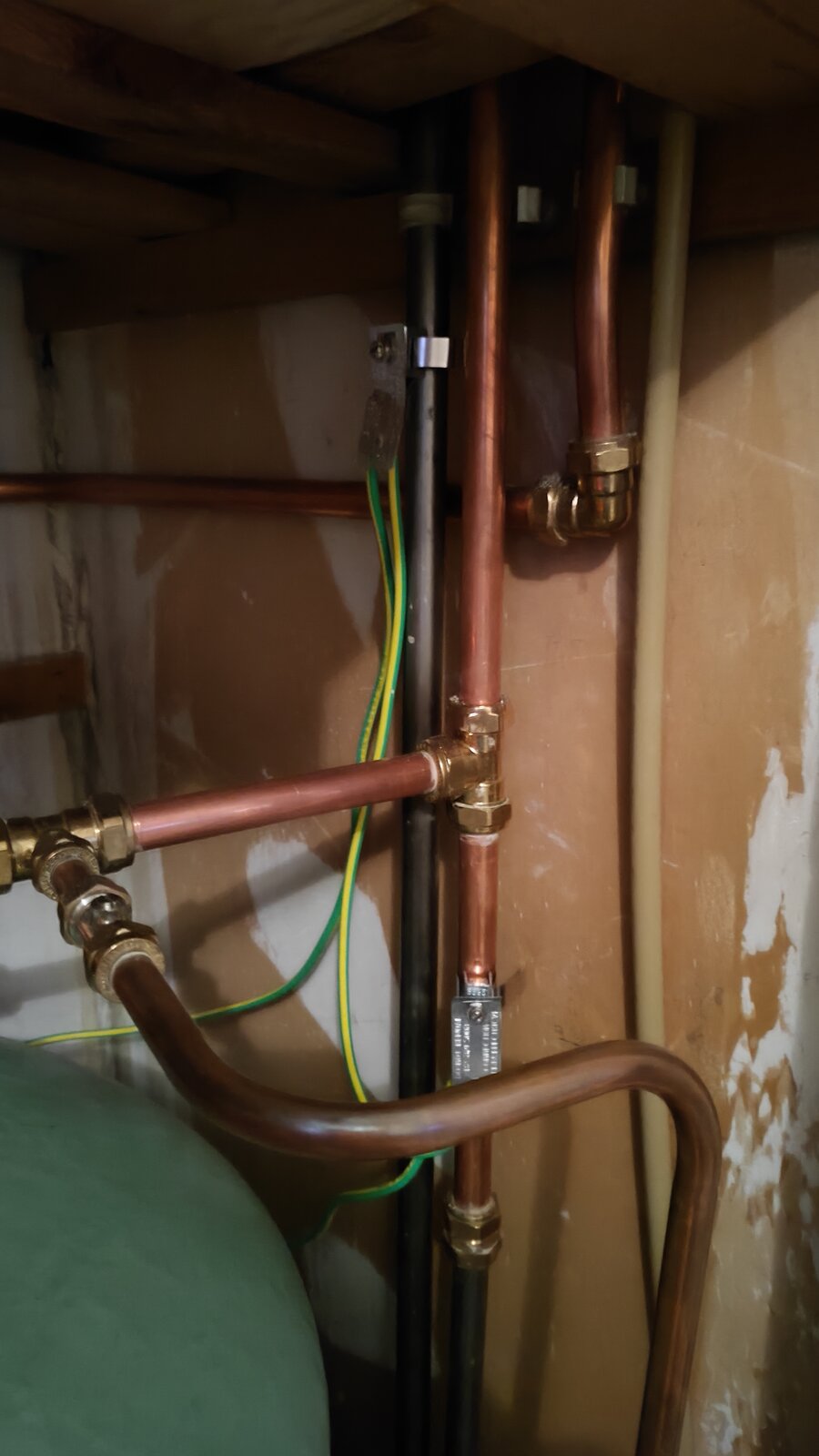

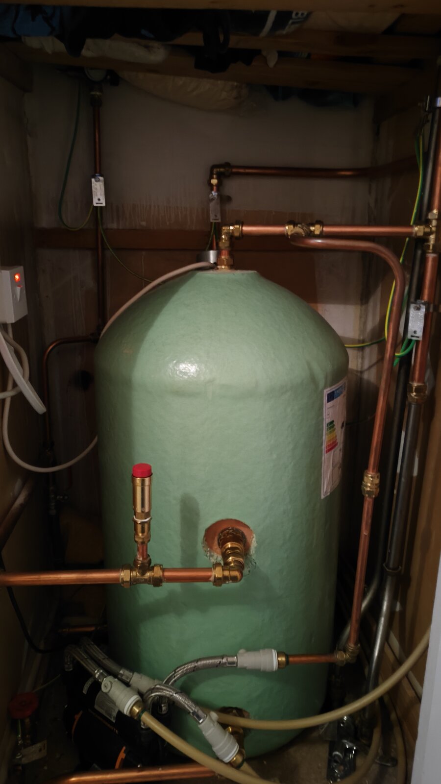

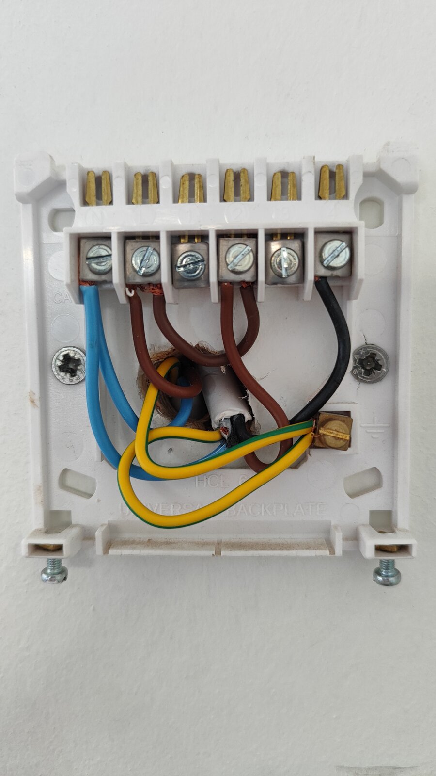

Are these adequate enough?

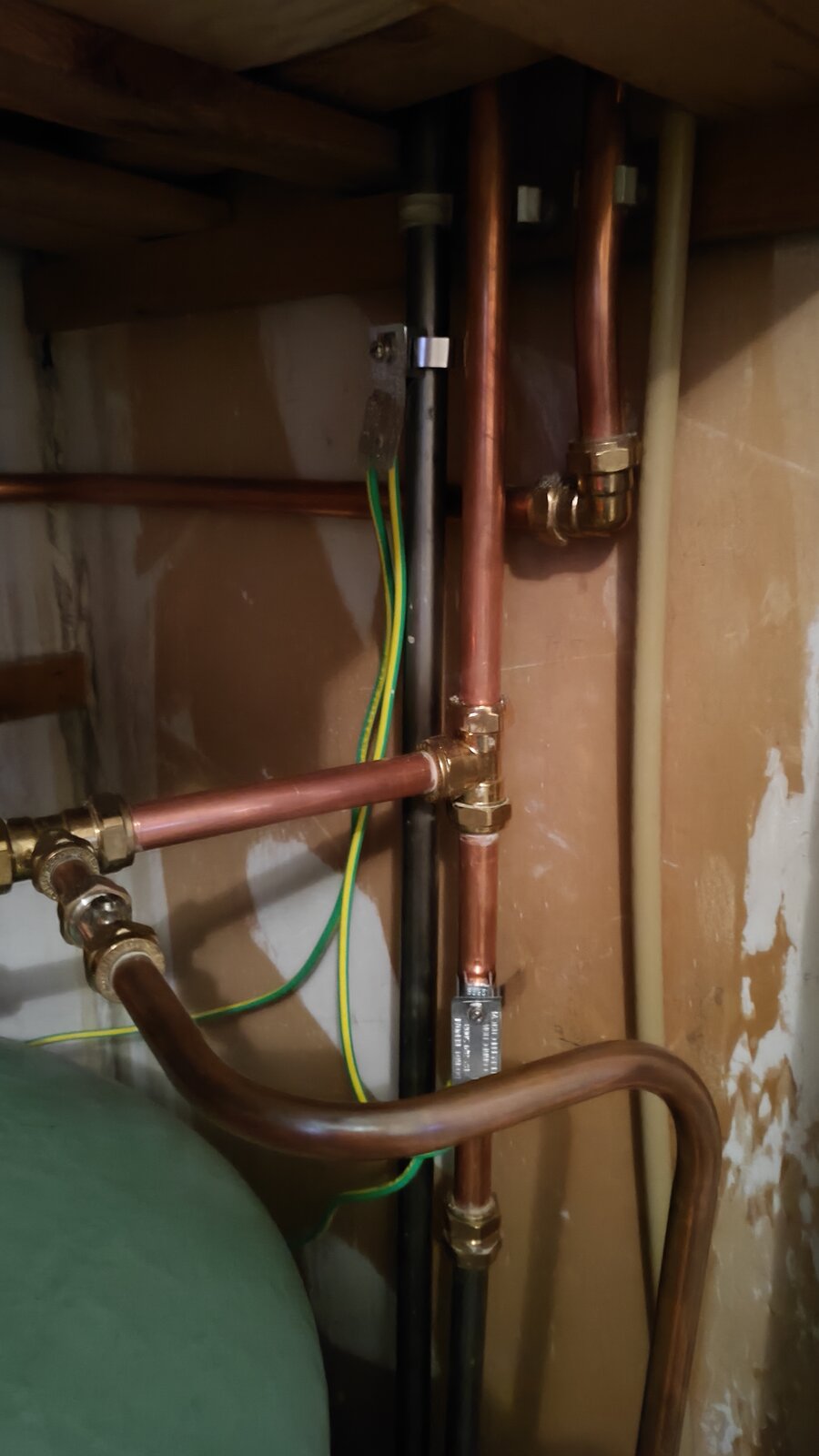

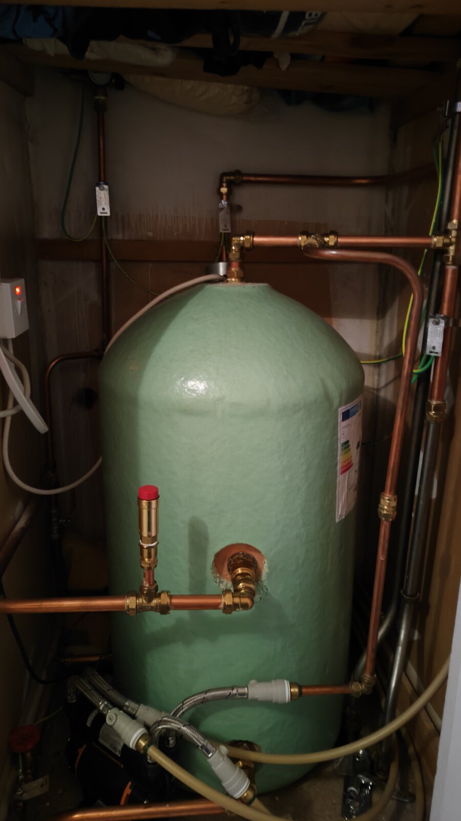

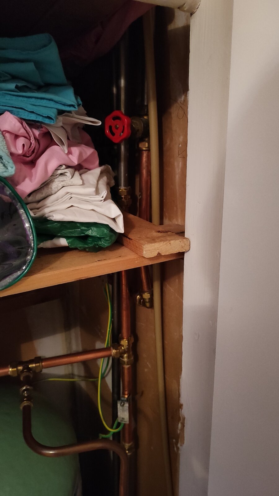

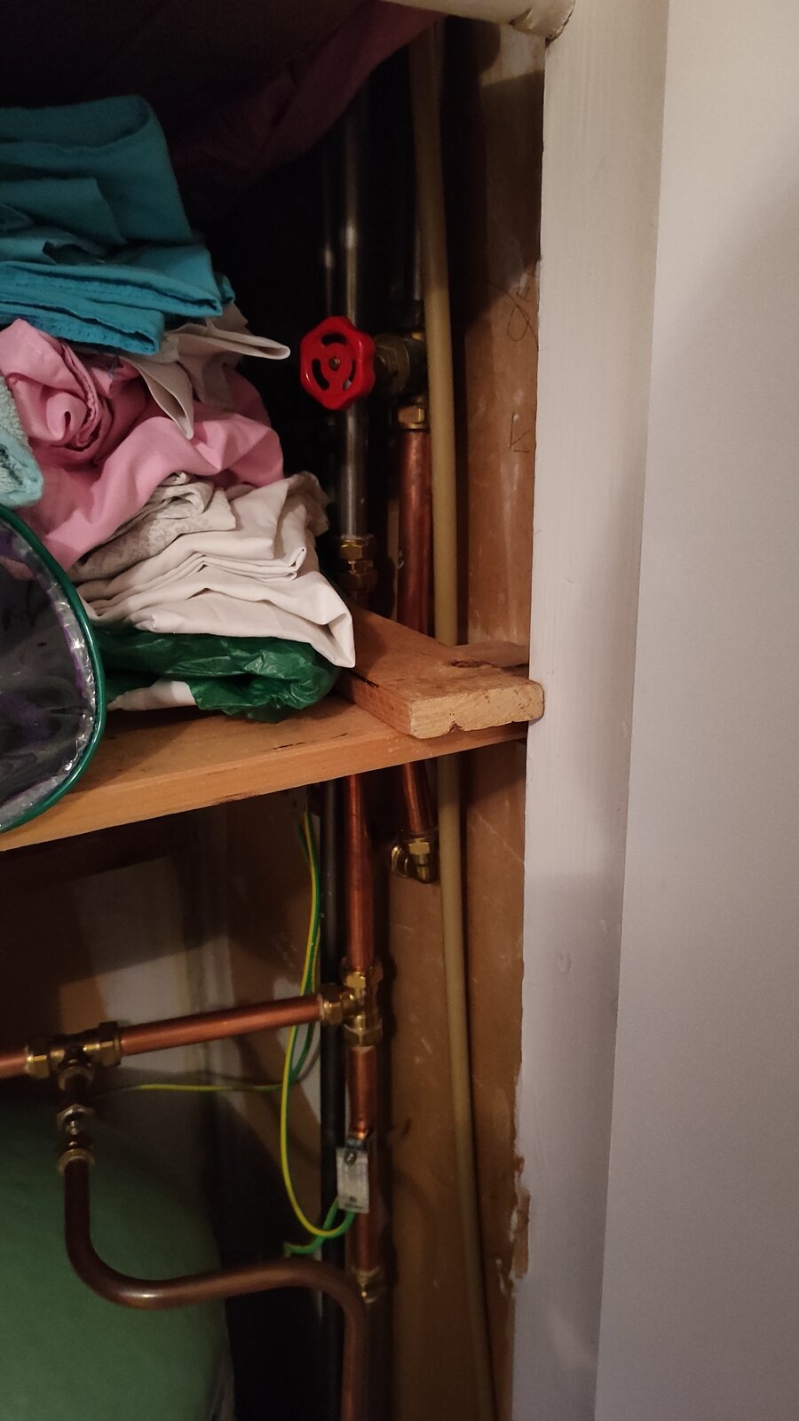

I thought this would just be a straightforward job on replacing my single channel timeswitch with the single channel hive?
From a wiring point of view that's correct. However, they are different devices with different functions:-
The timeswitch is just that, 'on' or 'off' related to time only.
Hive though, as well as providing time control, also includes a room thermostat function, so with the Hive fitted, when the room is warm, it will turn off the heating and the hot water as well. Although if you use the immersion heater (solar eddi?) for hot water, that may not be an issue for you. But just to swap the timeswitch for a Single Channel Hive controlling heating and hot water is a bit of a bodge up really.
Looking at the pictures, the pipes connected to the cylinder flow and return do appear to be 22 or 28mm which does suggest gravity circulation of hot water, but as the pump is not visible in any of the photos hard to say for certain.
If it does have gravity circulation of the hot water, then a Dual Channel Hive is required to do it properly, but it will need rewiring so that the Hot Water channel of the Hive controls the boiler and the Heating Channel controls the central heating pump. The Hive Dual Channel has a 'Gravity' setting especially for such installations.
