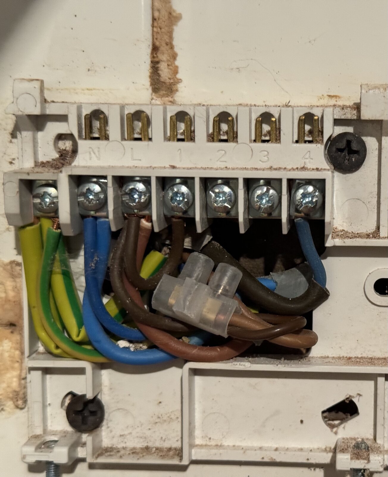

Hi all,
I became a home owner in March of this year, and after a manic rest of the year I am just starting to get around to some DIY bits and pieces.
One of the things on my to do list is replace the old Honeywell ST9100A unit with something like a Hive or Nest replacement.
From what I have read so far, the multiple wires into earth, neutral and live, I just need to make sure they all go into the corresponding terminals on the new controller, same with 1 and 4. People have suggested that 1 goes to 1 and 4 goes to 3, so that part seems straight forward enough. The thing that I am unsure of is the cable going into 1, is just bridged from live.
Is this okay and safe to do, and if I was migrating to another system, would the same solution be okay do so, or should I be considering alternative options?
Thank you for any help in advance. :)

Yes, the link/bridge is for a common supply, often, but not always needed in a new programmer setup, just read the instructions to ascertain if required. A word of warning, a blue wire has been used for a switch live, which is perfectly acceptable, however do not confuse this for a neutral wire.
Looking at installaiton isntructions online: It would seem that 1 as common and 3 for N/O would be right for a hive but...
on the nest it seems that for the heating relay: 2 is the common and 3 is the N/O. Don't need 1 as thats N/C
4/5/6 also not relevant if installing it here as they are for the DHW relay - What sort of boiler/heating system do you have?
Do you have any other control devices other than this? Presume there might be a separate wall stat somewhere?
Loop the common off the Live like it is currently
The same wall plate
can be wired different depending if one, two or three channel, the ST9100A
is a programmer rather than a thermostat, one would expect to find it used with a thermostat
and thermostat will need removing in most cases.

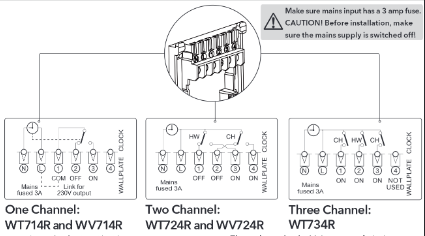

The same wall plate View attachment 322188 can be wired different depending if one, two or three channel, the ST9100A View attachment 322189 is a programmer rather than a thermostat, one would expect to find it used with a thermostat View attachment 322190and thermostat will need removing in most cases.

So if I want to move 4 to 3, this being the hearing call for heat N/O, and of course move N, L and earth, that would work? Or do I need to loop 1 from L to anything in the Nest thermostat?
The boiler is a Worcester Greenstar 4000 25kW Combi NG.
Combi Boiler - So don't need to worry bout the hot water relay.
So you have any other control devices apart from that unit you have removed, a separate wall stat anywhere because it looks like you have a cable that has a core connected to 4, and another core to that connector block?
If so, you could tidy it up by removing that, and likely even re use the cable to provide the extra low voltage supply from the heatlink to the next itself
But if you were doing a like for like swap. You'd want to put whats in 1 (the link to the Live) into 2 on the nest heatlink. And what is in 4 now goes to 3 on the nest (that blue wire with brown sleeving)
You are honestly so helpful for this, thank you so much.
I have a wall thermostat that I will be replacing with the Nest Learning Thermostat. I have not taken that off the wall yet to see what cables are a part of that, I wanted to get the Heat Link sorted first.
I think for now I would like to do a like for like swap, and then when my electrician mate comes over in a few weeks, get him to sign it off and make sure it is all correct. If at that point he decides that removing and tidy it up is the best thing to do, then we can do that then.
Thank you again, will let you know how it goes! :)
