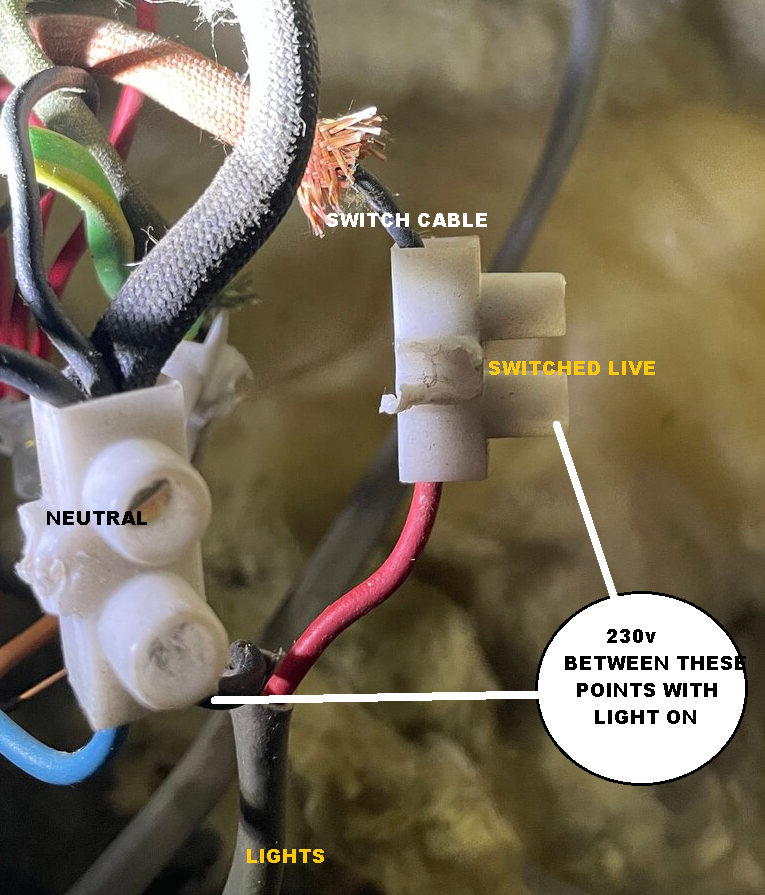

And the newish cable I thought went to my last downlight in that room but no that would have been too easy will need to have a further investigation. Can someone tell me why the black sheathed with black and the black sheathed with red signifies on 2 different cables ?
I'm beginning to wonder if I've got hold of the wrong end of the stick. Are you able to confirm that the cables I labelled in your picture [post #12] are correct ie 'lights' does go to lights and 'switch cable' does go to the switch?
What voltage do you see between 'L' & 'N' [ie the 2 connectors with the mass of reds and blacks] with the lights off and on?
Is there another junction box splitting out to the 4 lights? If so which cable goes to it?
Post 12 I get the 240v with lights on and 0v with lights off (so assumed that was the switch wire) Main bunch of lives to main bunch of neutrals 240v tested and yes to the left about 4” is another 2 connector blocks with cables which I assume went to the down lights.
238-240v lights on with wires connected by terminal block 0v with wires separated

I'm assuming the 3 fibreglass sleeves [heat resisting] are the original wiring, as mentioned in post#9 and would have been terminated in a batten holder as L,N & E, their 2 associated reds would have been joined [probably with a ceramic wire nut] above the ceiling, as now, without sleeving.
Am I correct to assume the cable I labelled 'lights' goes to these additional connectors?
Is this removing the switch and using a connector at the switch location?
If so I believe my modified sketch of post #9 is suitable.
I'm assuming the 3 fibreglass sleeves [heat resisting] are the original wiring, as mentioned in post#9 and would have been terminated in a batten holder as L,N & E, their 2 associated reds would have been joined [probably with a ceramic wire nut] above the ceiling, as now, without sleeving. Am I correct to assume the cable I labelled 'lights' goes to these additional connectors?
Yes removing switch and connecting the wires to a connector block so nothing extra fitted at the room switch gives me 240v at the connector and if I disconnect them at the connector block at the switch 0v as you asked me to test in post 12. Re the original connector blocks I seen a couple of ceramic ones lying about (couldn’t tell you if he removed these from here or not) yes I am sure the ones you labled lights goes to the lights. Many thanks if you confirm that this should be right and as I had another look at your diagram it all looks okay to me now bar the blue/brown cable that looks like a permanent live to me and not switched at all.

If you can trace where each cable goes to, and label each cable on your photographs, we could tell instantly if the joint has been wired correctly.
