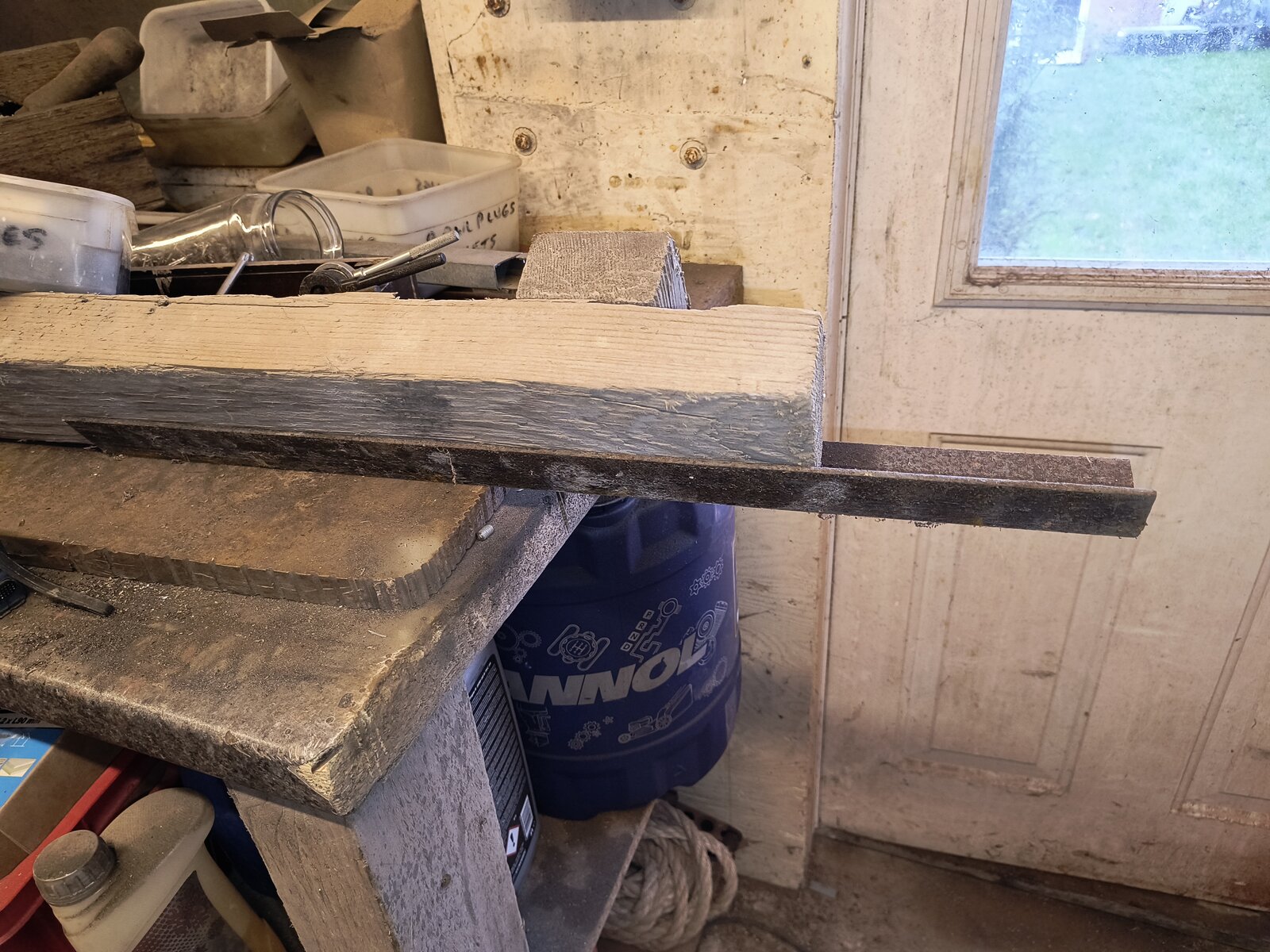

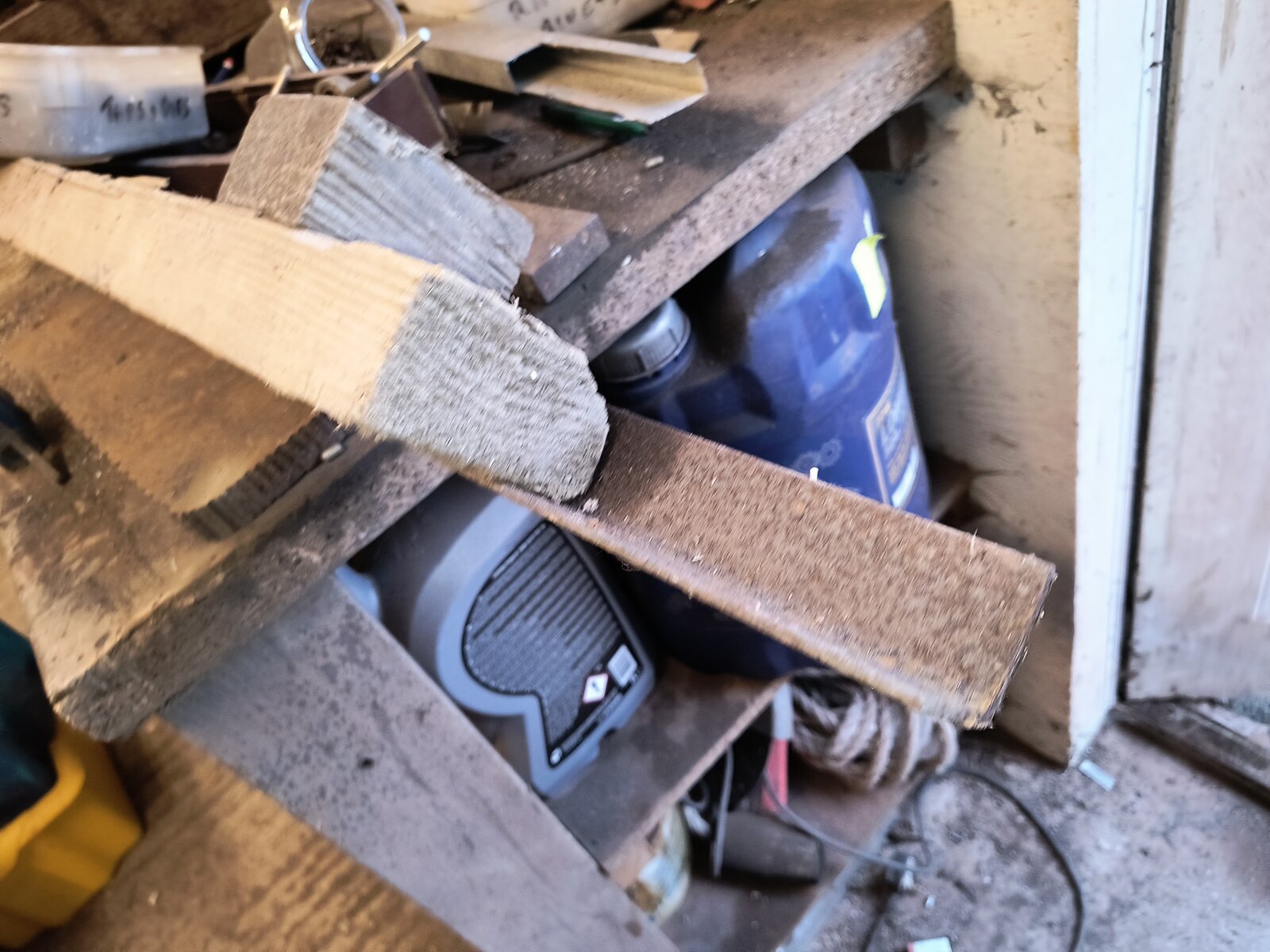

This purlin is supported like this. Any solutions to make it more secure?
A length of heavy duty angle iron (eg 100mm x 100mm x 8mm, available from any local steel stockholder) about 18" long bolted under the purlin in a "V" configuration and let into the wall in place of that brick would sort it out.
The roof tiles are now on. I’m guessing I can’t do this now?
What would be the next best step in this case?
Goes under:
But would it be harder to get under with the weight of the roof on the purlin?. I guess I would need to jack the purlin up slightly to slide the iron in. Really hoping I don’t have to get the tiles off again.

1. A double brick wall makes a big difference for making the party wall safe for any purlin work.
2. After grinding out all the pointing to, say, a 30mm depth then re-point in a 3:1 sand & cement mix.
3. Then carefully open up pockets in the brickwork - "holes" or pockets one brick approx 4" deep.
4. Then use bolt-ons. See how rot damaged short ground floor joists are extended into wall pockets.
5. Use one length of timber to extend the purlin, and sister bolt-on timbers either side of the purlin & the extension piece. All three bolt-on pieces then sit in the hole or pocket.
6. Once in the pocket you can, if needed, wedge up the purlin to meet the rafters.
7. During this work the other end of the purlin should be firmly fixed on the other party wall - why not post a pic of the other end of the purlin?

It's not that difficult to prop retrospectively, more of a faff. You could prop the ceiling below, with a squat board and a pair of Acrows. Then drop another squat board onto the propped ceiling and use a short Acrow to prop the purlin end.

And whilst all these pockets are being formed and destabilising the current support brick (which looks like it could shear or fail in tension at any moment) what happens to the existing purlin?
Acros, and a few timbers would do that...
Add a series of Acros from the ground up, with planks top and bottom of each, at each floor, all the up to under that purlin. The final one at the top, would jack the purlin up, enough to allow you to chop the wall out, to accept that angle iron. You could stitch drill the hole for the iron, and no need to disturb the tiles.
You might need to have made some sort of V bracket base, for the purlin to sit firmly on top of the acro.
I would also suggest, something be done to support it, as a matter of extreme urgency - that single brick could shatter under the load, at any moment.
